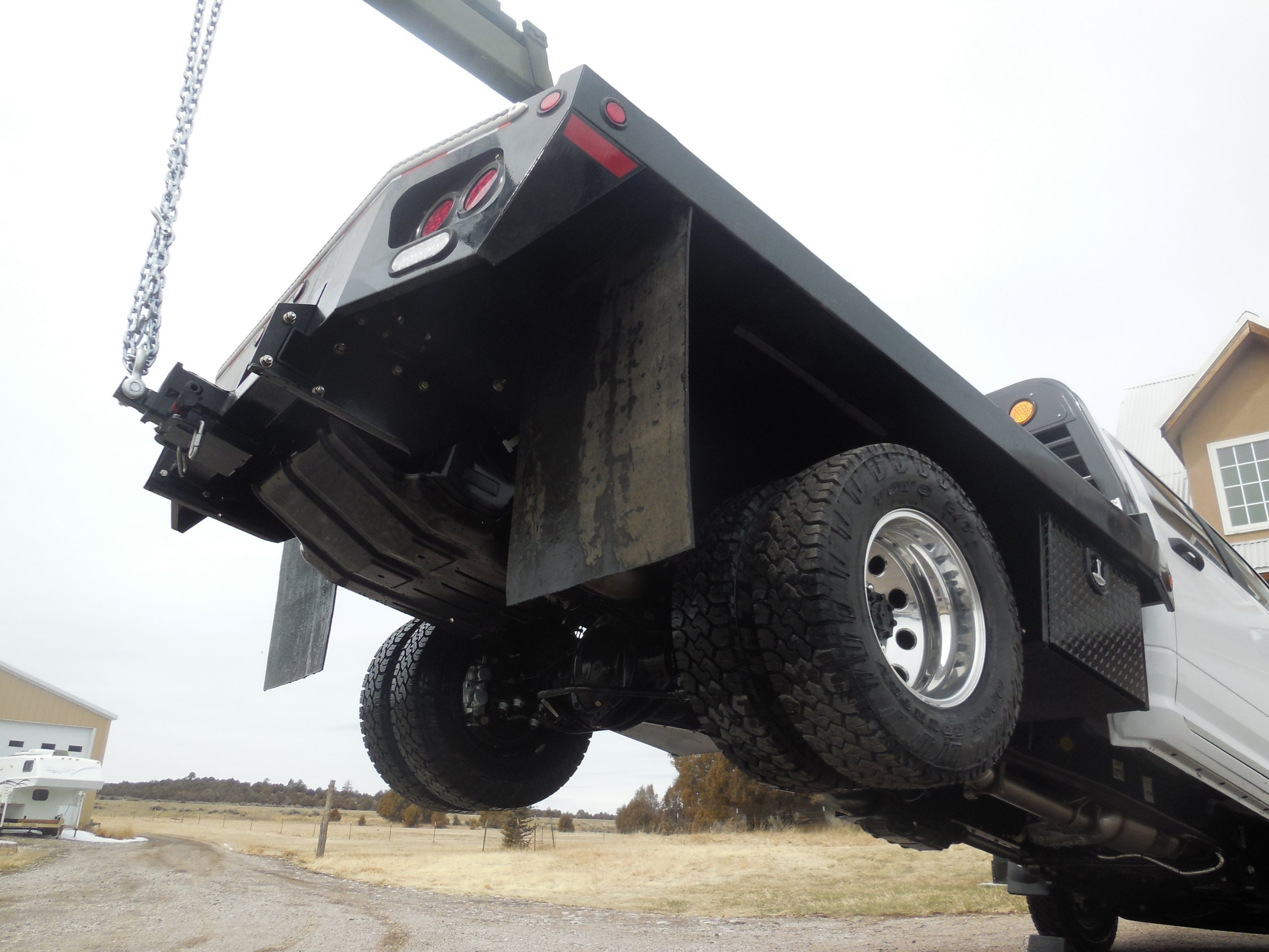

Honestly I also dont want to lift the tires very high so the jack and a stand allow me to keep the tires about 2" off the ground so there is not a lot of lifting.
Oh, c'mon. With the lugnuts at eye level it's so easy to see them.
Alright, this was not for tire changing or service, but to wash Colorado's finest magnesium chloride off of the chassis. Using only the little 8K crane.
Would I want to leave the vehicle like this for extended periods? Of course not. But it probably wouldn't be any harder on it than sitting on a 2-post.

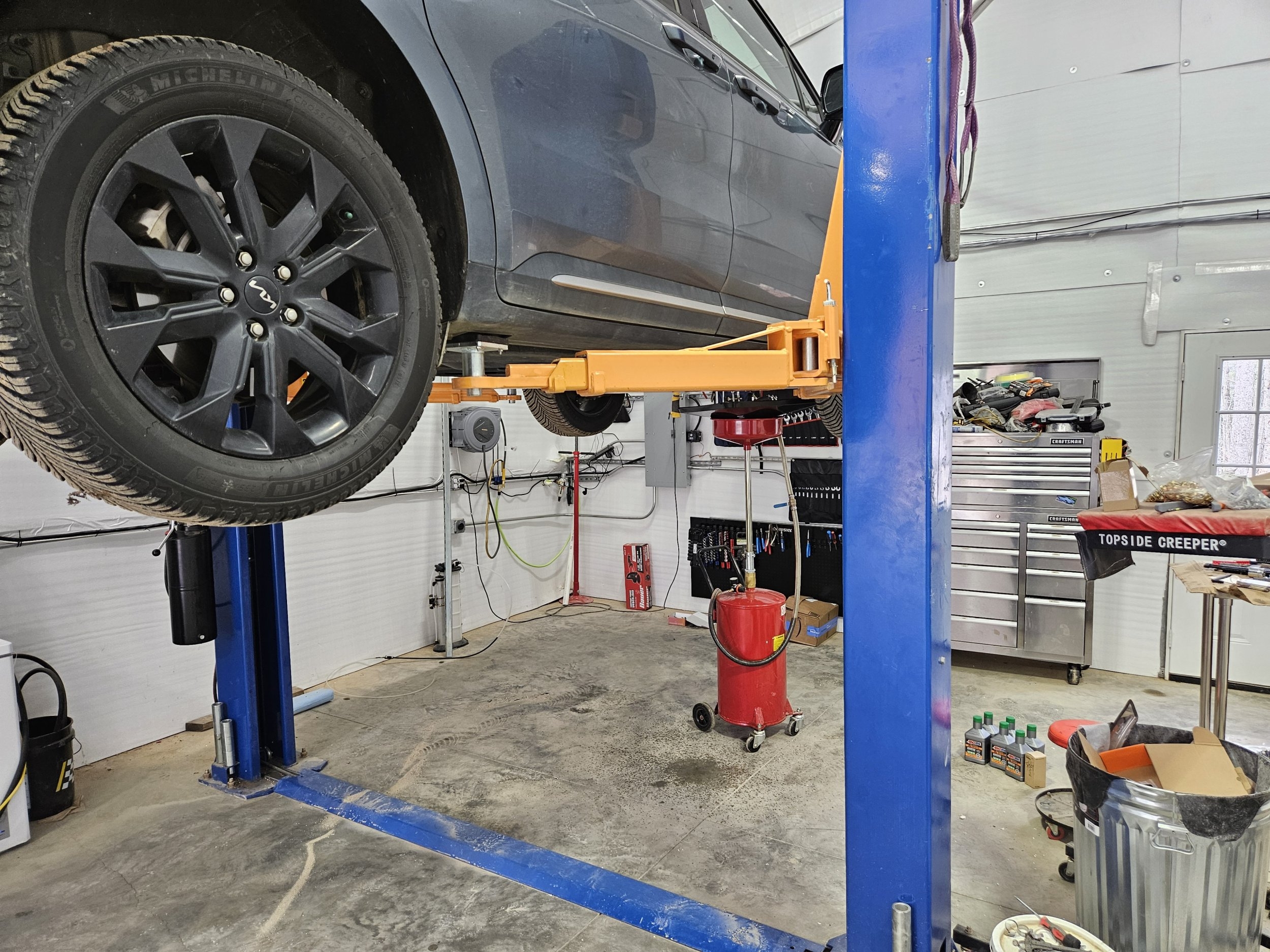

I have an 11k 2 post asymmetric lift that I use all the time. I bought mine off Amazon (risky but has worked out). It's a Triumph and I paid 2700. I have a 30x50 shop. I mainly do vehicle maintenance, so brakes, tires, oil changes... a four post lift would not have suited my needs. I've lifted everything from a golf cart (quite difficult to get it positioned with the pads under the frame rails) to my f350 and a skid steer. I chose an open top, which came in handy with the skid steer, and allows me to use all tge 16 foot building height, though the floor cables are a not of a pain they have not precluded any with I needed to do. I planned the garage with the lift in mind (the concrete specs matter). For my lift, 4000 psi concrete 6 inches thick was sufficient. We dug a continuous footer then poured the entire floor 6 inches thick 4000 psi fiber reinforced pump mix (because of building location, hard to get a mixer backed up to it). I had the electrician run a 30 amp drop to it. I installed the lift on a Sunday afternoon. The instructions were nonexistent, but it was straightforward enough that I figured it out. I installed the lift in a straight line to the door close enough to the back wall that I can reach my wall mounted tools to work under the hood.
It worked for me and I would do it again.
