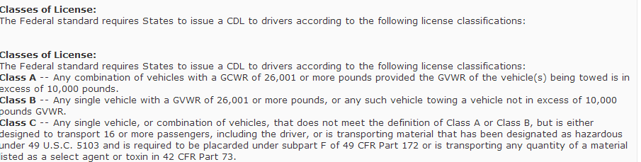

   / 2013 dodge 3500 HD trailer towing uprated to 30,000lbs #116
Commercial Driver's License Program (CDL/CDLIS) - Federal Motor Carrier Safety Administration short.PNG
   / 2013 dodge 3500 HD trailer towing uprated to 30,000lbs #117
The Federal standard requires States to issue a CDL to drivers according to the following license classifications:
Class A -- Any combination of vehicles with a GCWR of 26,001 or more pounds provided the GVWR of the vehicle(s) being towed is in excess of 10,000 pounds.
Class B -- Any single vehicle with a GVWR of 26,001 or more pounds, or any such vehicle towing a vehicle not in excess of 10,000 pounds GVWR.
As Duffster pointed out a straight truck of exactly 26K towing a trailer of exactly 10K would not require a CDL
