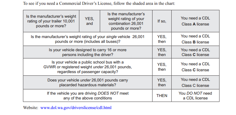

It's not that hard if you read the matrix chart correctly. We are discussing a non-CDL straight truck with a GVW of 26K towing a trailer of 10K. Your attachment above would not be applicable.
I am reading it correctly. Now when you combine a non CDL truck with 26k rating and a non CDL trailer with 10k tow rating..that puts your Gross Combined Vehicle Weight Rating @ 36,000 which is clearly over the 26,001 GCVWR lbs CDL requirement. Just because the individual unit does not require a CDL, does not mean when you put them together a CDL is not required, does not work that way.
I will try not post anymore on this.

I'm sure you think you're reading the chart correctly, but you most assuredly are not
   / 2013 dodge 3500 HD trailer towing uprated to 30,000lbs #73
This topic has been beat to death a thousand times on the internet. You can't just highlight part of a sentence and stop at the comma. Read it like this:
all trailers with a manufacturerエs weight rating of 10,001 pounds or more, AND a combined vehicles gross weight rating of 26,001 pounds or more.
Both things need to be true to require a CDL. I'm with aczlan on this one.
EDIT: Take a look here http://www.dmv.ny.gov/forms/mv500c.pdf
These are the NY driver's license classes and NY is about as strict as anywhere except CA. Class D is the regular license for passenger cars.
It allows you to drive up to 26K trucks and tow trailers up to 10K behind such trucks. Only when the trailer is over 10K are you limited to 26K total.
Also, if you look at what a Class A is needed for it only kicks in when the trailer is over 10K

Why would that change the minds of people who can't follow an elementary flow chart?

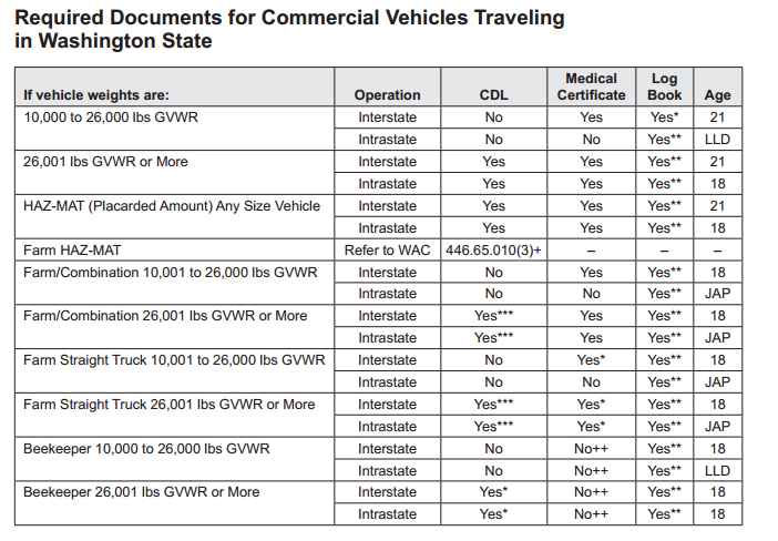

Rock, another interesting read. This one has alot of cool info but what pertains to our discussion is in Chapter 8 towards the bottom if you scroll down
http://www.wsdot.wa.gov/NR/rdonlyres/EE2D33C7-E6A0-4C58-9BD9-AE05C003B327/0/VehicleGuide.pdf
I definitely agree, its hard to change the minds of people that cant follow the flow chart, especially when it clearly states the manufacturers rating of your combination is 26,001 lbs or more, a class A CDL is required.
