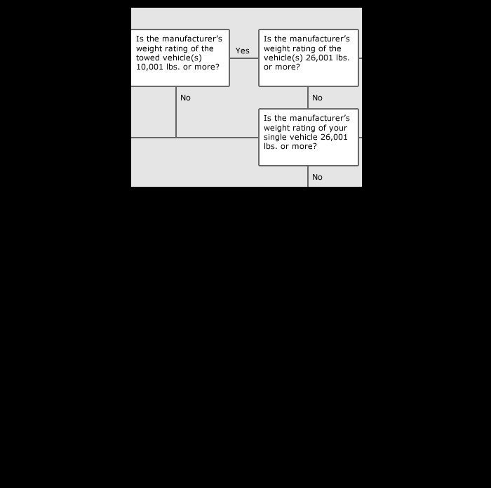

Per the flowchart on the Washington State site, as long as your tow vehicle is rated for less than 26k, doesn't carry hazmat materials, isn't a schoolbus and doesn't hold 16+ people you can legally tow it without a CDL.

You will find I am correct on this.
This right here nails it read vehicle(s) as in more than 1 vehicle that gross's over 26,001 lbs.

   / 2013 dodge 3500 HD trailer towing uprated to 30,000lbs #64
Yes gross weight not gross combined, if the truck is 26000 and the trailer is 10000 you should not need a CDL. Now if the truck is 20000 and the trailer is 12000. That would need a CDL, the gross combine is over 26001 and the trailer is over 10001. Both parts need to be true, not either or.
I looked into this several years ago because I had a truck that was 25900 gross and as long as my trailer was not rated greater than 100001 I was OK. Now because my trailer was rated at more than that, I did need one had I not put farm plates on the truck.
Like I said you will find I am correct on this.
Those regulations clearly state:
truck 26,001 lbs GVWR= CDL
Trailer over 10,001 GVWR= CDL
Truck/Trailer GCVWR over 26,001 lbs= CDL
These regulations specifically list the weight requirements for each vehicle to reach CDL requirements and then the combination weight that requires a CDL. Once you go over the 26,001 weight with truck/trailer GCWR its CDL time period.
Now logically why would any state require a CDL for a truck with a GVWR of 26,001 lbs BUT say hey take a 26,000 lb GVWR truck and 10,000 lb GVWR trailer, hook them up together and you can have GCVWR 36,000 lbs and drive with no CDL. Because they dont, its clearly stated as 26,001 lbs GCVWR
Think not
It's not that hard if you read the matrix chart correctly. We are discussing a non-CDL straight truck with a GVW of 26K towing a trailer of 10K. Your attachment above would not be applicable.
