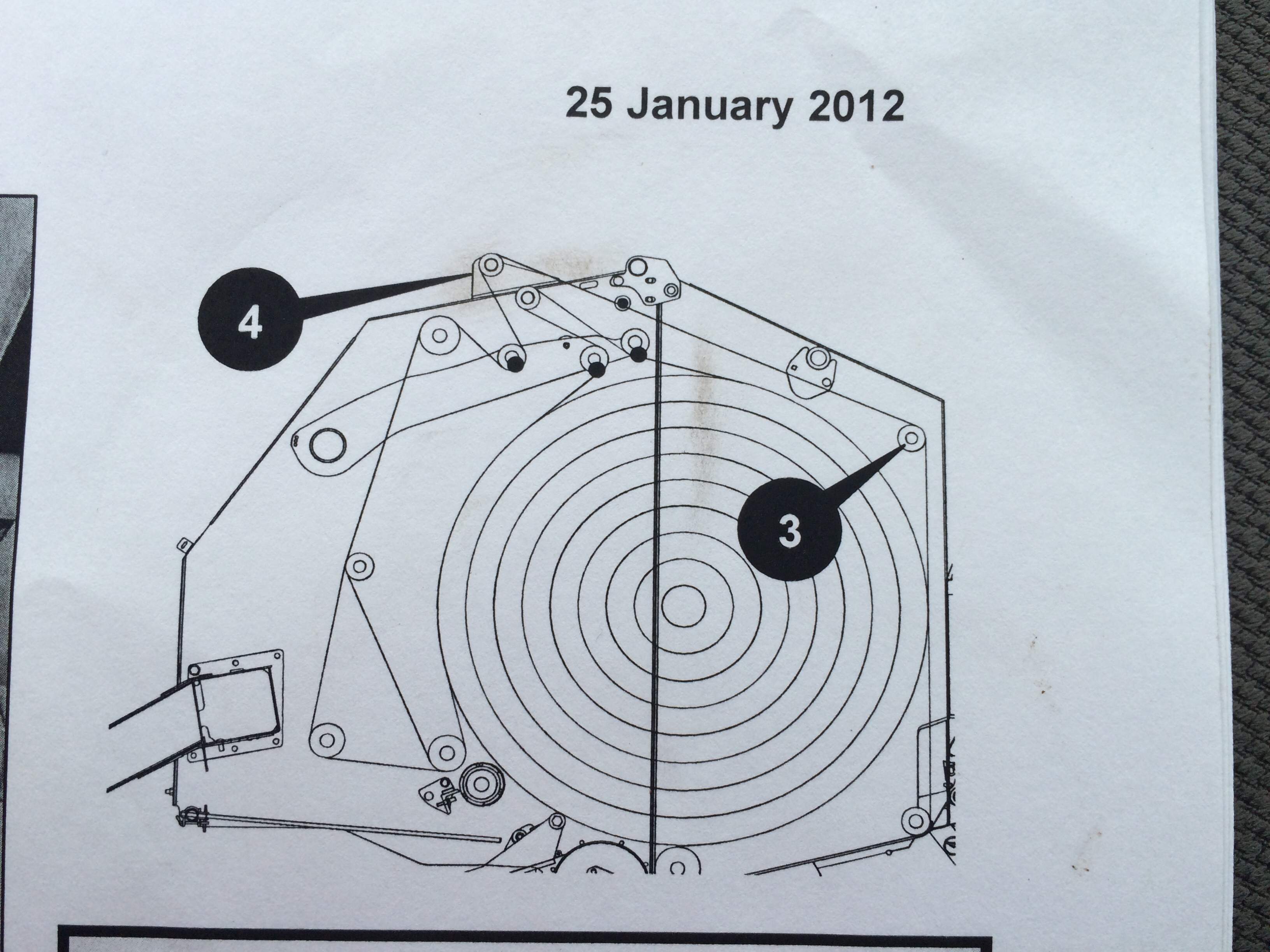

Thanks foreman, yeah I believe my baler completely stops at full open too, during the process it rubs that top guide while rotating so I assume that might be why its wearing the belts a little faster than normal.
There are two adjustable rollers the one on very top and one on top the back gate.
   / 2015 Hay Season #295
Thanks I'll check it out.
   / 2015 Hay Season
#296
Put the bracket on cylinder slack belts if going to adjust either one,#4 just have to loosen bolt and push or pull it either way need too another wrench can get some leverage hold roller in place while you tighten bolt back up,#3 best if have some rope and weed it threw and under roller so you can pull roller up or let it down some. Both can be adjusted by yourself but nice have someone else around to at least snug bolt up when you have it sent where you won't it. Removing roller to replace bearings I can also tell you what not to DO and the quick easy painless way lol.
   / 2015 Hay Season #297
Thanks for the info, I'll get my brother to help me adjust them. If I have a bearing go out on the roller I'll definitely jump on here and get your take on it. I had to replace one bearing in the center (triple sprocket with the short chain) already. It wasn't too hard but I was annoyed to have to replace a bearing with under 1500 bales on the clock. I believe two bearings have already been replaced it the balers short working life.
