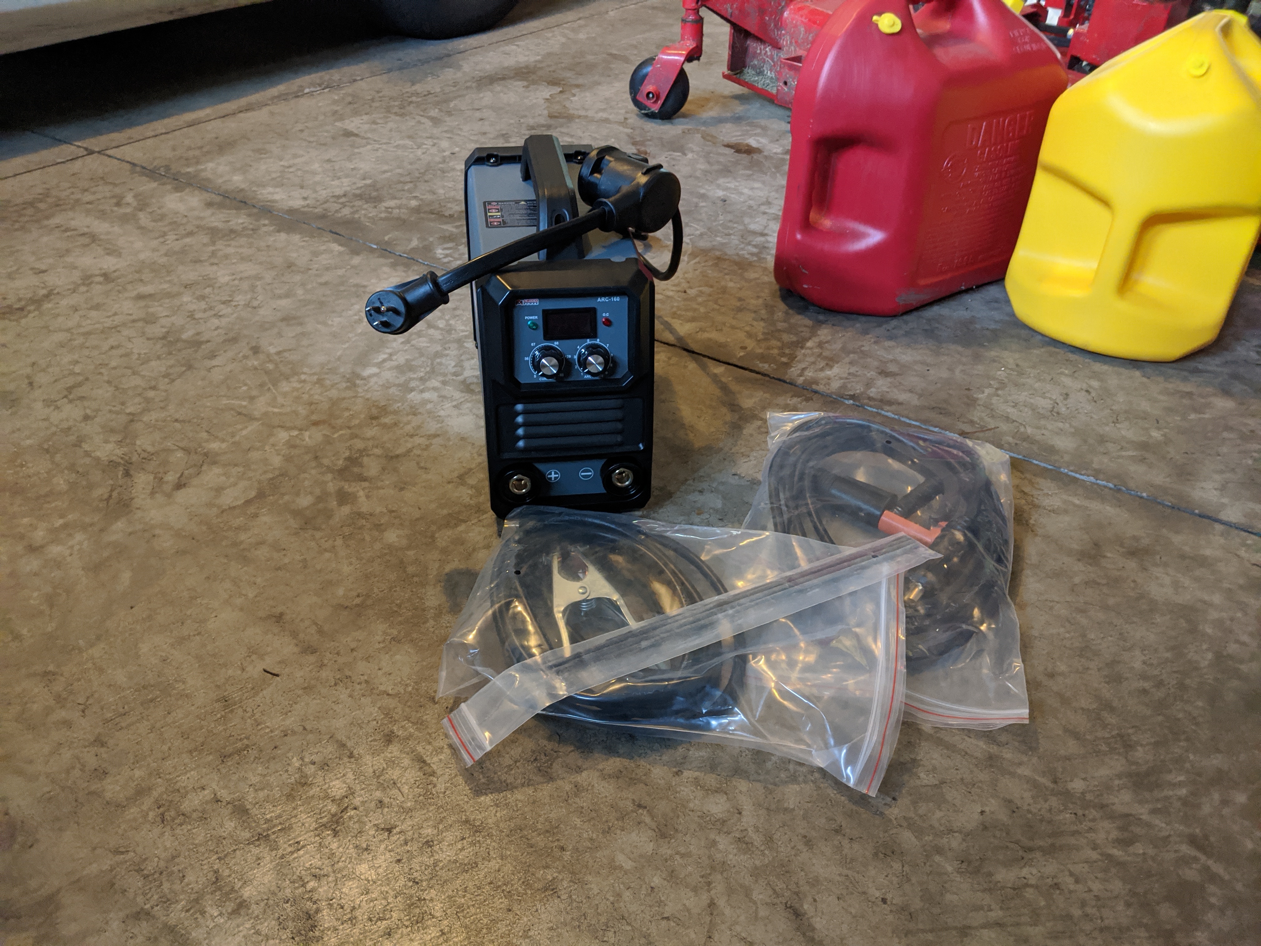

Oh boy oh boy, presents waiting for me when I got home! :cool2:
Came with a few "J422" welding rods. What that is?

J422 Carbon steel welding rod 1KG diameter 2. 2.5 3.2 4. welding electrode AC DC|welding electrodes|rod weldwelding rod - AliExpress
apparently a Chinese low carbon rod. with a designation of E4303. I have never seen a welding rod with the first two digits so low. The first two digits are the tensile strength of the rod. For instance E7018 means Electrode 70 has as tensile strength of 70,000 lbs Mild steel or A36 is a 36,000 lb tensile strength. This is "garden variety" of ordinary steel, no hardened in any way, just old hot rolled steel. Even the very common E6011 rod has a tensile strength of 60,000 lbs.
welding electrode J422, welding electrode E433
By the way I am a big fan of the E7018 rod. It is a little harder to run than some of the others, and you must knock the "corn" off of the tip of the rod after the first strike to restrike the rod. I do it with a gloved thumb, others have their preferred methods. BUT the strength of the rod is great and welds are very strong, and the bead can be very pretty. For a filling type of rod like patching holes I prefer the easy running E7014, which some people will call "monkey rod" or "idiot rod", because they are so easy to strike and run. I have seen videos of guys striking a 7014 and letting it run itself from the arc force across a plate. They are easy to run and fill well due to the iron powder in the flux. E6013 rod was developed decades ago as a "sheet metal" rod before the advent of the MIG process. In small rod sizes you can do a fair job of welding thin sheet metal with these rods with low heat settings and thin rods.

K0ua, thanks for those links! That electrode id page is great as well, I printed it out.
About the 7018, do you just buy enough to use up or do you store them in an oven or special container? I don't have any stick welder experience yet other than playing around with my neighbor's buddy's welder he brought over a couple times. Right now I just need to learn on this welder, so I was researching easiest rods to learn with. 7014 was one I read about, and somebody was also writing about 6013.
I got a few project I have planned before winter, is just going to be mild steel, 5/16 and under, or even maybe 1/4 and under.
