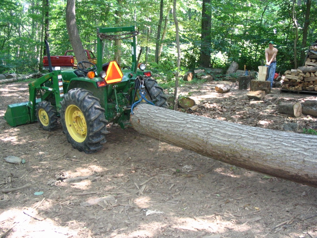

Here's my splitter setup.
Note the "Power Beyond"-(19 year old #1 son w/splitting maul). LOL!
   / 2305 or similar sized and the northern tool 3pt 13 ton log splitter #34
Hey Tunguska, I had one like that a couple of years ago.:D I still say the hydraulic one is cheaper.;)
