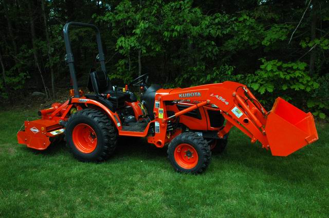

FYI I had a little trouble finding the tiller I wanted. Seems most manufactures (at least Woods and Kuhn) have stopped making heavy duty tillers 50 or 52 inches.
For example. You can no longer get a Woods GT52 tiller. There general purpose tiller. They make what they call an estate series which is a lighter unit and has a aluminum gear box housing. You have to buy a 60" tiller to get the heavier duty unit.
I ended up getting a new leftover Kuhn EL32-130 50"
