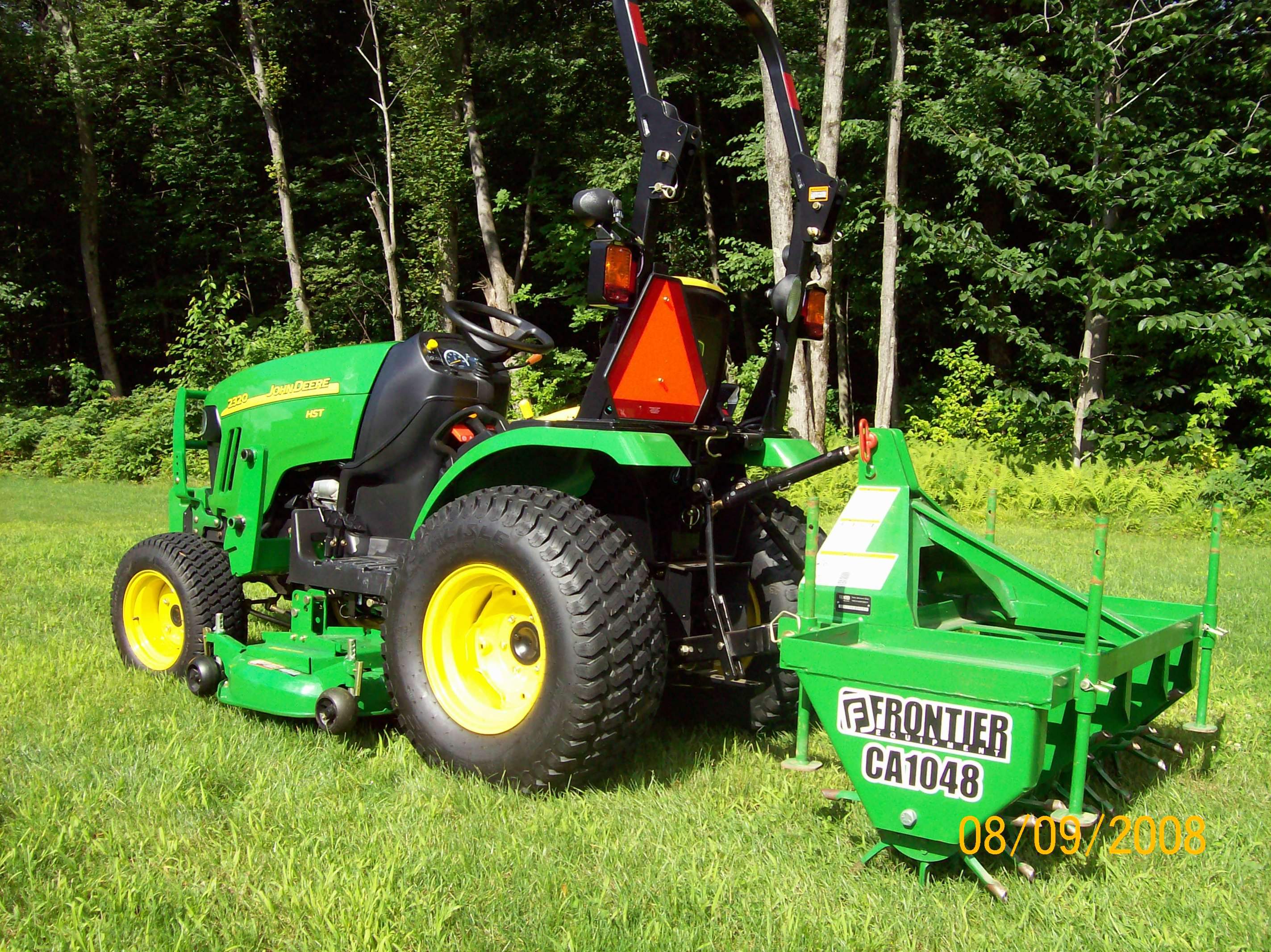

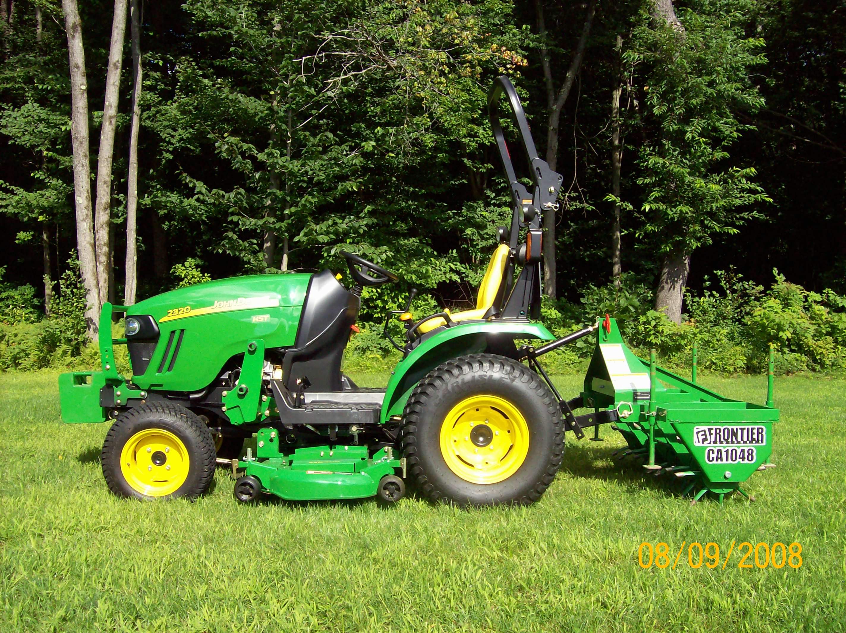

Sorry to jump in on this post with more 2320 questions but I see many good 2320 owners have been giving advice here.
I've been considering a 2320 but really want a 72" RFM (probably the Landpride FDR1672 which weighs about 100lbs less than the Frontier
GM1072R) and 3 pt Frontier CA1048 core aerator and am doubting the 2320's ability to handle both. I have slight inclines over my 3 acres. Core aerators pull very hard even up slight inclines in heavy clay soil--My current JD LT190 really struggles up slight grades with my JD 40" pull behind aerator that doesn't have very many or very deep tines. Also, the JD website doesn't even suggest the 2320 for aerators. Wondering if a 2520 or even 2720 would be better--especially for the aerator, but hate to spend the extra $$? Also, for a tiller it would have to be wider than 52" to cover the tracks of the 2320 and again wonder on PTO hp in the clay soil.

Hello JeffinNE,
I know we spoke once before about the JD2320 and the CA1048 core aerator. My lawn is relatively flat with a few slight grades and I do not have any problems pulling the aerator with 420 pounds of extra weight added. With that being said though, I do try to aerate when the lawn is damp and yes on those slight slopes I do put it in 4X4. This is really just to prevent the unloaded turf tires from spinning. In the attached pictures you will see the JD2320 with the CA1048. These pictures are not of me using the aerator but just moving it. When I am using it I have the loader on as a counterweight and the suitcase weights are used to weigh down the aerator.
