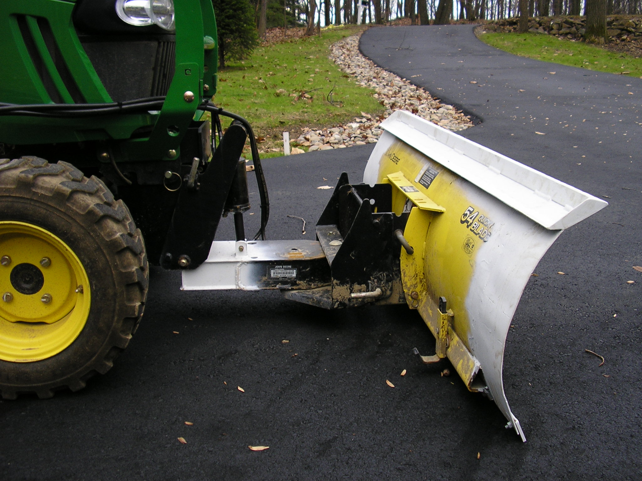

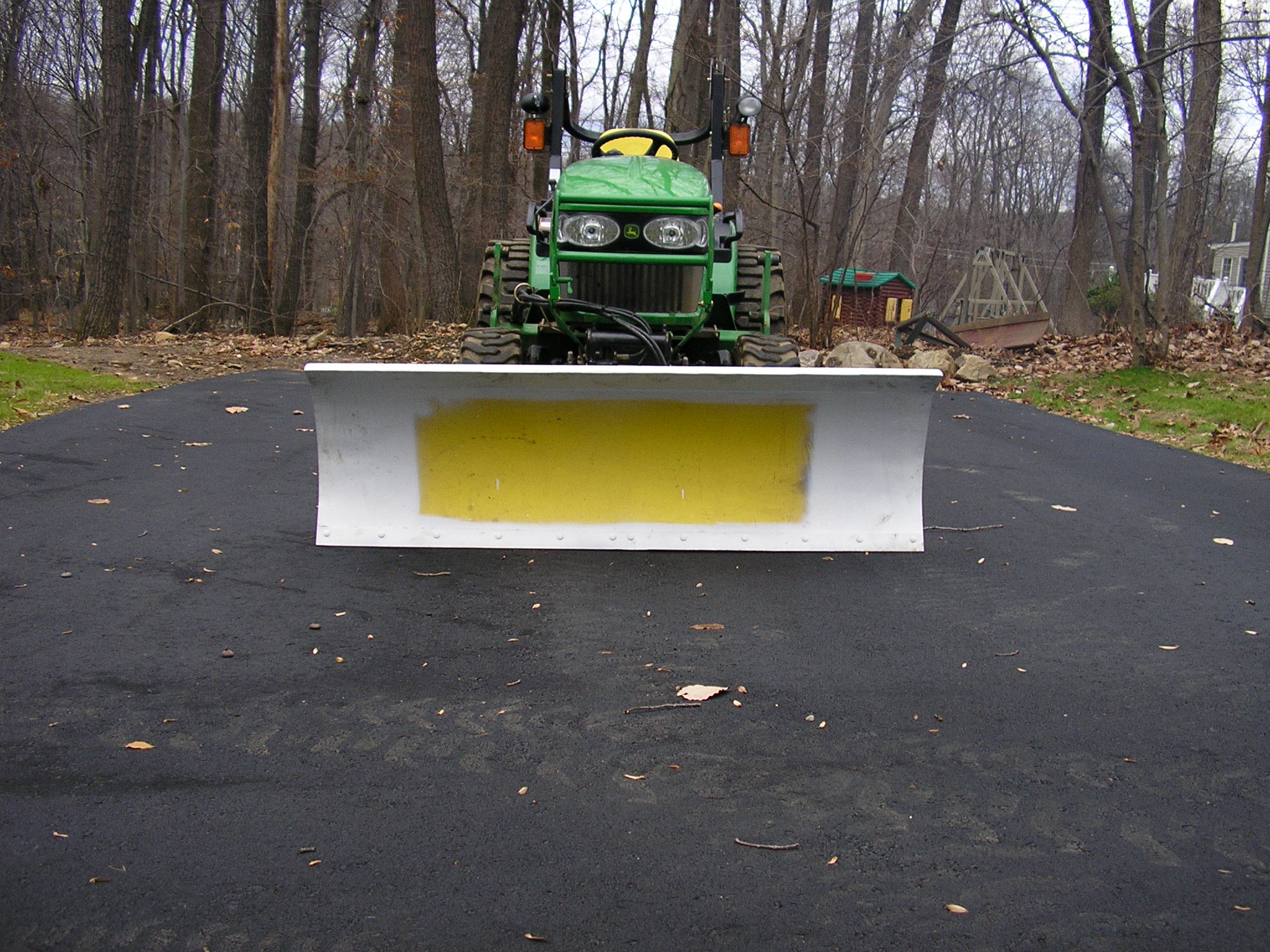

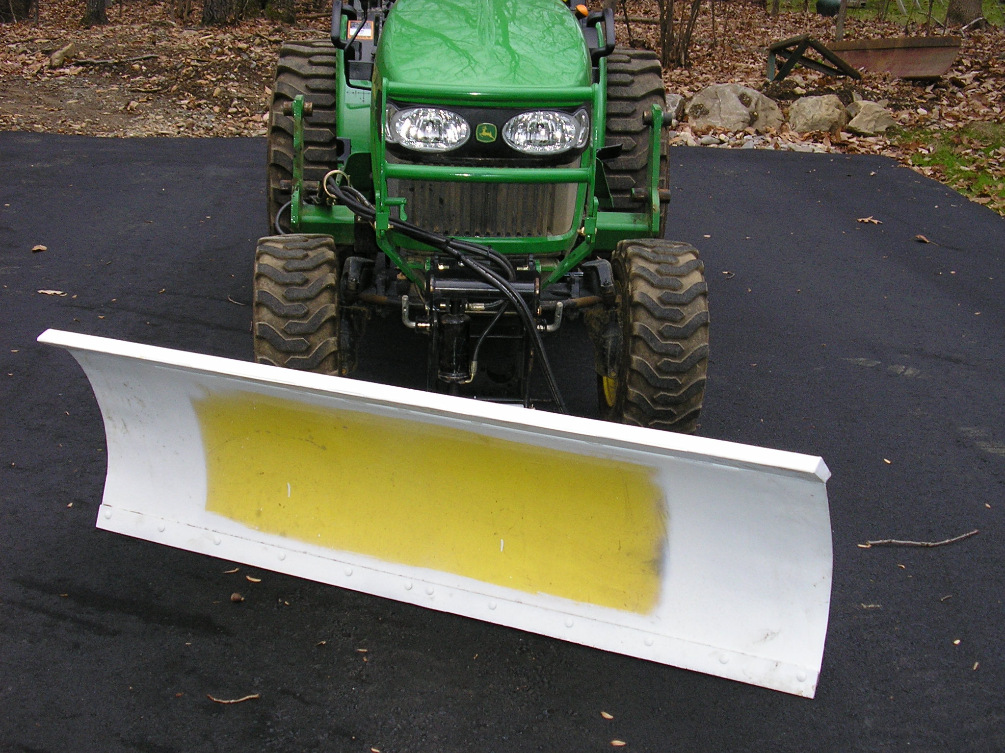

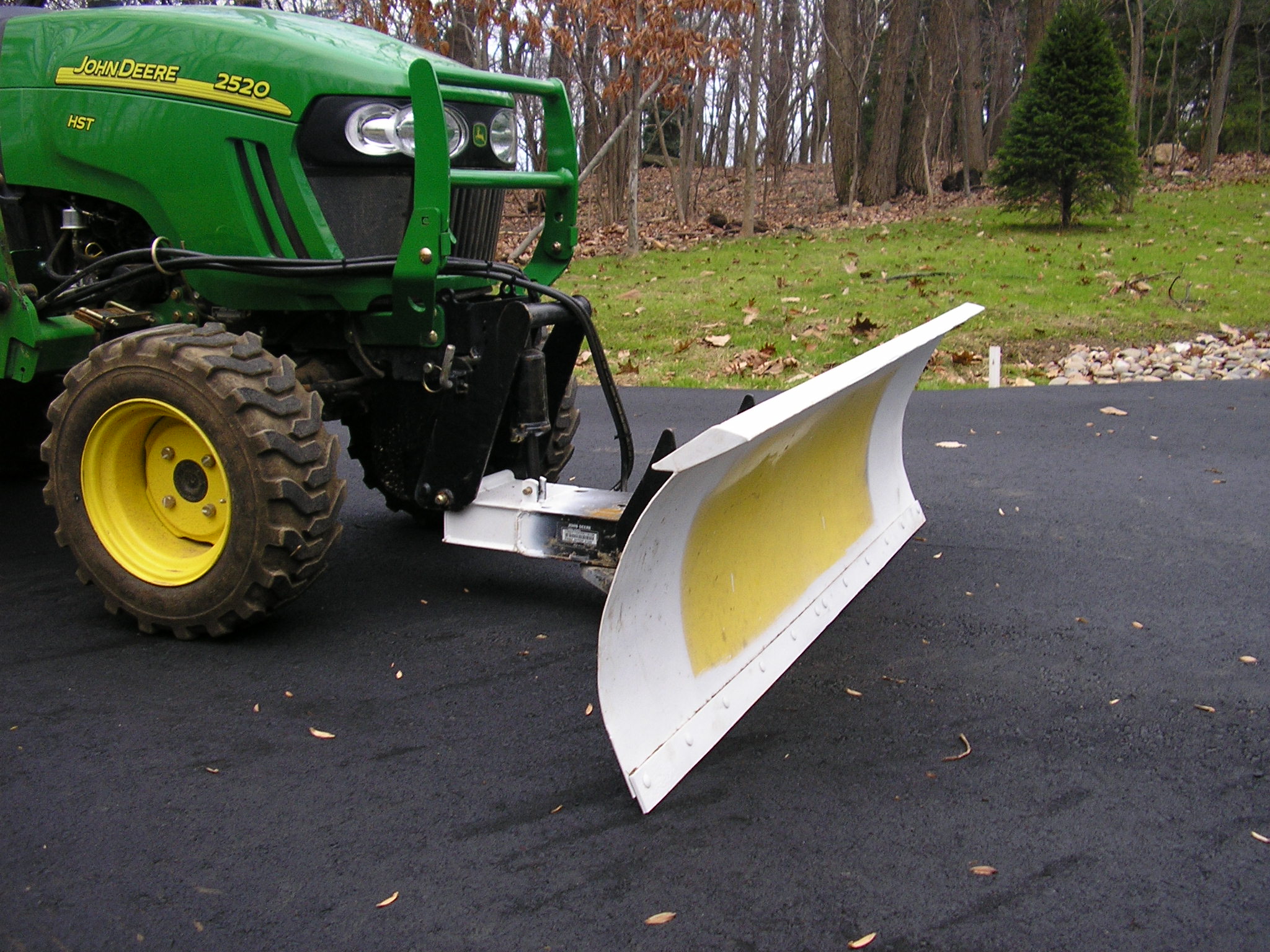

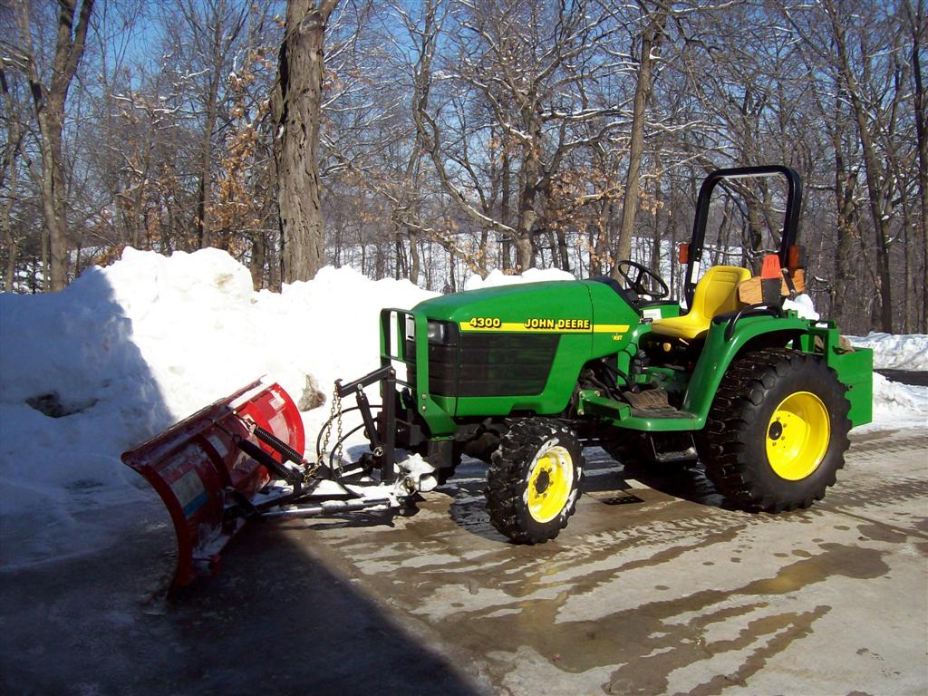

I bought a used 54" set-up for my 2520 back in 2008. After plowing with it for the 2008-2009 season, I decided to have a local welder widen the plow to 5.5', increase the plow height another 4 inches and push the A-frame out a few inches. For a few hundred bucks, it did the trick, however this year I'm cutting down a 7' Meyer plow to either 6.5' or 6' and building my own lift frame similiar to Beenthere's set-up.

That looks perfect. So did you have to lengthen the JD Quick hitch because of the extra length blade when angling it? I'm assuming it would hit the tires and not angle real far.
Does it push that 5.5 plow easily, or was it a struggle in like 8 inch snowfalls?
Did you use chains, and does the plow push the tractor sideways when you angle it?
Sorry for all the questions, but that looks pretty close to what i was thinking of doing!
   / 2520 Snowplow size? #46
I added to the A-frame because I thought the blade might hit the tires when angled all the way to the right or left and/or the outer tip of the cutting might drag along the ground when the blade was in the raised position and angled to the right or left, but I found out after the fact that it probably wouldn't have been an issue.
Yes, it pushes the plow with ease, even uphill with a full load of snow. I pushed a lot of snow last year and never had a traction problem and my driveway is pretty steep.
No, I never needed chains and the only time the plow pushed the tractor sides was during a big storm that dumped almost a foot of snow in one event. I was at work during the storm and had to start plowing all 12 inches.

Here's an older posting I started when I had my 2320 and 84" plow blade:
http://www.tractorbynet.com/forums/john-deere-owning-operating/131881-2320-cab-plow.html
To answer what you're probably thinking: yes, the 2320 handled the 84" blade without any problem whatsoever. But, I was plowing level ground, including my road - with the only exception being my driveway, which is a slight grade uphill. Always ran it in low range. Also, had serious chains, as you can see in the picture.
The cab was perfect for my application - condensation never froze on the inside, I suspect because the tractor was stored outside.
I really like rtm038's solution, especially if you can't find an inexpensive blade locally. I would certainly suggest adding a couple of upgrades while it's at the welder's shop: (1) a pair of "real" skid shoes - preferably the ones that adjust, available from any plow manufacturer and (2) posts on the top corners to allow attachment of fiberglass markers. It's amazing how you can lose sight of the ends of the plow in deep snow, especially at night.

^^^^That looks perfect.
Is the JD quick hitch holding up ok?
