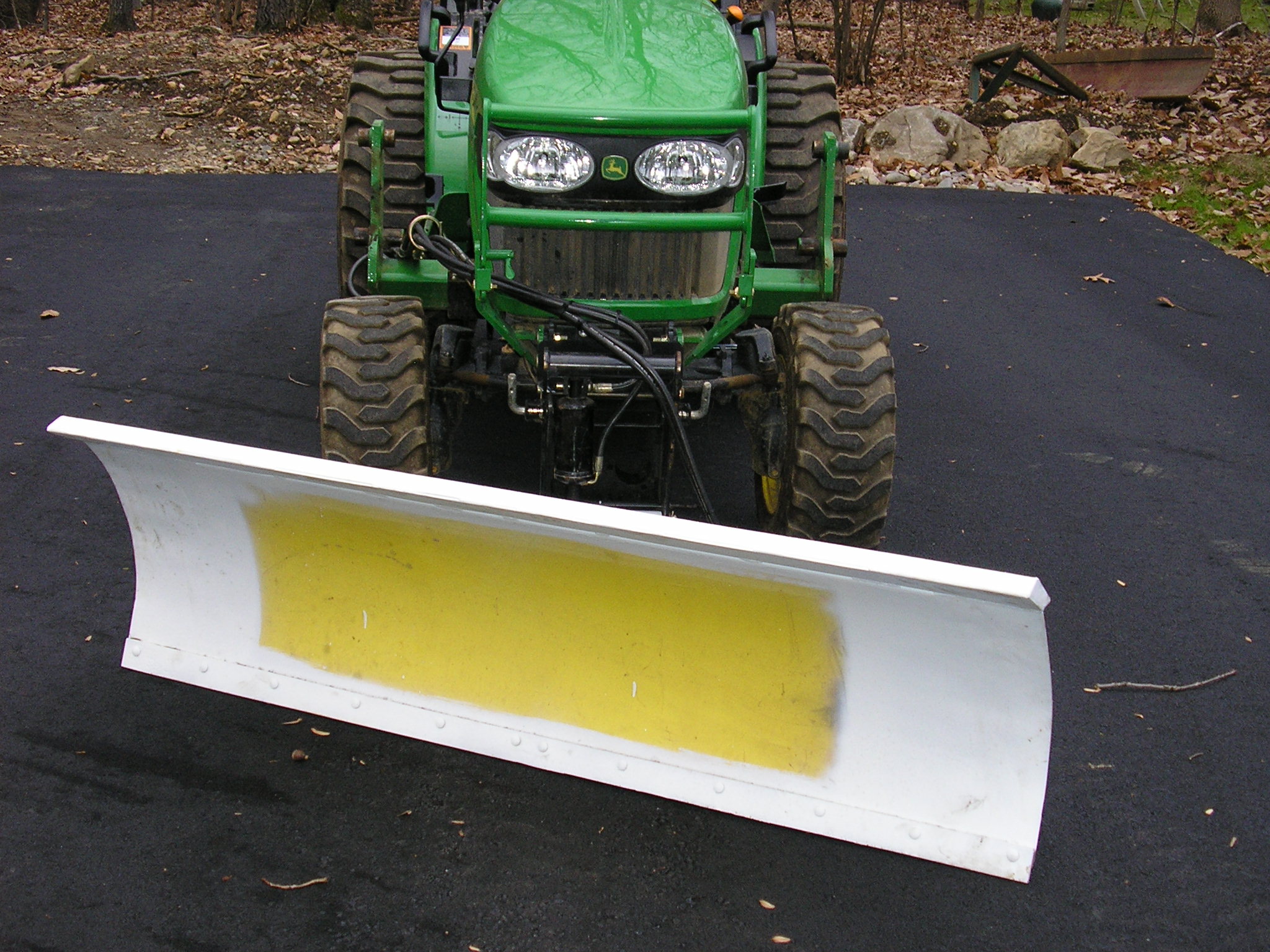

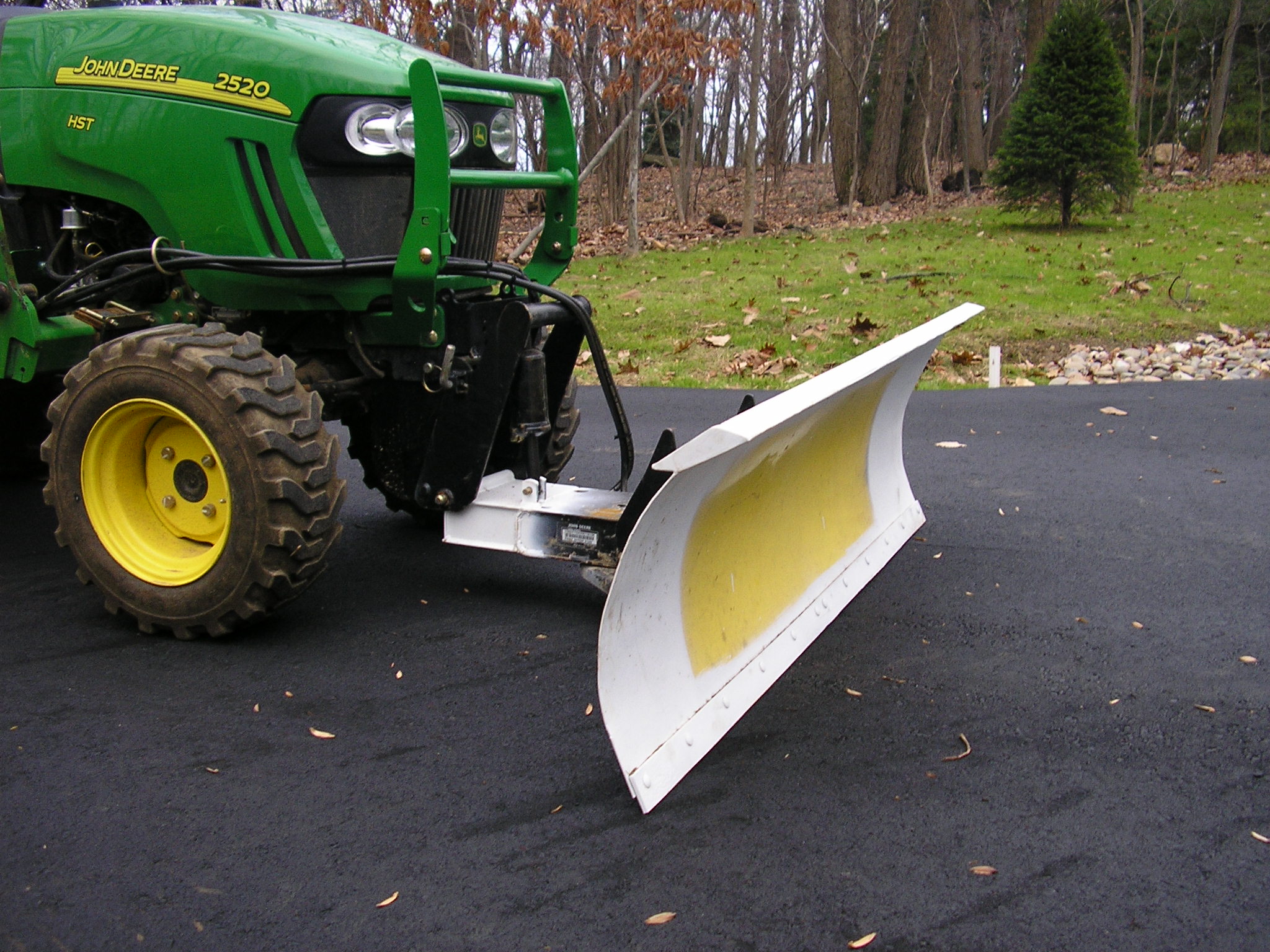

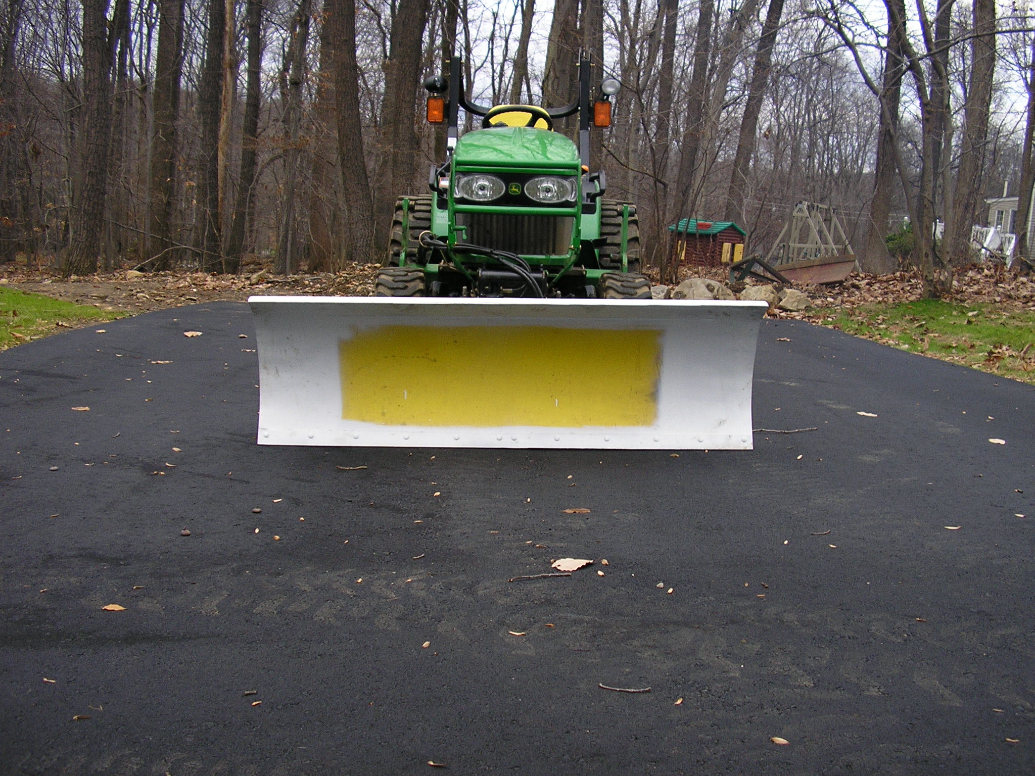

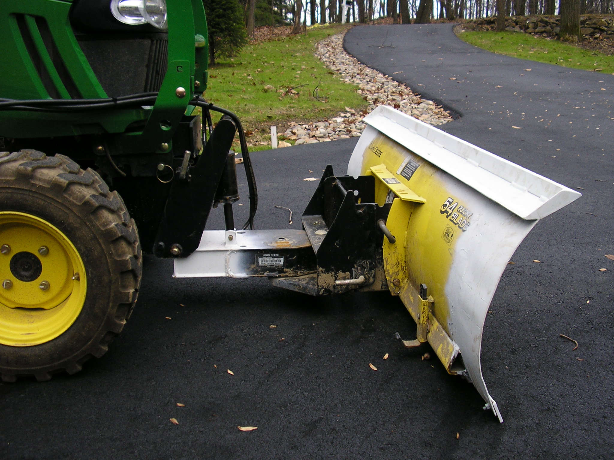

So if i were to try a snow plow. How wide should I be looking for? Like 6 foot, or 6.5ft? I don't want to put a plow on it thats impossible to make the very first pass, but I also don't want a narrow one that makes the small snowfalls take forever to clean up.
After reading through all the debate about fel/frame plows here on TBN I went with a fel plow because I need to switch from plow to bucket to forks too often on a daily basis to be detaching my whole loader.
I picked up a cheap Western 6.5ft from a guy down the road, sandblasted it, painted it up JD yellow, & welded a fel quick attach frame with the plow's A frame mounted back as far as I could go. I ran it last winter with some pretty big snows here in Michigan on my 2320 with loaded rears and boxblade (for weight + cleaning up close to the garage) - worked great - especially on my 800' asphalt driveway:thumbsup:

Would you guys suggest the JD quick hitch mount, or have a shop fabricate one up custom? I'm liking the JD quick hitch on my X475, but the **** thing is pricey if I remember right. I guess if I did go the JD quick hitch route, then any other JD attachment would also fit! :thumbsup: :drink:
