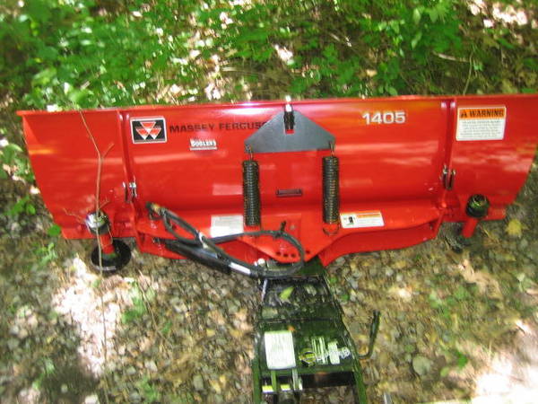

I have a 60" power angle blade on my Honda 6522, which would weigh a bit less than your 2520. I suspect you could handle a 72" plow in many cases, at least until the snow gets wet & heavy. When the blade is angled it is actually less than 60". On a typical drive, I find three passes usually does a reasonable job. Once down the middle and then down each side. With the Honda / 60" as long as the snow is not over about 8" - 10" or too heavy it does a reasonable job and as I said another 12" width would probably still work well. My drive is not as long as yours, however when the parking area is added total cleared footage is probably equal to or greater than your 900' drive.
For my situation a front or rear blower would be an underutilized investment and not required 99% of the time. For deeper / heavier snow or just seat time I use the FEL bucket on the 3320. Ive been tempted to sell the Honda and buy a 84" FEL mount blade for the JD, but find it handy to have the Honda around for other things and sometime use the Dozer blade for gravel / dirt work.
The Honda QA bracket is similar to what I have seen on Kubota and is identical to that used on smaller MF. All that is really required is a plate on the tractor front approx 5" x 13" x 1/4" for mounting. At one point I was thinking of mounting the Honda blade on my 3320. The front weight bracket on the 3320 is a bit too small, however it would have been easy enough to fabricate a 5x13 plate to bolt on - to which the QA would then attach.
I mention this to illustrate you could possibly find a not-JD blade that could be easily mounted on your front weight bracket. When I was looking to purchase I measured the height of the front bracket on 2520's and the height would have been fine to mount the Honda blade.

I'm really leaning towards buying the JD quick hitch, and then just putting a plow of some sort onto the JD Quick Hitch. Then I could also throw the Blower from my X475 on the 2520 if I ever decided to (not likely, but its an option thats worth having).
I think it would be much easier for my fab shop to weld up what ever is needed to make the snow plow fit onto my JD quick hitch. The FD quick hitch on my X475 works excellent, so I'm confident the one for the 2520 would be nice also. Angling this blade is a definite necessity to me, because I'll be plowing around buildings and all kinds of stuff.
