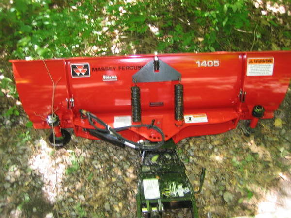

I made mine as a quick hitch, that stays with the plow, tilts onto the front mower draft plates and bolts (2 bolts) to the weight bracket. The time it takes to tighten two nuts on the bolts and connect the three hoses is about it. Probably a total of 10 minutes to get the plow off and the FEL mounted at most. :)
Search on Western plow for previous posts that include quick hitch pics.

I can only say what I like better, and do not care if others prefer a snowblower. :D I am perfectly ok with that. But I'll stick with a blade for less original cost, less maintenance, faster snow removal, and that sums up as more fun for me. :D :D

If the drive thaws out, the blade can be set up with skid shoes to not touch the gravel just the same and as easy as a snowblower. IMO. As well, also will work to carry them. :)
