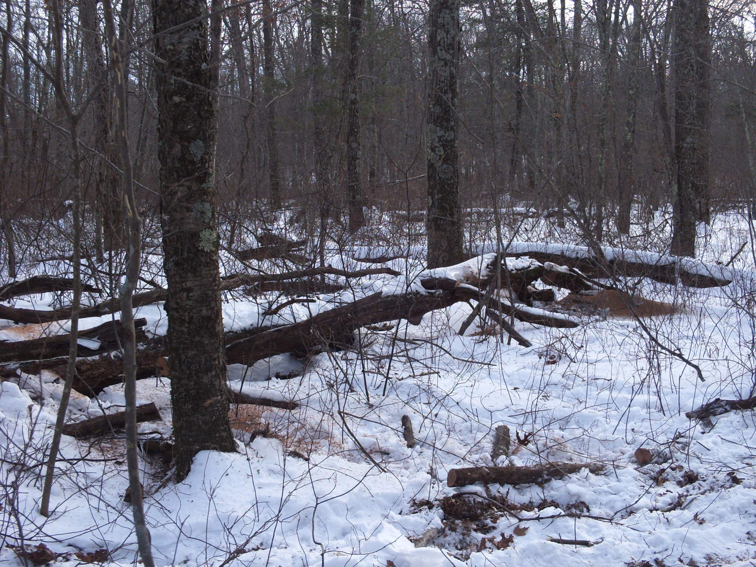

Thanks Matt for your input. I'm sending some pics of my terrain in hopes of comparing tractor use in this regard. I have many ground obstructions. This JD has been doing this for 25 years. I broke a steering gear housing once and stripped my differential bolts another time by using the track lock incorrectly. (used to engage with tires spinning). Other than the same bends you experienced on your brake rods, the tractor has been an excellent tool for this endeavor. I also had to slam a 1 1/8" pipe over my steering tie rod which is behind my front axle to beef it up as this was getting bent unmercifully.

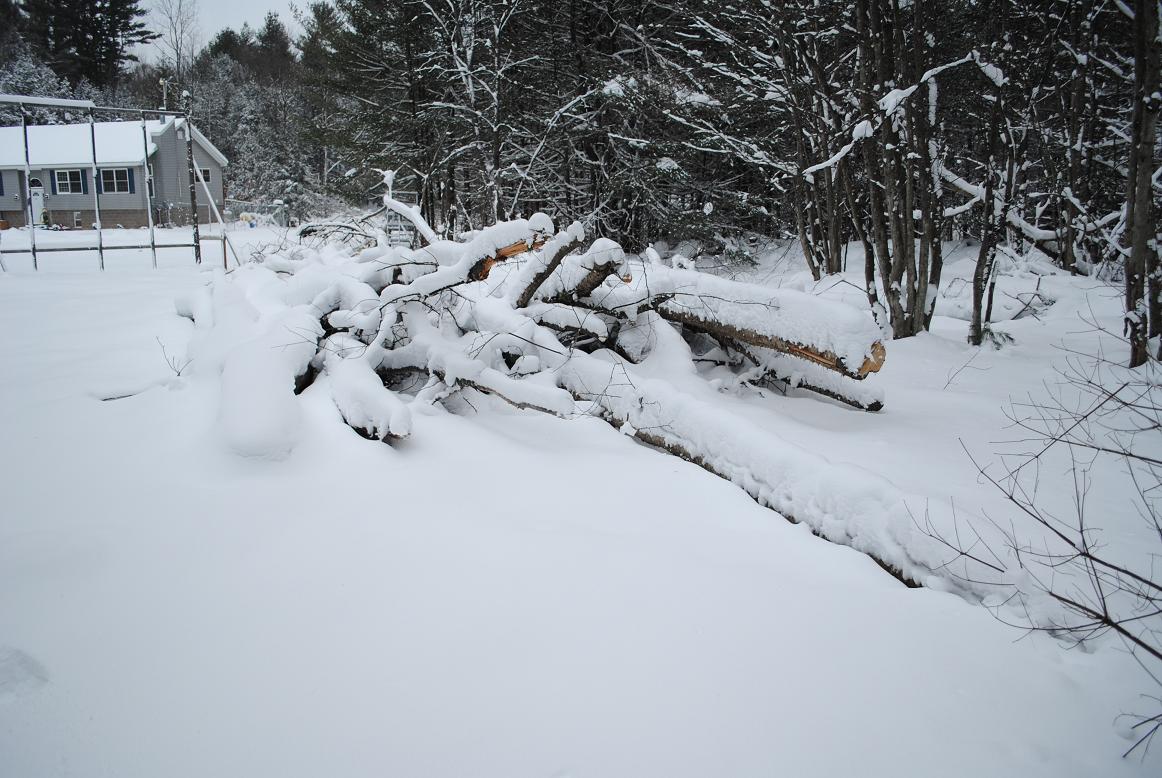

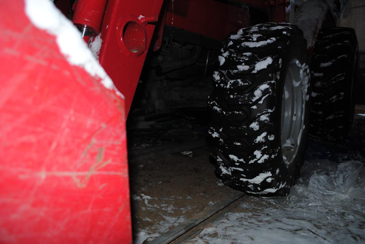

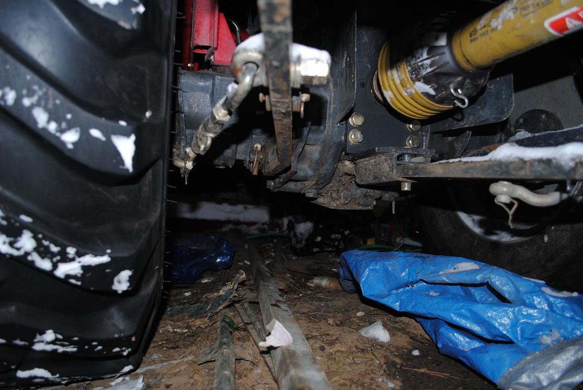

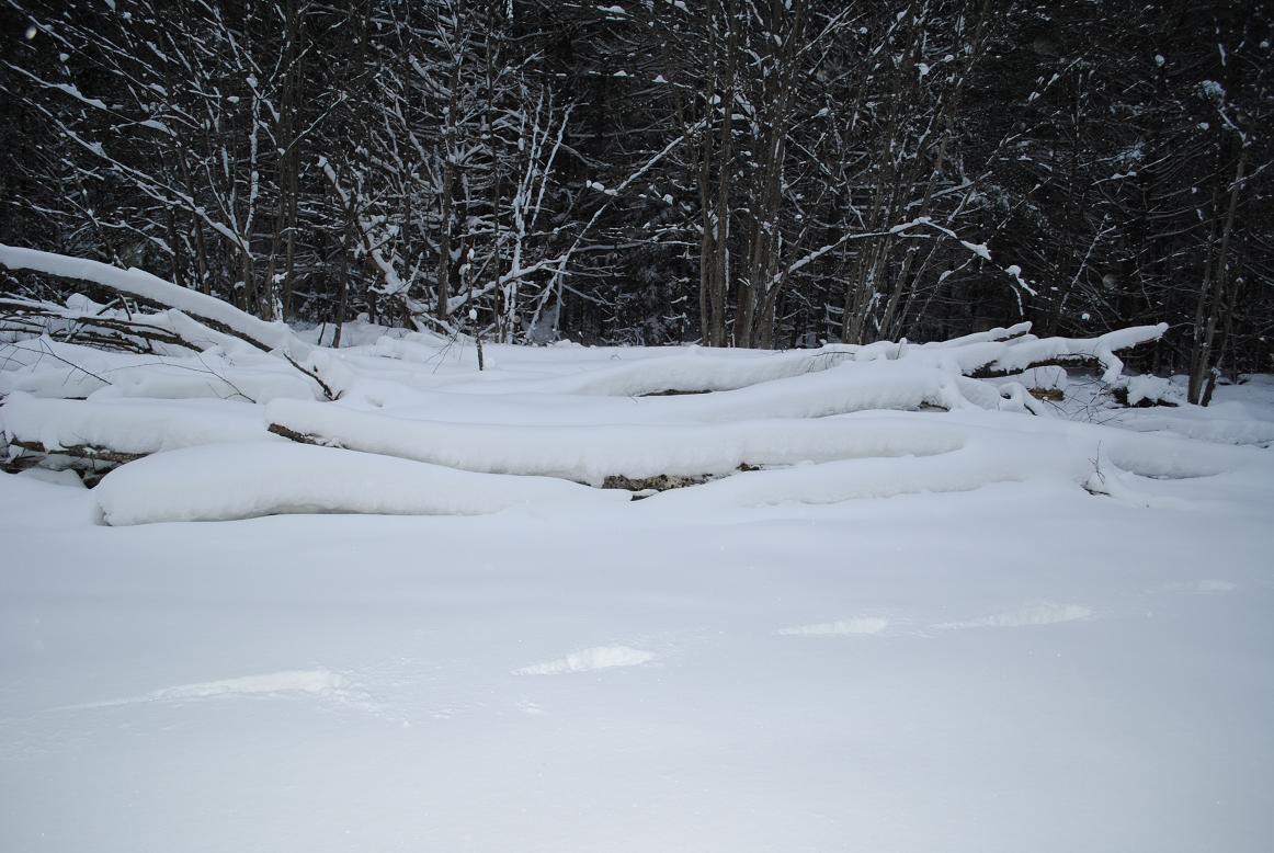

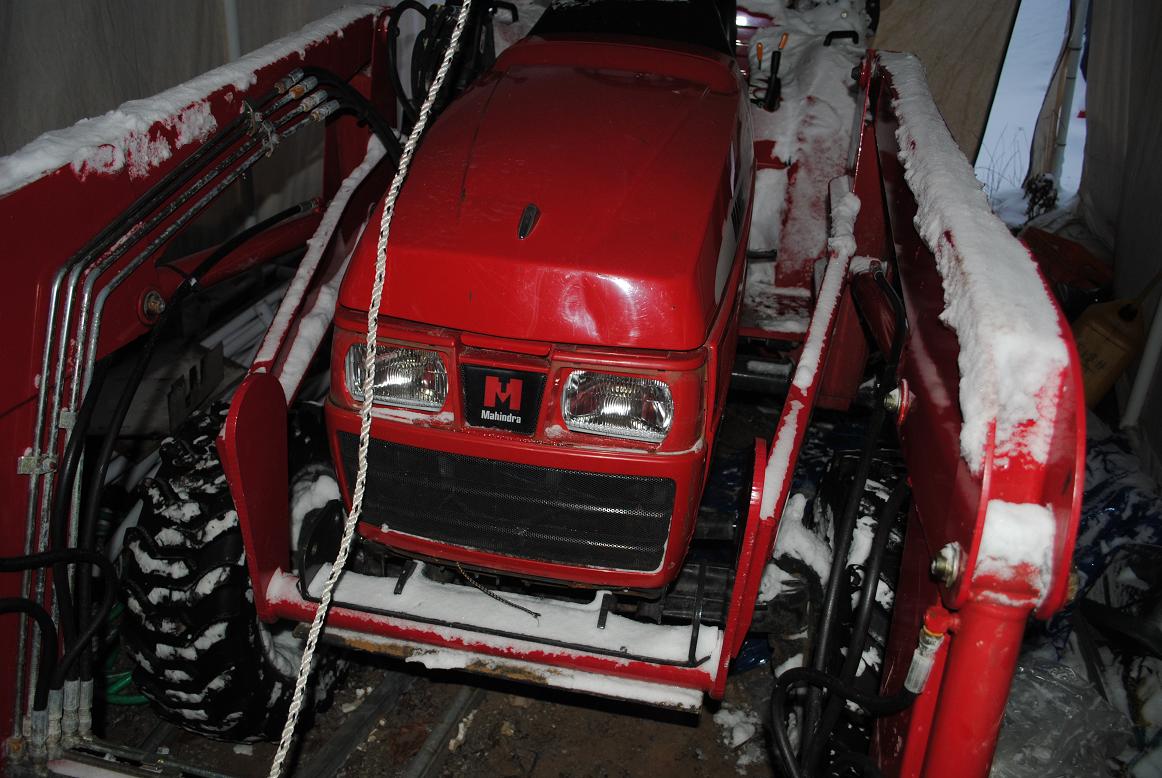

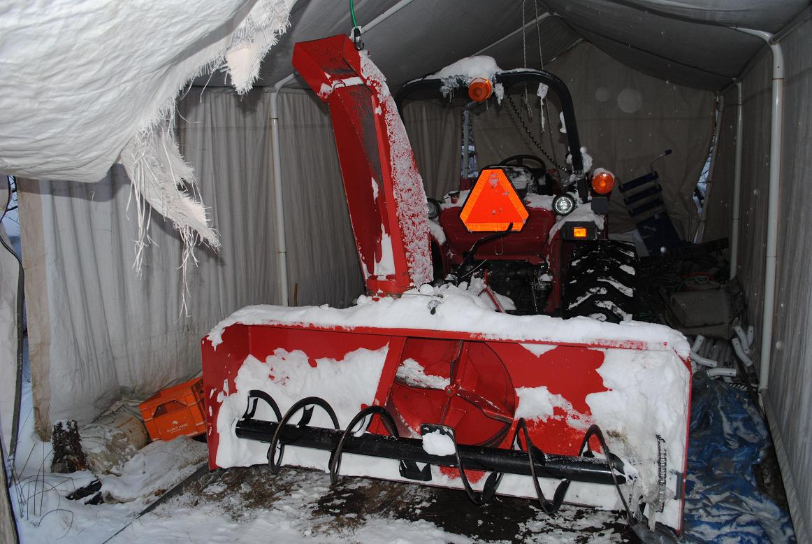

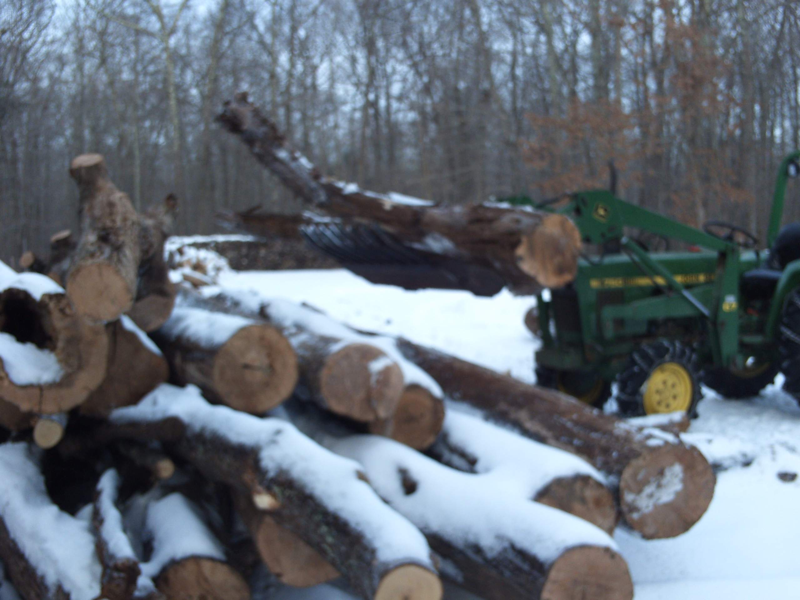

Ok, took some pics, they aren't very good. I see my little bungees broke off the grill. I'm running a 72' blower, i blow in high gear when there's 6" or less if you were looking to run a blower also. The trees are all cut in half and you can see how long they are, the bigger ones are on the bottom and completely buried.

I used to leave mine long like that as well. That's how we would land them when I was a logger. It only took 24 years but i finally wised up and cut them down to no longer than my fel would handle. Sometimes that is less than 6 feet if its a 22 incher or the like. (more like 4' for a big white oak) After I pile them, the next splitting season I scoop them back out of the pile and bring the entire stem to the splitter. While elevated with the fel, I'll buck them so as to not cut on the ground. I then come around and scoop up the rounds with the forked fel and park right next to the splitter. A simple lift and body turn gets them on the splitter. If its a big round like 200-300 Lbs, I'll use the fel as a log lift and roll the sucker right onto the splitter. Those forks bolted to my bucket, are one of the handiest implements I have

A good investment is to make sure you get a brush guard for the tractor because it just might save the hood and grille. Otherwise you might end up with a dent like Matt701 has in his hood or worse and it possible a guard might have help prevent it.

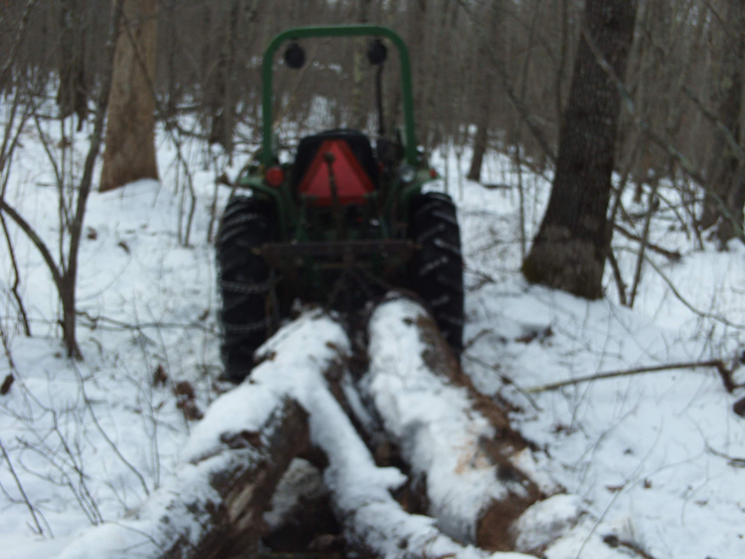

I'm just glad my hood is all metal whereas some of the other makes have plastic hoods. I don't mind cosmetic issues, its a tractor I use a lot and things will happen. I liked the forks on your JD, it looks like they would help a lot moving wood. I am skidding through about the same terrain as yours, sometimes I have to make my own path before I can pull them because of the dense trees. I have only buried it once in deep deep silt while pulling a whole tree. My friend brought his 2910 kubota over and couldn't even budge me with a chain in 4 wheel drive, he had to dig a path down to the clay and then I was able to drive out. Wish I had pics of that, silt does not wash off, its like grease. I need to look into a grill guard for sure. Cant really see how bad the dent was on top, but when I banged it back out some of the paint chipped off. I love the idea of cutting them up with a chainsaw while on the fell, seems like that would also be a back saver. I do the same thing, cut and drag out in the fall, split in the spring and season.
