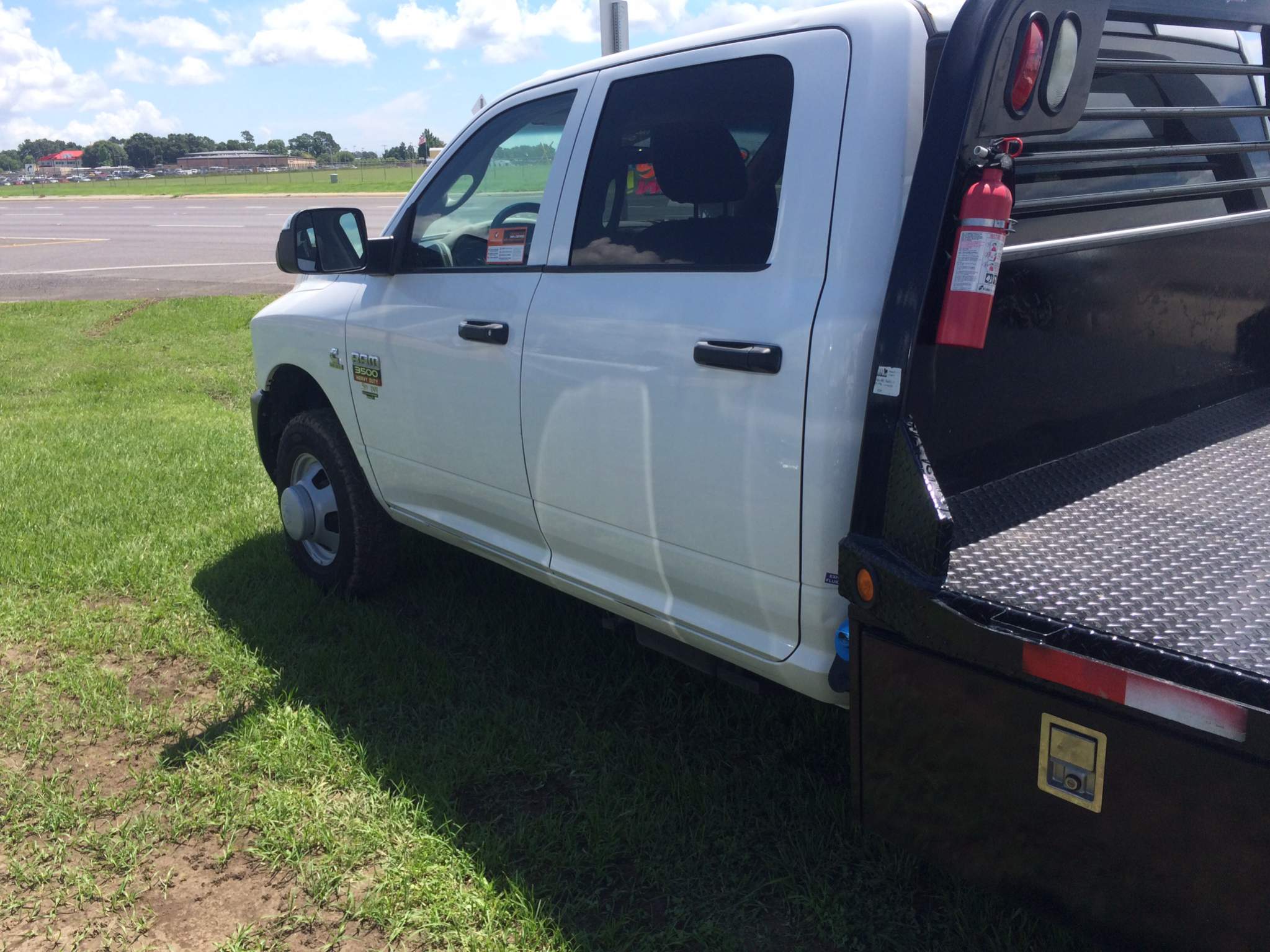

I took some time to read the Dodge Cummins forum and I'm getting a little hesitant about buying a Cab/chassis truck.
I had never heard of them being 'detuned' until some of you guys mentioned it here. It seems to be a big issue. And I know that my brother (a John Deere Mechanic) drives a 2012 C&C 3500 as his work truck, and he complained that he had trouble crossing the Mississippi River Bridge in Baton Rouge with it even though he never pulls a load with it.

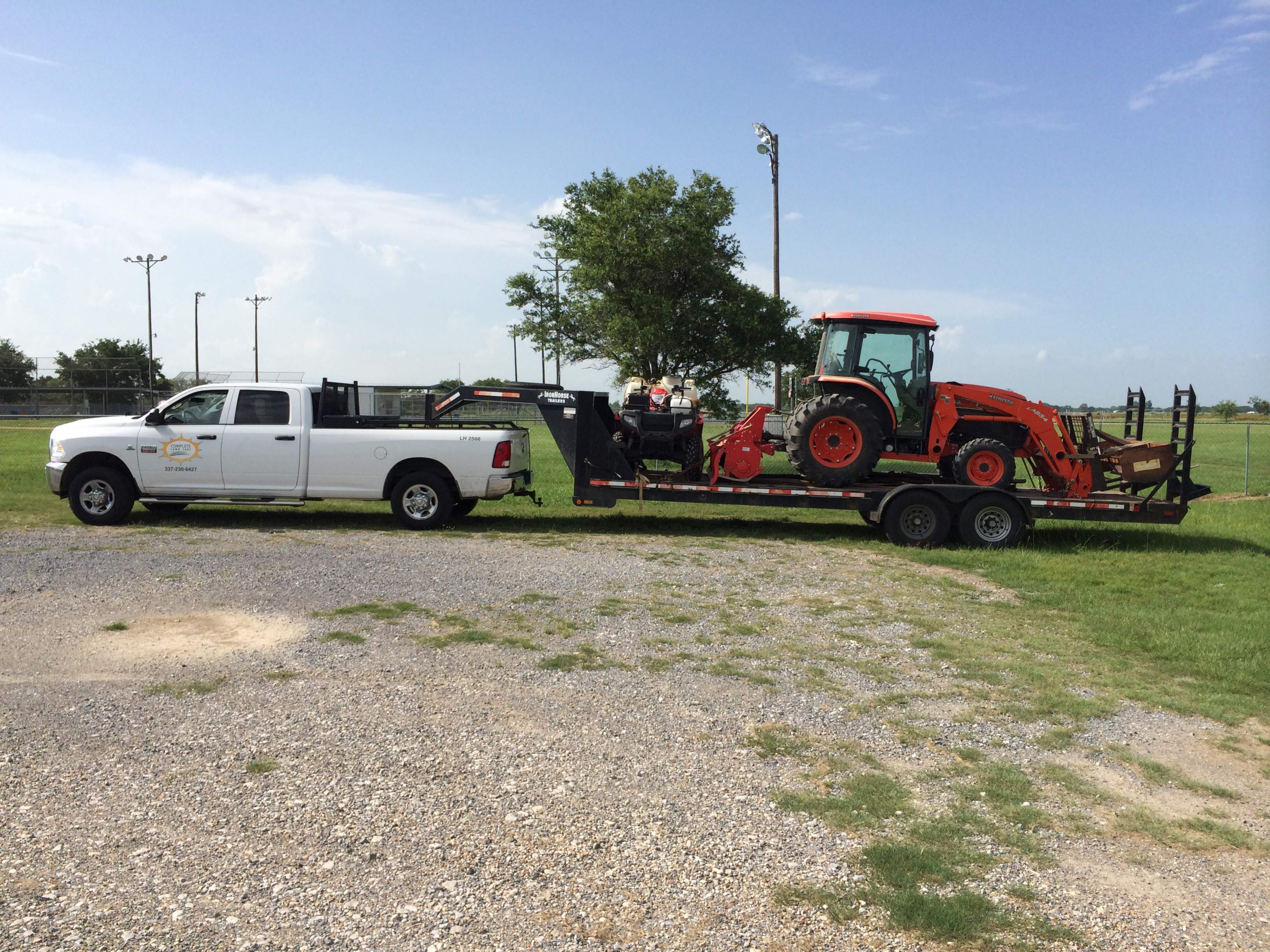

And my truck (2012 Dodge 2500) has no problem climbing the bridge with a fully loaded trailer in tow.
I still want to go drive it, but just don't know when I'll get time. I wonder if the dealer would let me tow my trailer with it for a test drive?

The best way to try it out is with a trailer and what you intend to pull with it. That's the only way you'll know how it compares to your current truck. If the dealer won't let you, walk away, there's lots of used trucks out there and good financing on new ones. Also keep in mind this dealer wouldn't have bought it unless it was a really good deal at the auction. You may be able to find out what they paid for it as well. Auctioneers often post the selling prices of their auctions. It would have been better if the dealer had sold the truck new and had a history on it to justify a premium price for you to upgrade. Was it sold at auction because there was a problem with it? Maybe there is a maintenance history on it through Dodge or Carfax or something.

I started this thread on 06.13.15, and today is 07.06.15, and the truck is still there. I texted the salesman this morning to go test drive it, and he said it is not available because they are waiting on a tire and wheel for it. Apparently someone needed a wheel, so they robbed one off this truck and ordered a new one. He said he would text me when it becomes available again.
The truck has been on their lot for about 6 weeks now. I'm hoping they are getting eager to sell it, so my offer will probably be going down.
