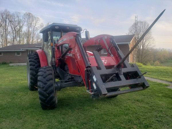

I was really aiming for a rops but I managed to get a lead on a barn kept 2012 2670 HD with a DL280 loader and CAH, better condition and lower hours for 4k cheaper lol. I'm having a real hard time not pulling the trigger

Well if you're in Maine you'll likley be dealing with snow at some point and a cab would be much nicer to handle that task.
