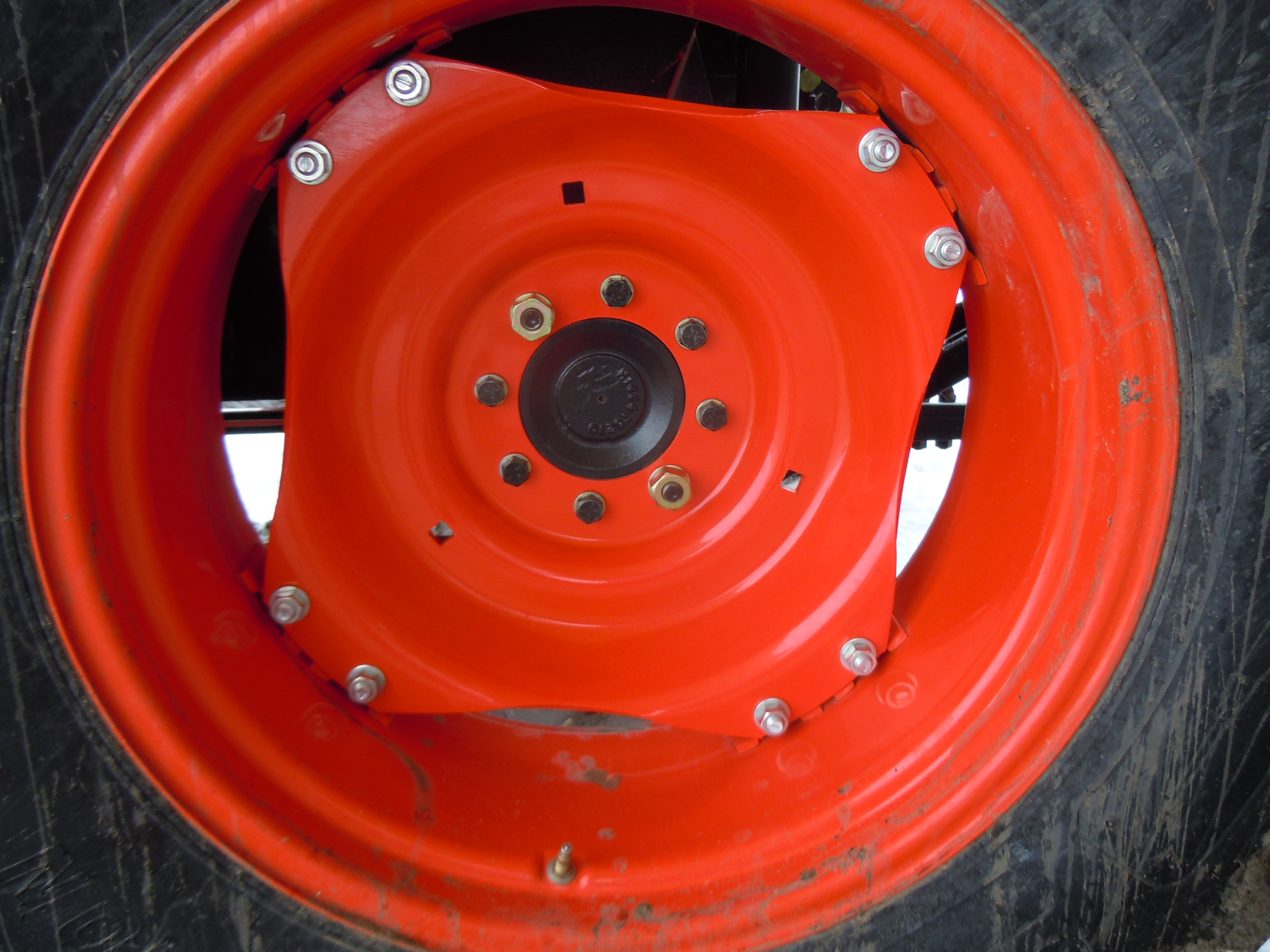

Are your wheels still set like they are in this photo, if so you still have some adjustment left? Leave the centers as they are but switch the outer rims from side to side. The mounting ears on the rims are also offset and by switching them you will gain some more width.
I find it interesting how different a manufacturer can make things and why. I have been wanting to widen my tractor stance. Just haven't figured out how to support and make the change.
Point of my post is this;
Look how mine came from the dealer, note the valve stem compared to what partyhound's looked like. At the rim's widest stance the valve stem is still on the outside. Distance inside to inside is 48.5", but I still want that extra 3-4 inches.:)
These are still not at there widest setting. The loops on the rim would be on the outside of the inner disc. As for the valve steam location it depends on how the tire is mounted on the rim being a directional tread.
   / 3 Bottom rollover plow (IH140 plow) questions #29
Well duh!! Now that you said it, it makes perfect sense. I'd like to think I was smarter. :laughing:
I knew there was more room by adjusting the rim, but sure didn't know about how the tire was mounted.
