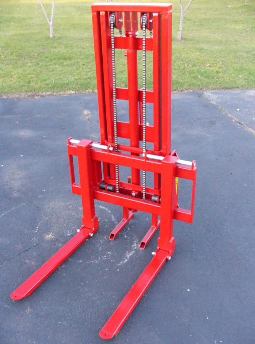

Anyone else using one of these I had one years ago and just purchased a new one to double stack heavy skids I wish I would have kept my old one they have really gone up in price over the years.

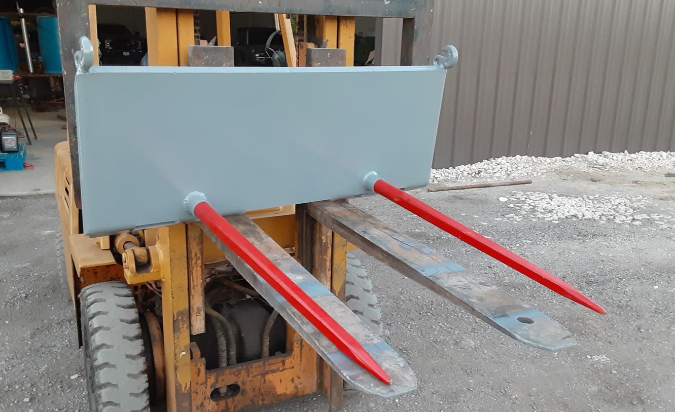

I have a forklift mast I wanted to do that with but never have.
I did make my last hay spike so it could be used with pallets though.

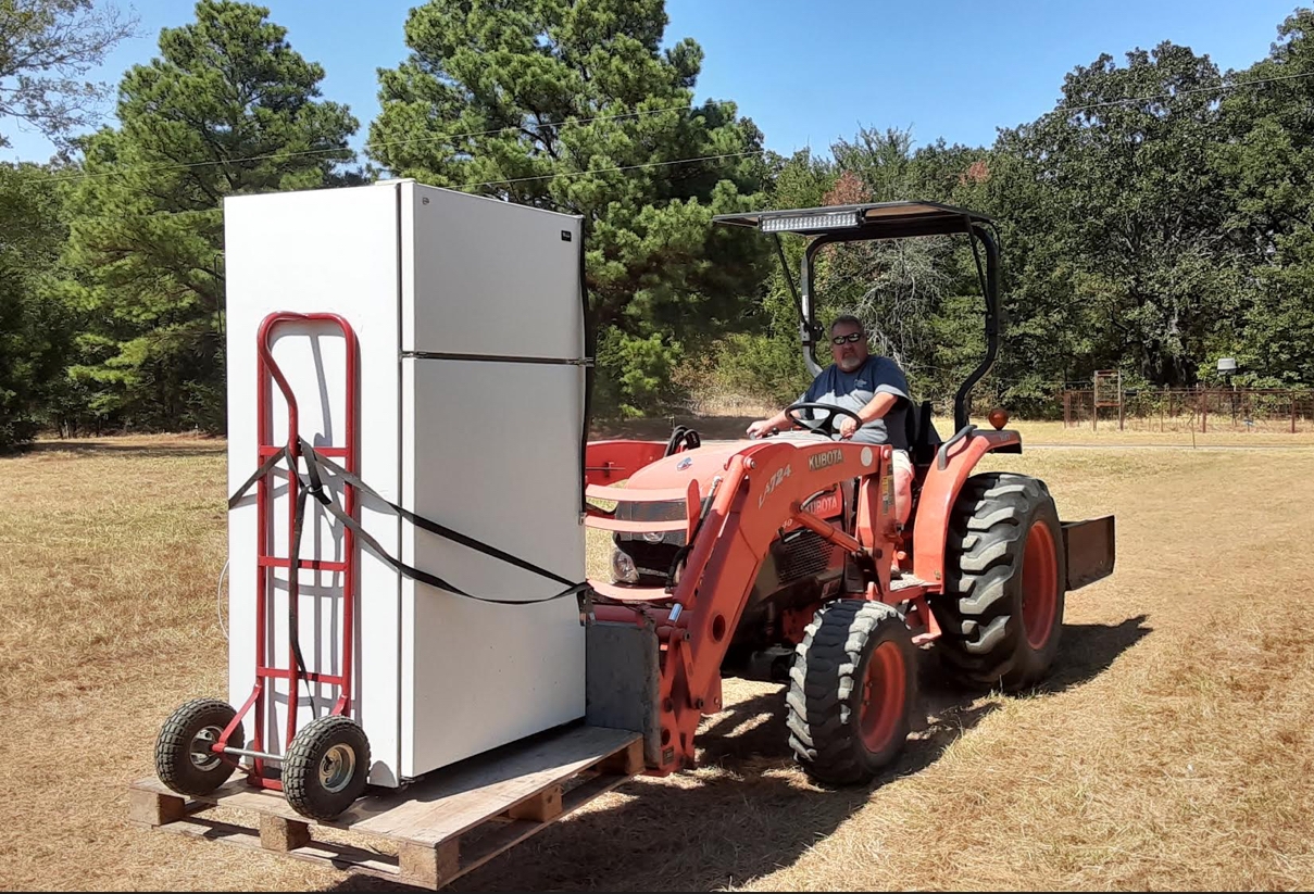

It has a better reach than my fork lifts. Like moving a fridge over the steps up to a deck or setting something into the back of a truck past the tailgate without having to let down, back up, lift again and skid. More distance from back of forks to front tires being the key.

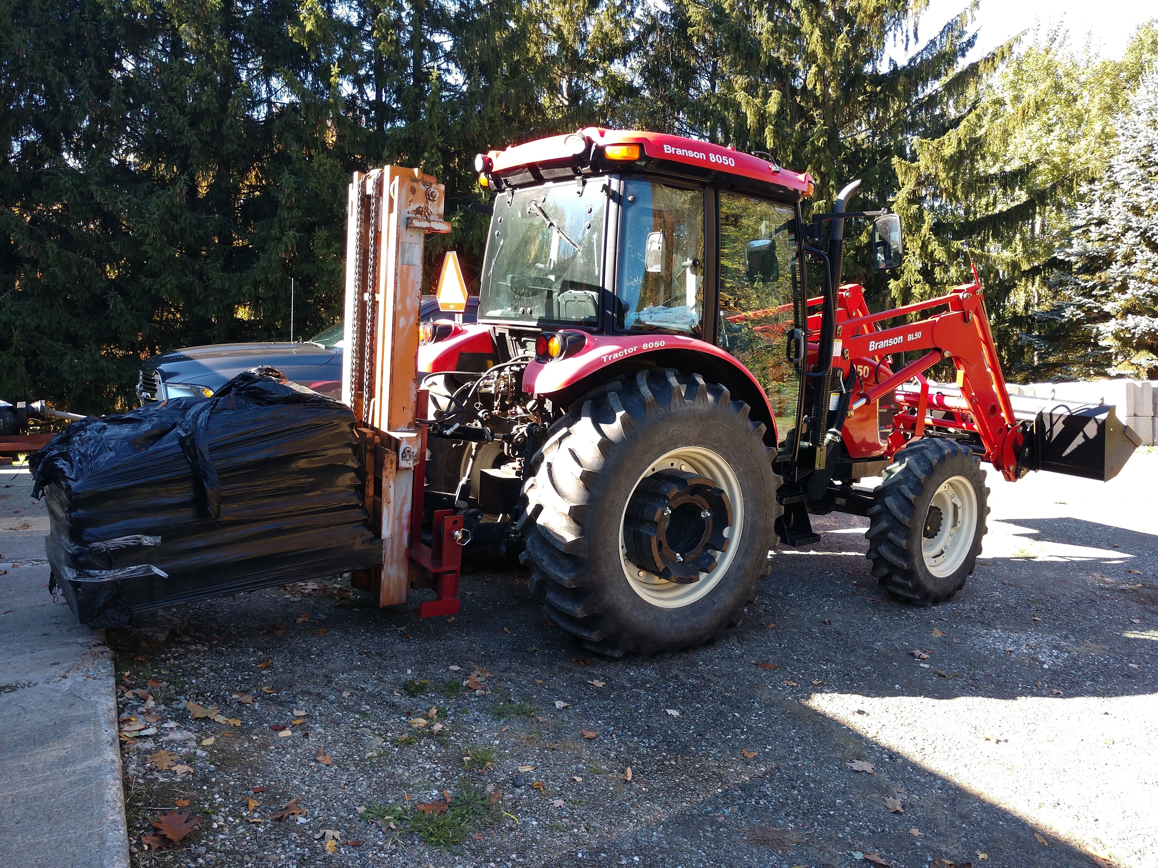

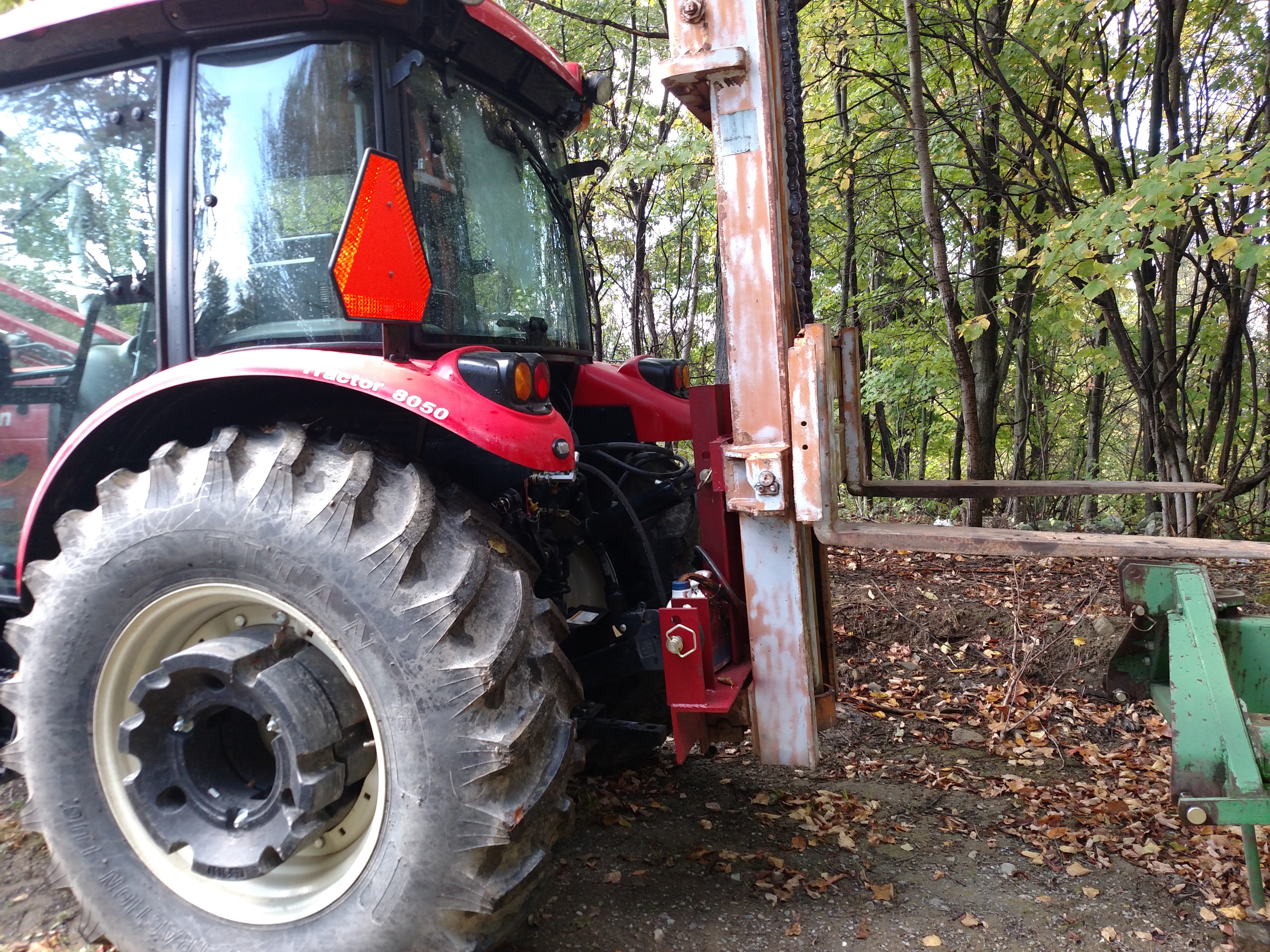

I have a two stage adapted to 3 point and it is a good unit. My hydraulic top link works well for the tilt function. I've never had a problem with the 3 point allowing to much side tilt. For that to happen you would need to get the center of load outside of the lift arm while high in the air which could cause other issues.

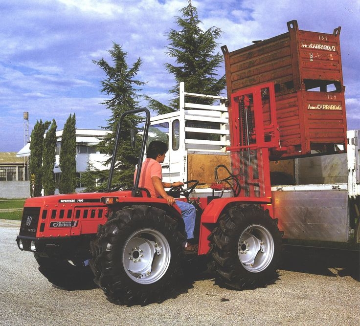

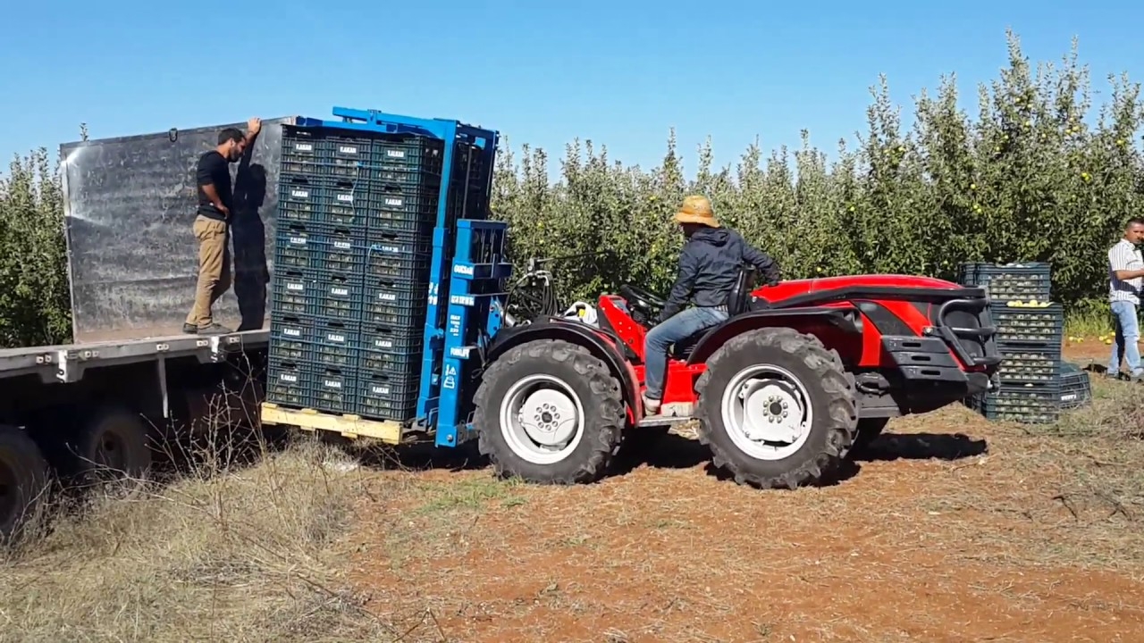

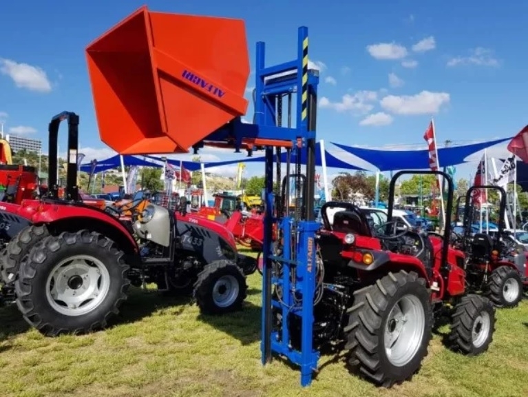

Pretty common in the orchards around my area. They're used when loading trucks directly in the orchard with the bins full of fruit.
The big advantage is that you're putting the heavy load exactly on the axle that is meant to see big loads, the rear axle. It also doesn't extend way ahead like a front loader does, so a much better fit for an orchard and its tight places.
Some people will find a cheap forklift mast but those tend to be on the heavy side. There are these forklift masts made for tractors that are much lighter.
They can use attachments like this tilt bin for grape harvest. It gets filled with grapes, then dumped on another tractor with a dump trailer.
