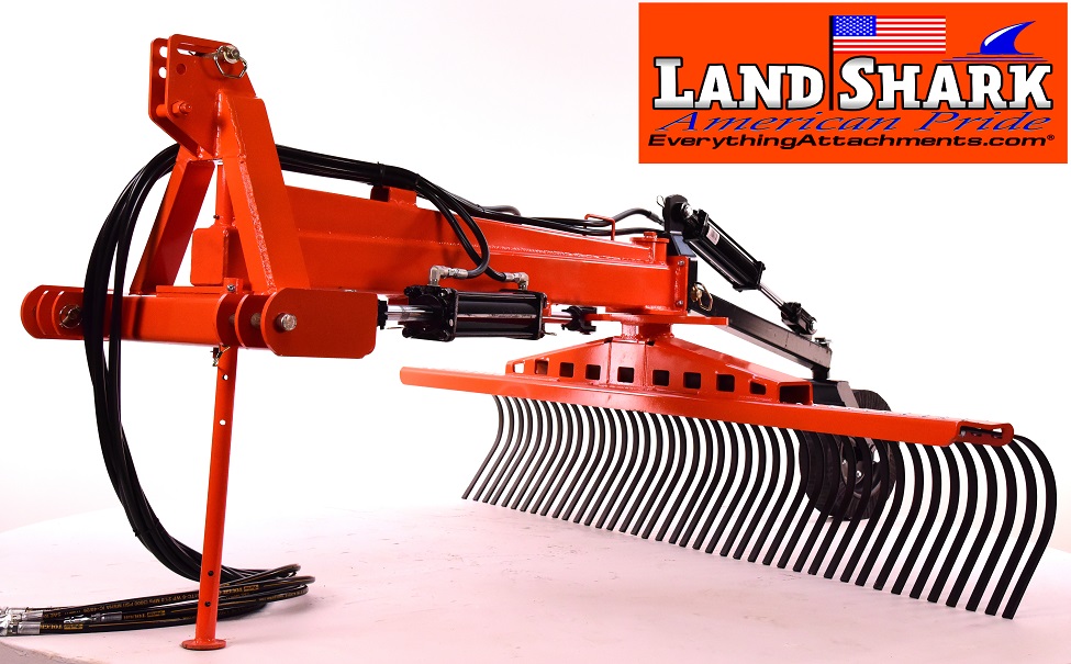

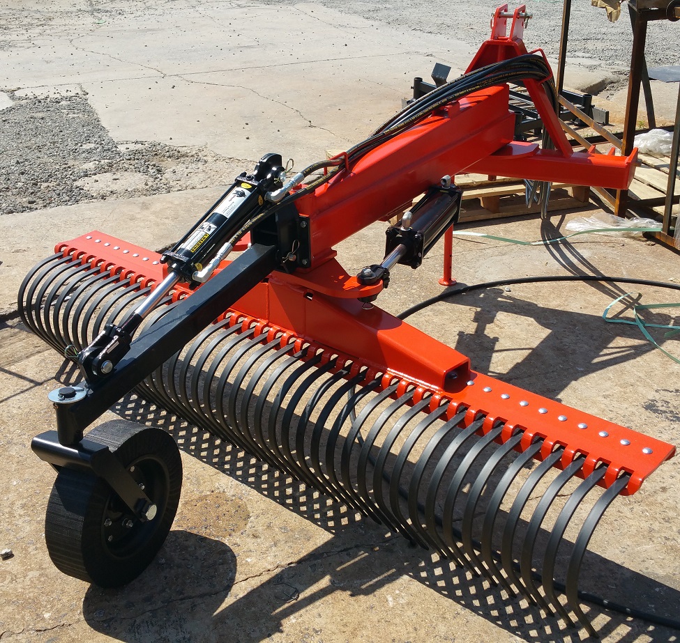

Here is their new heavy duty model: http://www.tractorbynet.com/forums/...ark-hydraulic-landscape-rake.html#post4464026

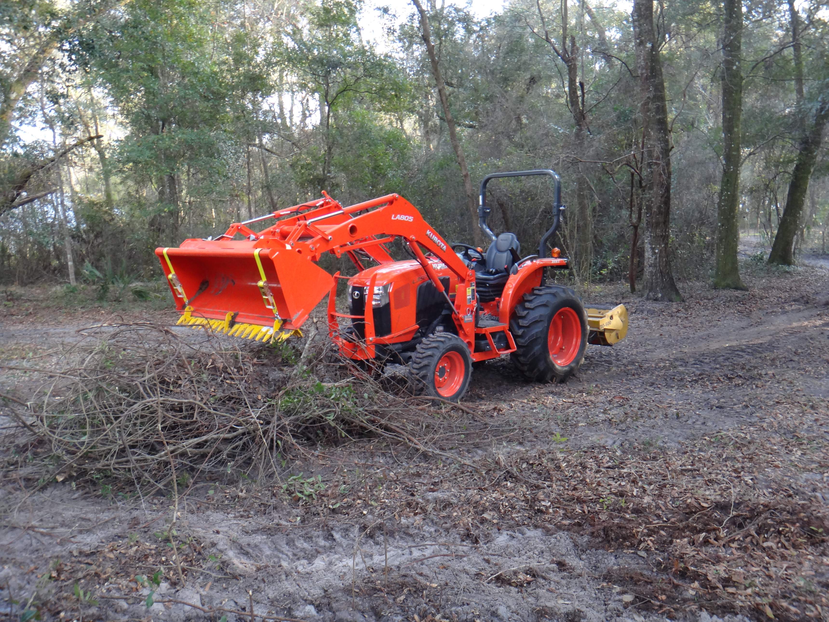

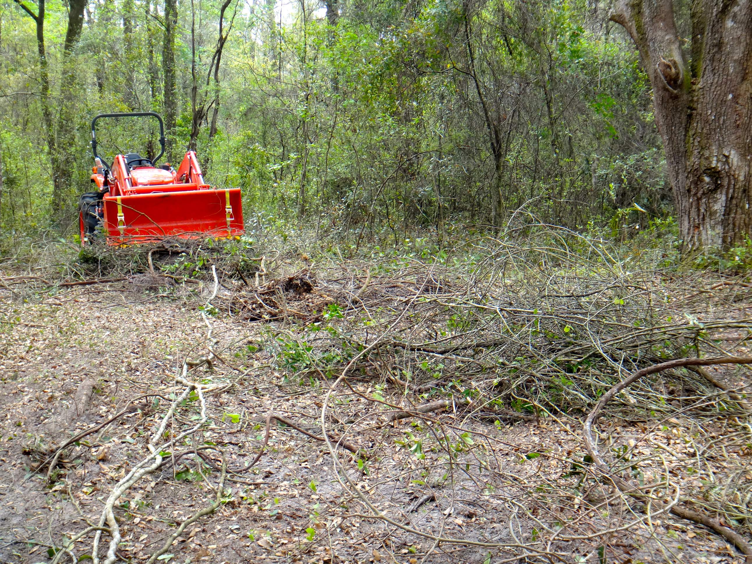

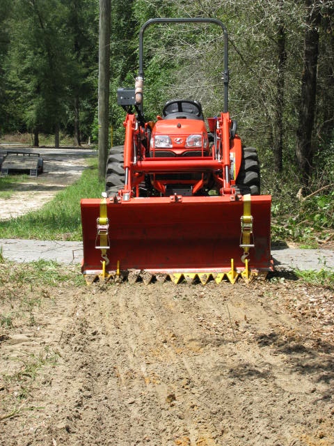

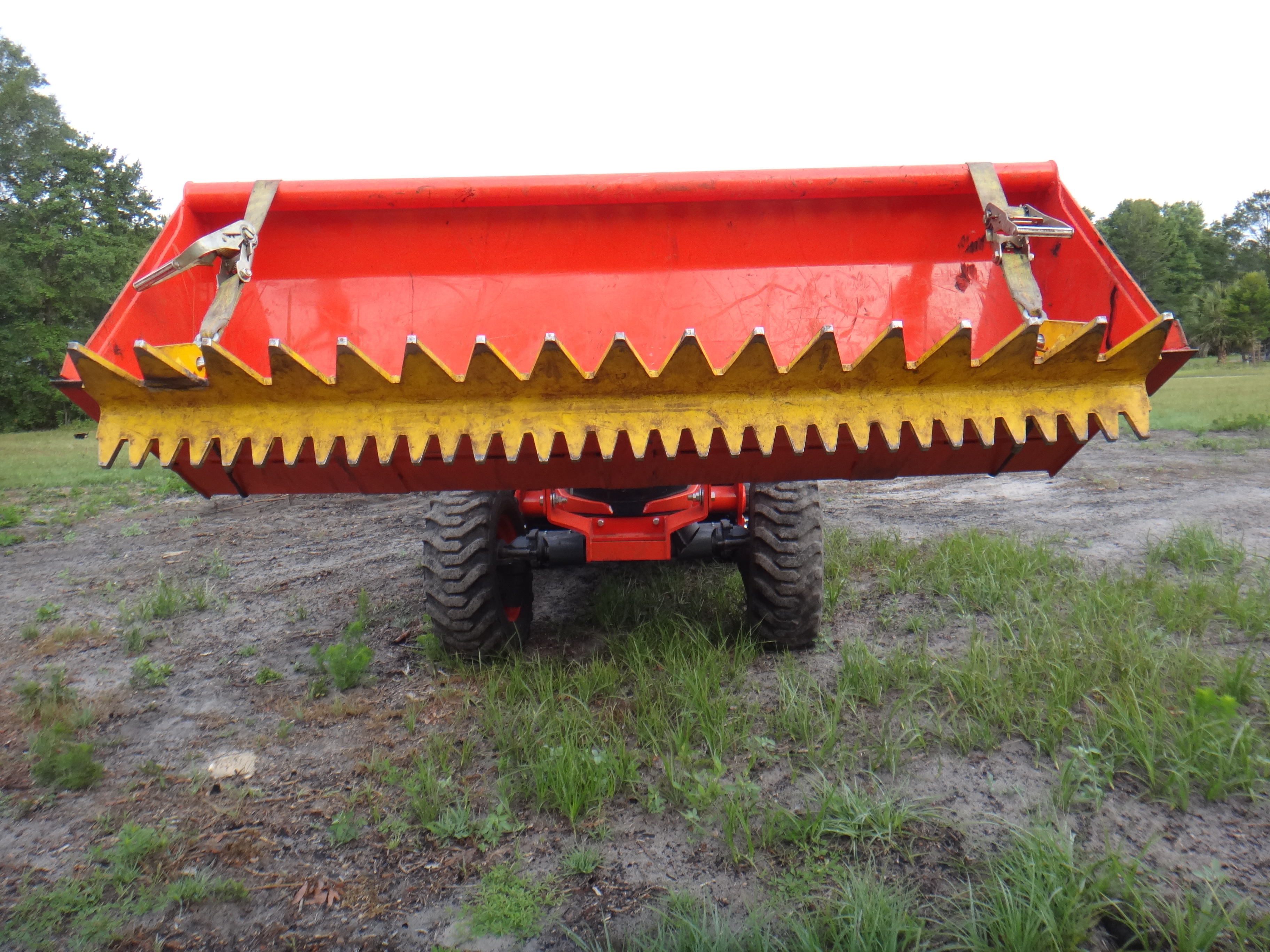

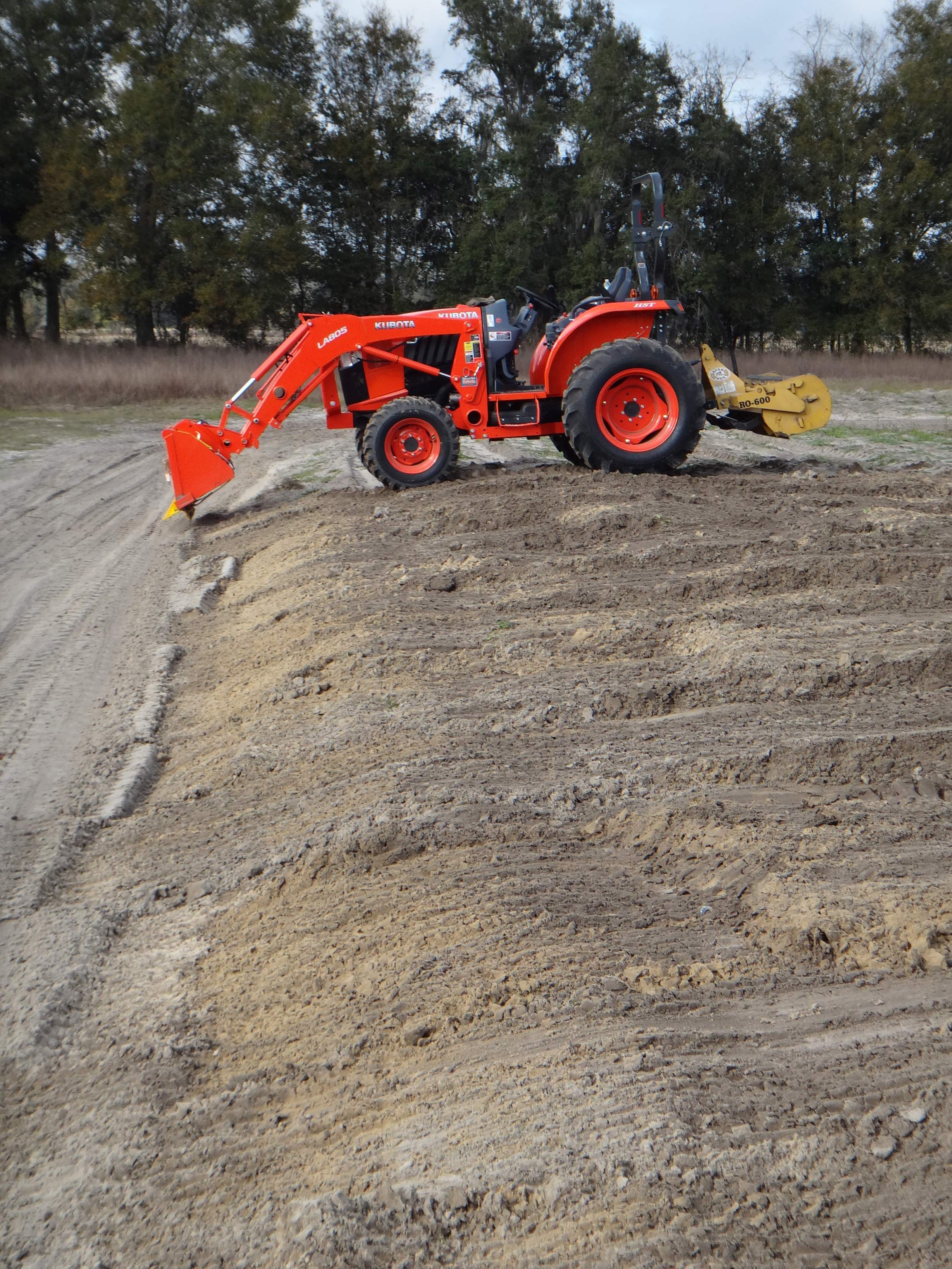

I own both an ETA Landscape Rake and a Ratchet Rake FEL bucket attachment. For the uses you have specified, the Ratchet Rake will be more effective than a Landscape Rake. Ratchet Rakes can be purchased from the T-B-N store, delivery by common carrier.
I have used Ratchet Rakes on both my relatively light Kubota B3300SU and my heavier Kubota L3560.

Jeff, thanks for the pics on ratchet rake, might be the best choice although and like you, having both would be better!
