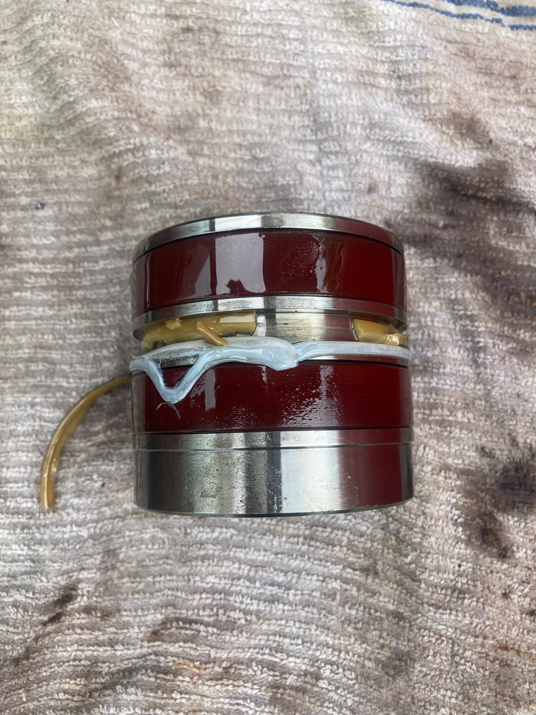

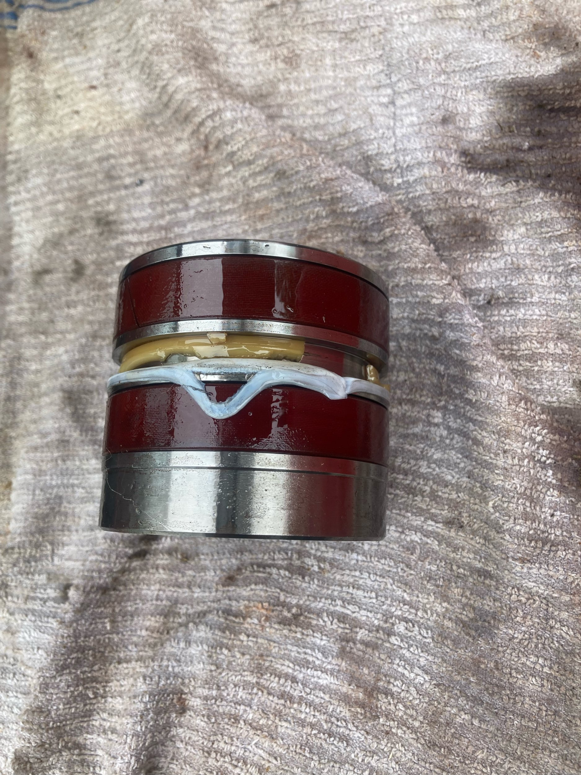

Pulling this old post out since I’m in the middle of addressing my bouncing three point hitch Issue.
Shout out to Dave’s tractor, Jared and Dillon were great help in sourcing repair parts. Parts should be here this week, I decided to pull things apart and see what the conditions were.
For sure had a “Well there’s your problem” situation.
Most difficult part so far was getting the plastic adjustment knob to break loose. I backed off the locking nut but the nut for the knob would not budge, I was at the point of fear of rounding the nut. I decided to try and actually tighten the nut and it moved, after that it easily backed off.
Here‘s the carnage.
Mike
Here‘s the carnage.
Mike
View attachment 715698View attachment 715699
That's a smoking gun for sure. Good for you for doing this yourself. It's not a bad job.
