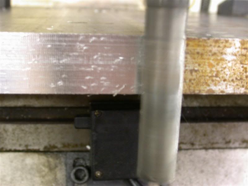

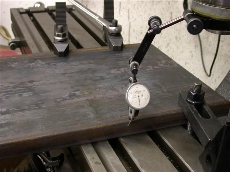

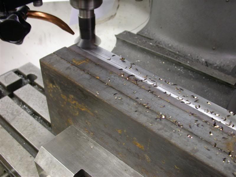

There is a lot of prep work to make sure the plates are square and parallel for when I do my hole bores. I'll know they will line up and not be cockeyed to each other causing binding or something.
Here's a short video of one pass. Sorry it's not that great but I had to dodge hot chips while filming. It only shows the last strip being cut left on the longer plates though.
I was machining .080" a pass at 20" a minute (approx) with air cooling the inserted carbide mill cutter. I machined all the plates together because they all had to end up the same size.

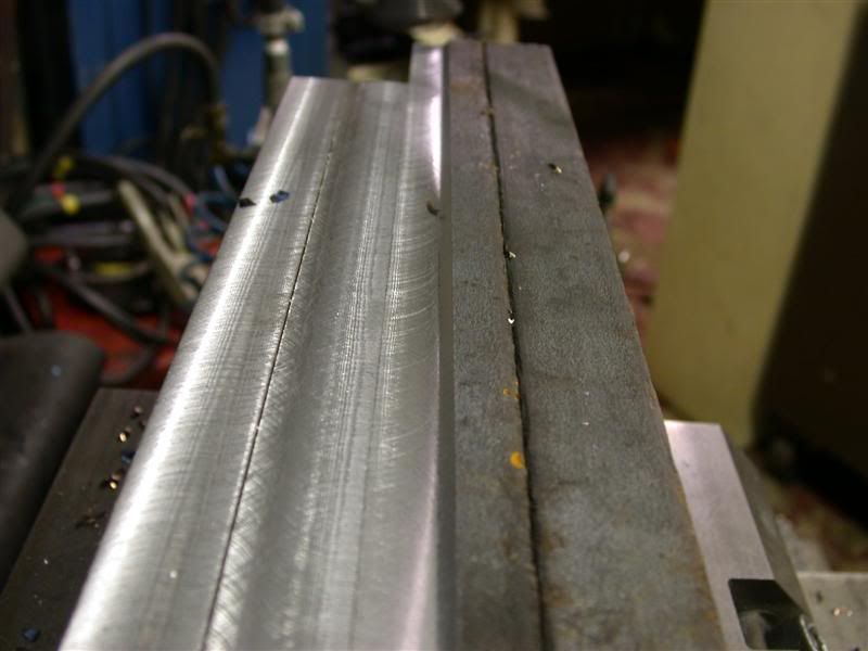

Back to the work now, I took the entire vise off the mill with the plates still clamped up in it. Then checked it on the surface plate to see if the plates had moved. I used and InterRapid indicator to check for level.
Then had to stone all the cuts and edges to remove any burrs.

I wanted to surface grind this dimension for a couple reasons. I needed the plates to be exactly the same height to avoid leaks, but more important, when I do the boring I can measure for exact locations accurately.
So first I had to dress the surface grinding wheel with a diamond dresser. (Also a home made one). Then I placed the vise with the plates still clamped in it all on the magnetic chuck.
And started surface grinding the plates while in the vise. I kept them in the vise so the first edge I grind will be square to the flat part of the plates. My vise jaw is square so I know it will come out good.
Rob-

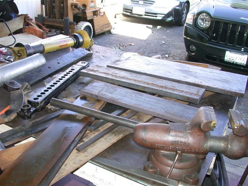

Once I got the top side ground, I took the entire set up out of the grinder and clamped the plates together before taking them out of the vise. My vise alone weighs 65 pounds so with the 4 side plates in it the whole thing has to weigh about 140 pounds.
Anyway, I took the clamped up plates out of the vise and put them back on the grinder resting on the newly ground surface. And ground the other side down to size. Surface grinding you can only take about a half thousands to a thousands at a time, so you have to mill within about .006" of the finished size.
Here are the plates resting on the squared up ground side by themselves.
This is a good picture of my home made vise next to the plates. It is a little shorter than the Kurt Angle Lock vises some of you have, but with much greater standard clamping ability due to it's design. It's about 14" long vs 17" but has 6-1/2" wide jaws instead of 6" on the Kurt vise. Also, it is square all the way around so I can hold stuff sideways or even upside down if I want. On the Kurt vises, you can remove the jaws from inside and bolt one to the back and the other one on the front (by the handle and hold stuff on top of the vise. But then clamping force and getting stuff dead square becomes an issue. I've had the mill throw lots of work pieces ... rip it right out of all kinds of vises. :(

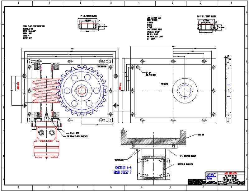

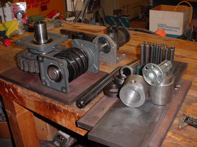

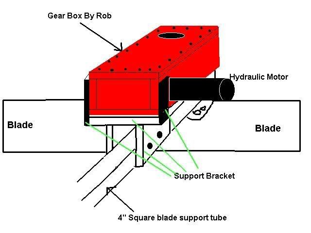

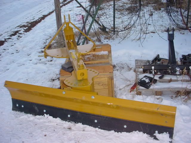

After seeing what Rob's been up to, I figured, I too better get with the program. Today I hooked up the Back Blade to my tractor for the very first time. I painted the drive coupler and attached it with the 1/2" shear bolt. Then I made up the hoses with quick connects that will attach to the hydraulic motor to drive the worm. The control valve is all hooked up and ready to go.
In addition to the 90* worm Gear Drive that Rob is so painstakingly machining for me, I want to use a hydraulic cylinder to adjust the swing offset. I have this cylinder lying around so I set it in place to see if it will work.
Here I am holding the Hydraulic lines and analyzing the situation.
I’ll have to wait till the mounting bracket for the gear box is installed before I can mount the swing offset cylinder. It will be an integral part of the gear box mount.

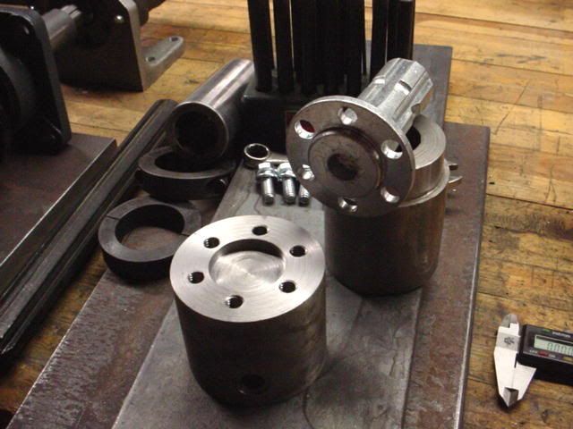

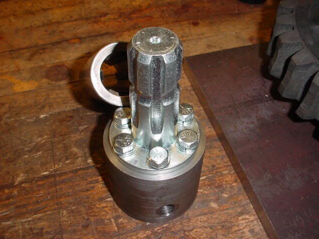

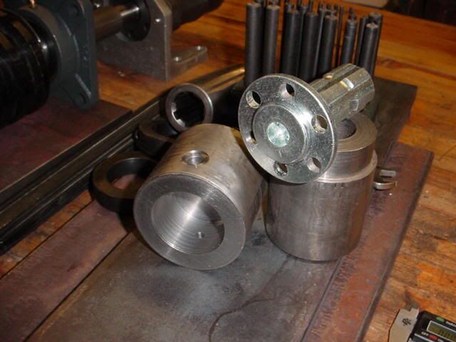

Here is the bottom plate all finished except the counter bores that will hold the thrust bearings, collars and oil seals. Oh, and will also machine a big radius on every corner yet, so Larry doesn't bust his shins on it.
I have also set up and roughed what I can on the top plate. I am using the numbers from the bottom plate as a guide to get me close to the finished dimensions. I roughed these out with a 4 flute solid carbide endmill but will finish with a 2 flute hi speed endmill for better finish. I will be taking less of a pass and the chips clear better/faster with the 2 flute.
Unfortunately, the top plate is shorter than the bottom plate so I can't mill the entire pocket in one set-up. I've set the plate up so I can mill the long pockets and part of the ends and I can still drill all the holes. But I will have to reset the plate 90° and pick up centers again to finish the end slots. Not only that, but I'll have to do that 2 times because the end slots are too far apart for the "y" travel on my mill to do both in the same set-up.. Bummer.
Getting pretty close to seeing the light at the end of the tunnel ... and it ain't a train!

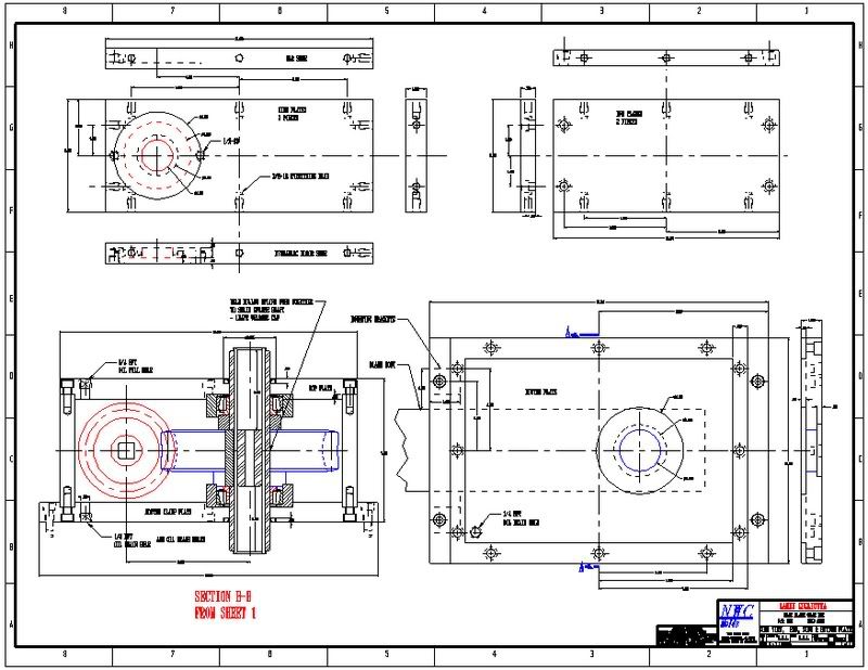

I am completely dumbfounded with the amount of work Rob has accomplished in such a short period of time. I think I got a pretty good deal for 9 minuets of my time to “repair” Rob’s tractor wouldn’t you say?
So now were up to date on this project – So what do you think so far?
Larry
