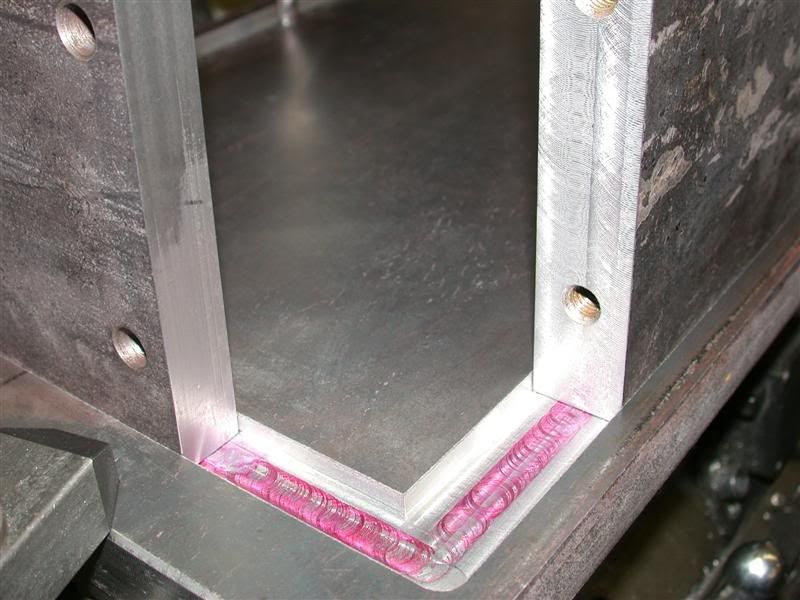

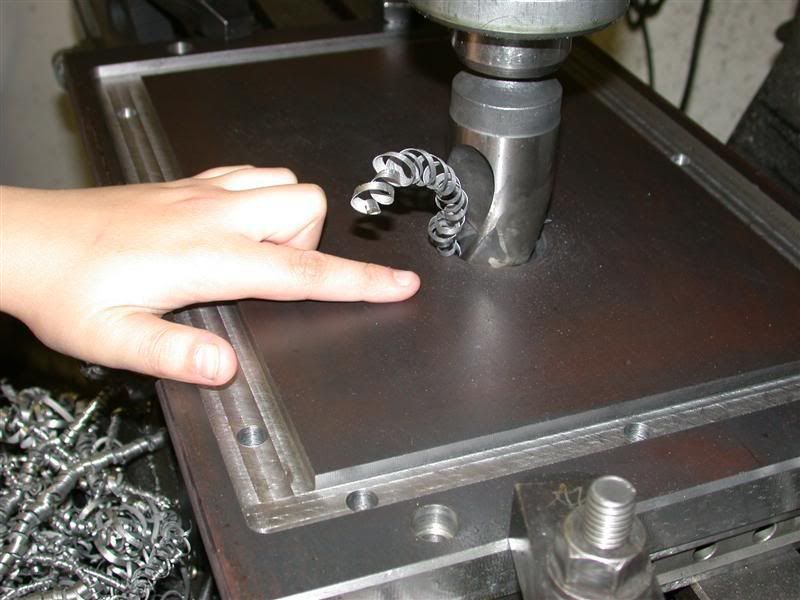

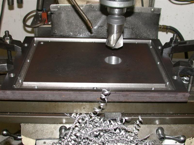

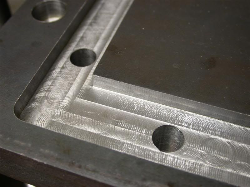

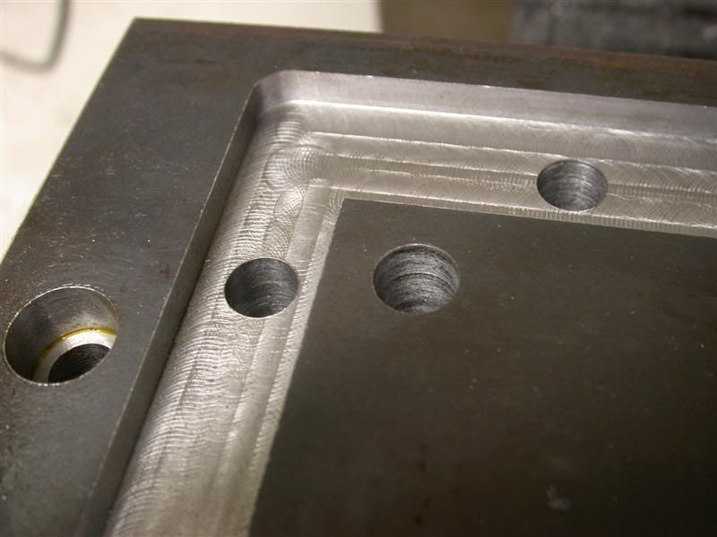

After all that, I took the collars and clamped them into the bored holes in the plates. They are also a slight press fit. I was thinking of heli-arc welding them in place but may not need to do that? So I stamped the plates and the collars to identify which one goes where in case Larry ever takes it apart, he will know where every single component goes. Unless I weld them in place of course. But I had to tap them with a mallet to get them to seat while clamped like this.
So to make a short story long, here are the top and bottom plates, complete 100% finished. The thrust bearings and hollow splines are in them too.
Stay tuned for what happens next ... uh ... I have to figure out what's next? Probably the side plates.

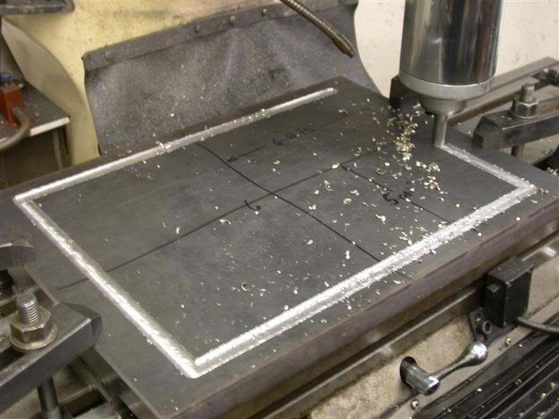

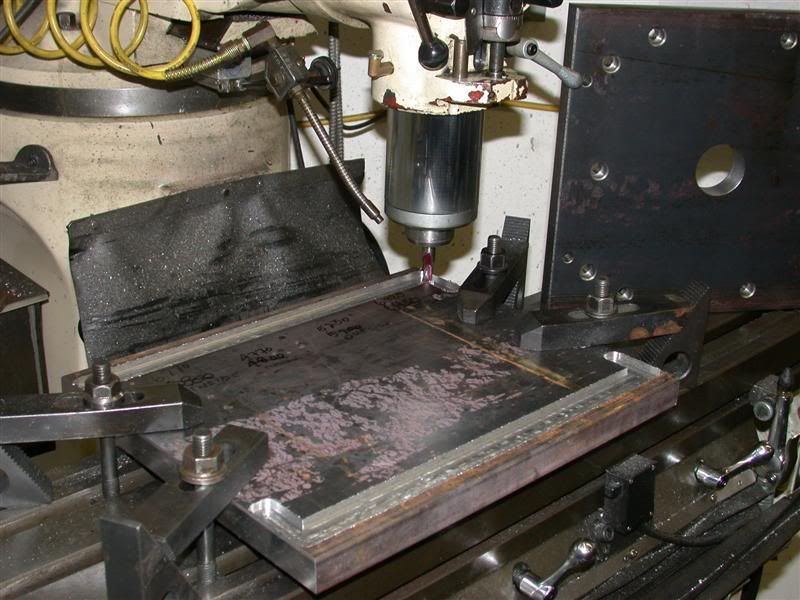

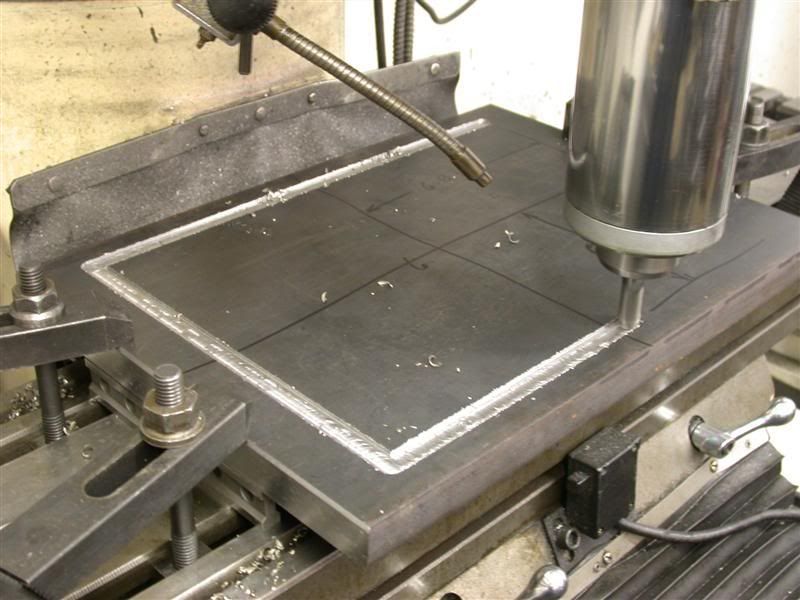

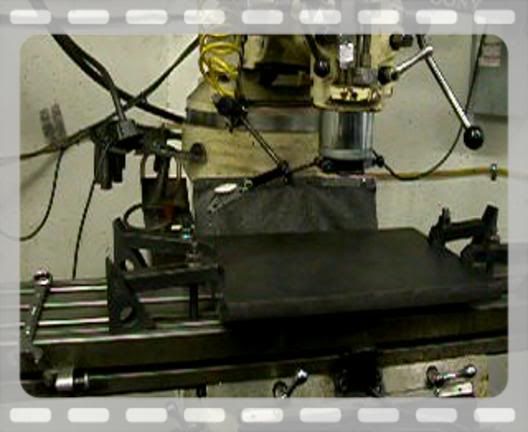

I have more photos of the side plates that will hold the hydraulic motor and worm itself. You've seen the roughing cuts I made on the other plates and this is more of the same. Here I'm taking ½ the width of the rough mill at .250" deep. This roughing rotary milling goes real slow.
Exactly how slow? Well, this video shows how I have to hand-over-hand move the rotary table dial to feed the roughing end mill. I'm taking the full width of the cutter this time. The cutter is buried .250" deep and going 170 rpm. I don't know if you can see or not, but during this (approx 1 minute) video, the table rotated 12°. That means at this rate in order to do one revolution, it takes me 30 minutes of handle turning like that for each pass I make.
So roughing on the rotary table is a PITA but you have to do it not to lose control or knock your work piece out of location due to shock....hold on to that handle tightly and move it at a consistant pace.
Now this video shows finishing the bottom cut. This is a 2 flute solid carbide endmill spinning at 1200 rpm and taking only .010" finish pass. Now you have to kick butt turning the rotary table. I"m getting a good workout on Larry's project.

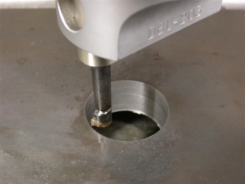

I added some "O" rings to seal the SHCS that hold the hydraulic motor onto the side plate. I had to drill and tap deep enough to hold the motor on and oil could get through the screw threads so now they're sealed too.
You can see the "O" ring in the front and the groove on the far one around the tapped threads. They are 1/2-13 threads, not 3/8-11 threads.
Here is the oil seal for the worm shaft getting ready to be pressed into place. that counter bore, BTW, is for the locating diameter on the face of the hydraulic motor. It ensures proper line up for mounting the motor instead of just bolting it flat to the plate. Everything will be in line perfectly and can't get out of position.
You can see the oil seal completely pressed in all the way here. I thought I'd show a close up of how the "sealer paint" on the outside of it is supposed to "melt" when the oil seal is pressed in and seal around the metal case. That's what Larry told me. Here you can see some of it on the side walls. There is is green trace of it.

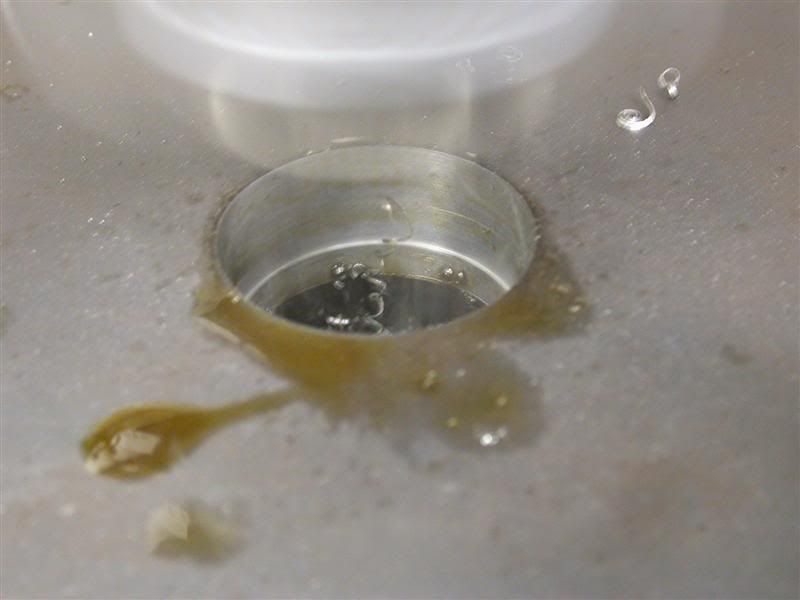

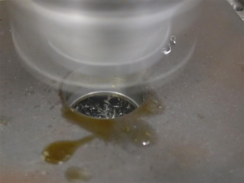

Here is the plug I had to make for the hole I drilled all the way through the second side plate. It is "O" ringed so no leaks.
I turned it on the lathe and made the part in front of the "O" ring .001" smaller than the bore and the part behind .001" bigger for a press fit. Then sawed it off while still in the "V" block and pressed it into the plate.
   / 360* Rotating Back Blade Project #65

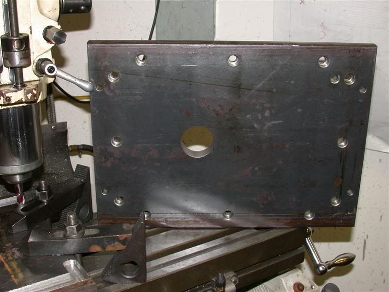

Here it is pressed into the plate and set in my vise to mill down.
Now it is milled flat with the pocket and good to go....no more "free lightening hole". ;D

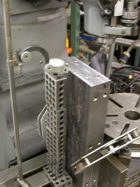

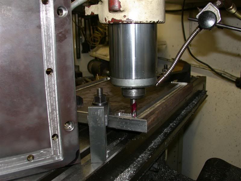

After the hole was plugged, it was time for milling on the round corners on the 2 end pieces so they would clear the outside radius left by the end mill in the pockets. I have a set of "corner rounding end mills" that I use for this. They are for machining clearances. Really accurate radii I would grind on the steel using the surface grinder.
After doing that, I realized I could now bolt the box together so I did and what do you know....everything fit perfectly. :confused:

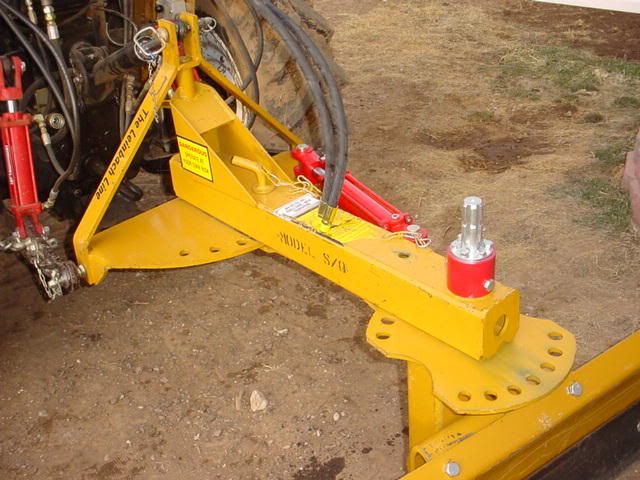

Is the gear box going to be full of oil? How do you fill it and how full do you keep it? Regular 90 weight gear oil?
About 7/8 full of 85-90 W gear oil. I think the calculations are about 10 quarts total internal volume, minus the displaced volume of the gears, shafts, bearings and thrust washers so somewhere in the neighborhood of ~ 6 quarts. Rob put a filler and drain hole in the top & bottom plates for me.
Now that you have the gear box done, I'm very interested in how it will turn the blade and how it will be controlled.
In the video where you see Rob rotating the gears by hand - There will be a hydraulic motor. I already have the control valve & hoses on my tractor ready to go. Take another look at the center shaft of the worm gear, there is a hollow 6 spline PTO shaft coupler that is going to be connected to the blade pivot shaft. Here is a pic of the blade and the PTO shaft that the Gear Box will couple to so it can turn the blade 360*. It's a slip fit between a hollow PTO coupler onto a 6 spline PTO shaft.
Just envision the gearbox sitting on top of the back blade then sliding over that coupler you see on the pivot point:
