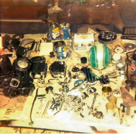

How in the world did you keep track of where all the parts went when reassembling? Did you take photos when you took it apart?

</font><font color="blue" class="small">( How in the world did you keep track of where all the parts went when reassembling? Did you take photos when you took it apart? )</font>
In my younger years it was all done by memory. The picture shows a Harley Panhead engine stripped before reassembly. And yes it did run after it was put back together. /forums/images/graemlins/grin.gif
Now that I'm a little older I tend to rely more on digital pictures and notes scribbled on pieces of paper when I see something a bit more tricky.

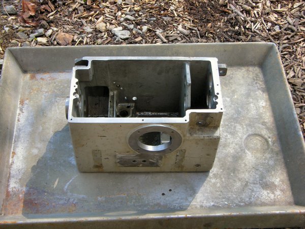

While I'm waiting for a couple of bearings to come in for the headstock I decided to turn my attention toward the gearbox. Here's a before shot sitting on the workbench.

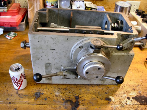

Here's that gearbox now minus all the gears sitting in the lathe chip-pan waiting to be hit with paint remover to loosen the 4 plus coats of accumulated paint.

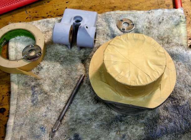

Learned a long time ago to take the time to tape off areas where you don't want or need paint like bearing surfaces.
It may take an extra 15 or 20 minutes per piece to tape but it normally takes 3 times longer to clean the paint off if you don't tape.
