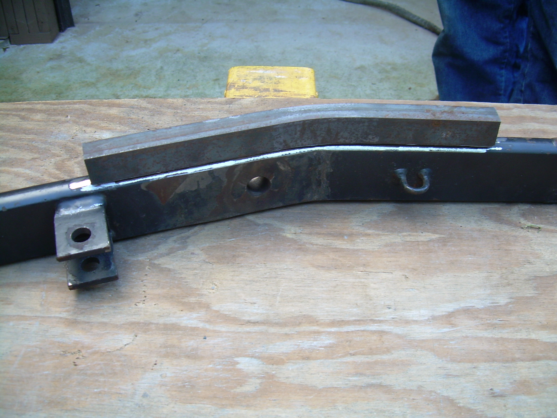

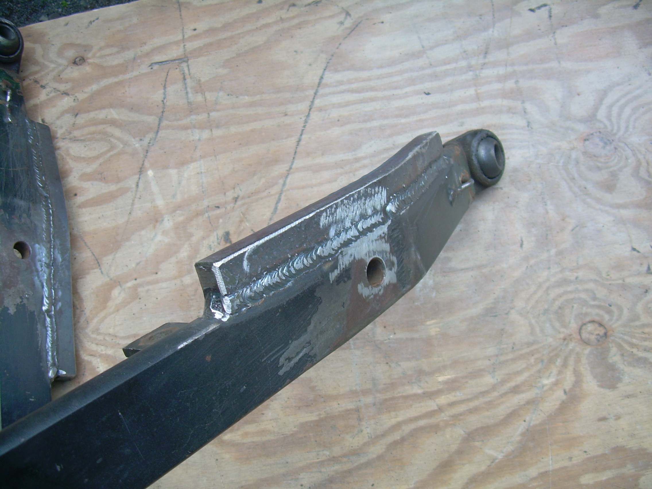

I know it's a tight area to weld but I did have to reinforce mine right at the lift link area, the bottom side is available to reinforce without any clearance issues. I put a 1 inch bar under mine but you could put a 2 inch or bigger to hold yours back together, might not look pretty but would be stronger than original. There's a few other tricks you can do to repair, almost any thought out repair is gonna be stronger than original, obviously original ain't all that great.

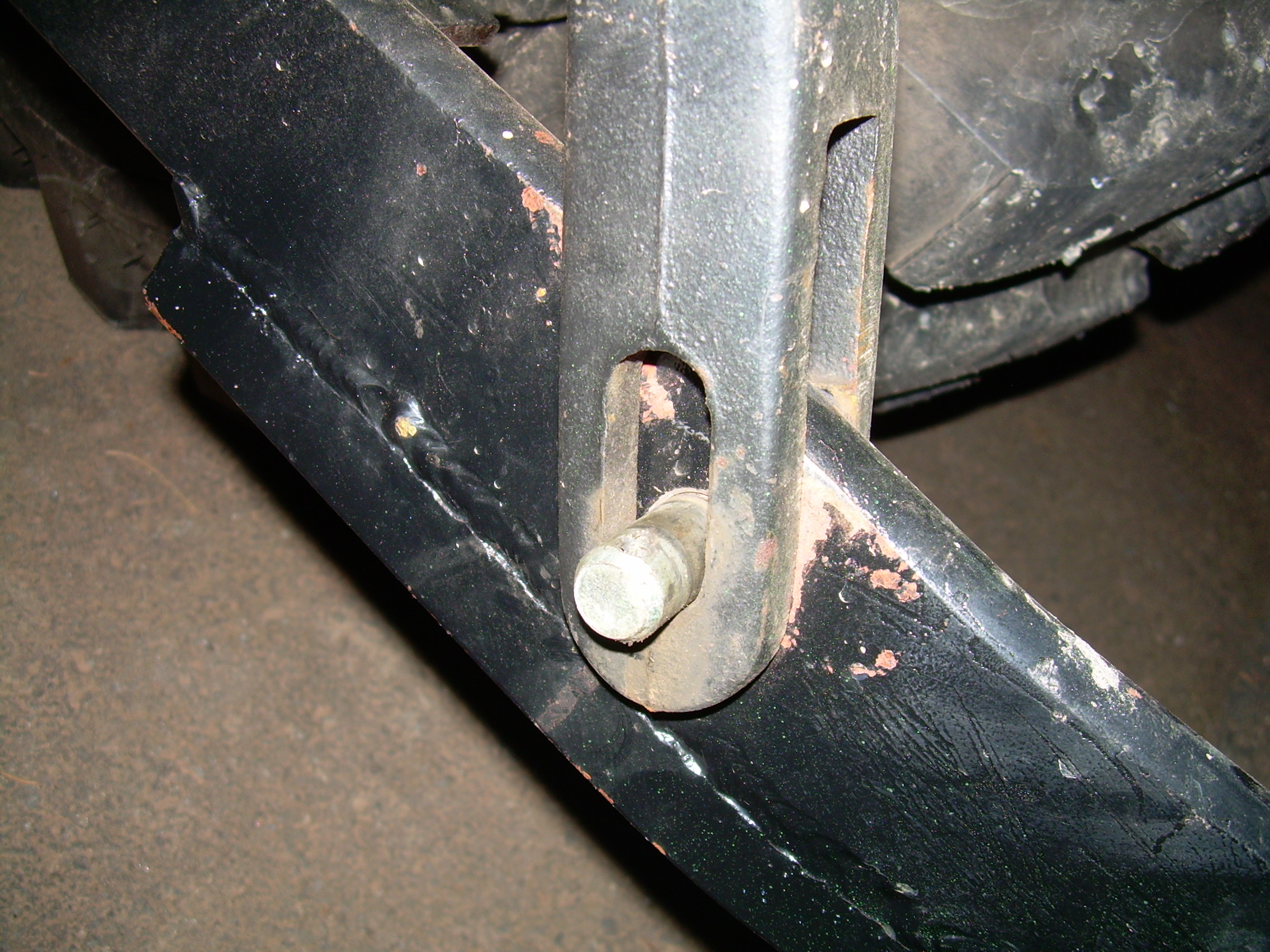

How did it break clean? and when you say you were 40 miles from home, do you mean you were going over the road with the splitter in tow? or was the tractor on a trailer?
