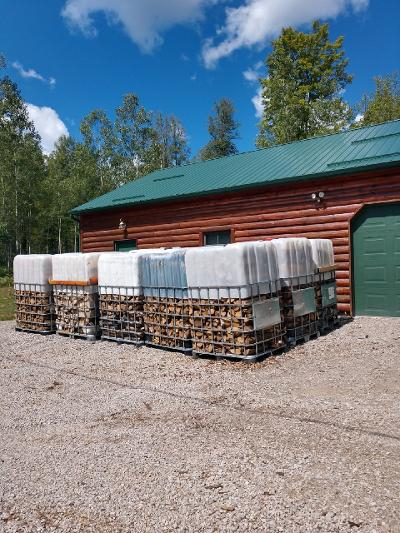

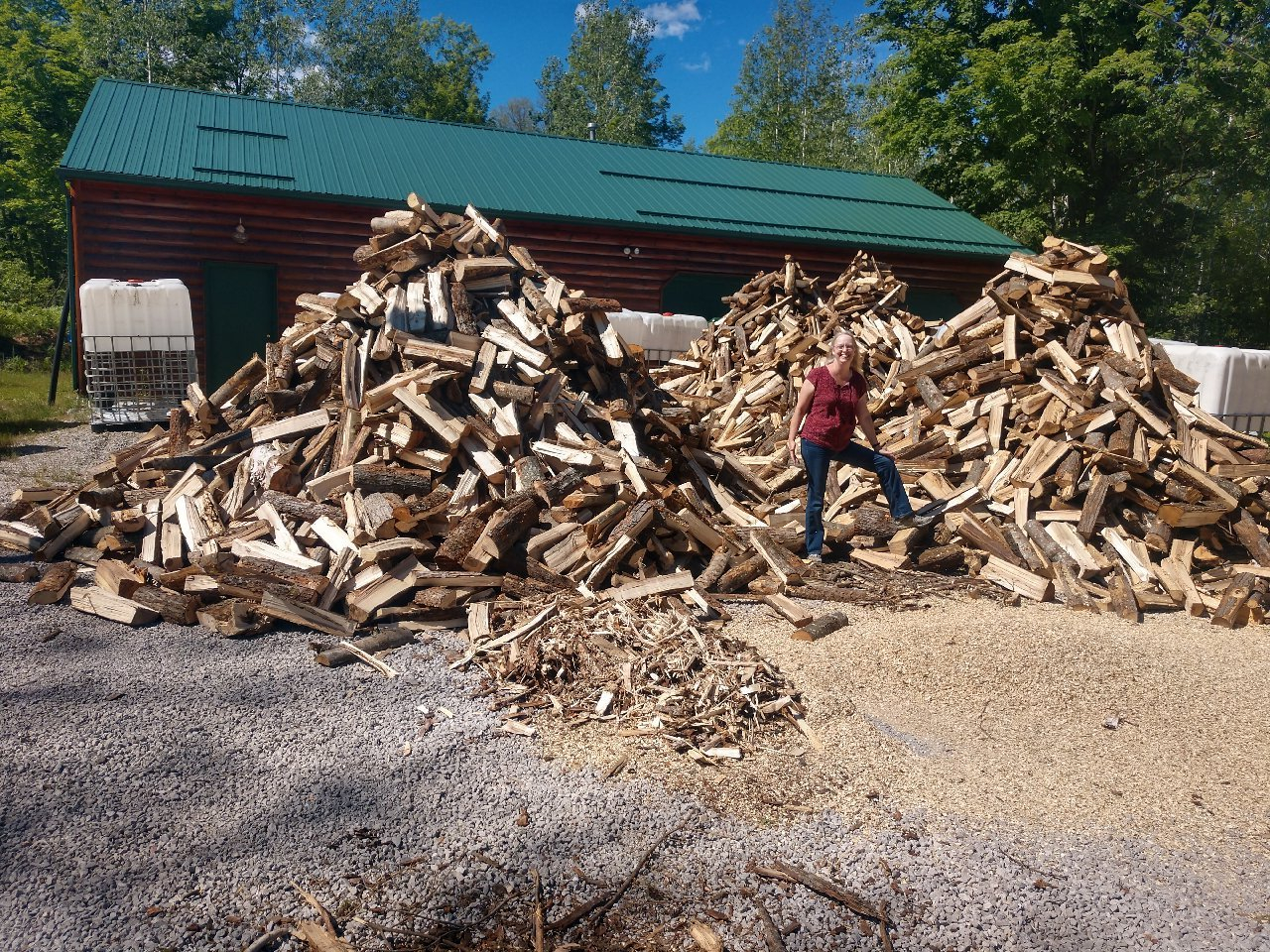

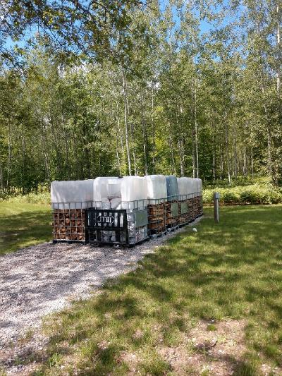

I am not surprised at all. Processing firewood is not like a math problem with one right answer.
The needs of a two cord user are different than a 10 cord user. Someone who buys logs does not have to deal with large rounds or gnarly wood to split. Some folks split wood in the woods and others take rounds or logs near where the firewood will be stacked. Some people enjoy the work and speed is not a prime factor, while others view it as a chore to be done as efficiently as possible. Some work alone and some with a partner.
Look at the post by ptsg. He uses his splitter three times a year, yet mentions fuel efficiency as an important criteria. But fuel cost is not am important consideration for Americans splitting a handful of cords a year. ptsg is likely paying three times our cost in Portugal.
No...one size does not fit all.
I no longer need a splitter as I have a better way that works for us and our meets needs. It takes a day to process 6-8 cords depending on the logs I get and that is enough for a years supply. It costs me $250 to process a year of firewood....no saw, no splitter, no space to store equipment and no maintenance. Here is 15 hours of production by the two of us:
If I could not rent a processor, I would get a decent electric splitter like the one I posted a link to earlier in this thread. There is plenty of power from the building shown in the background. Might order a unit that runs on 230V so my friends could not borrow it...LOL
