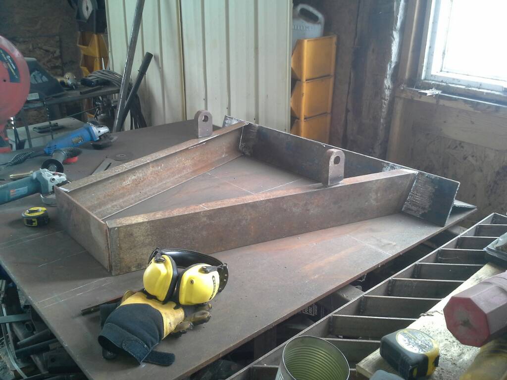

As I hope to add a winch to this in the future, it will be built with that in mind, not just as a grapple. Started off with a 42" length of 8" wide flange I beam and cut one flange off to make the blade/anchor
5" heavy channel I had laying around to make the 36" 'verticals' and a piece of 3.5 x 5" angle iron salvaged from an old brick lintel to cap the top. Width of the 'verticals' at the base plate is 32" and 12" at the top. This is laying face down on my bench to check alignment of everything and keep it flat. I still have to notch the top of the channel to allow flush mount of the angle top piece. That 12" top should allow me to bolt on a hyd winch up there similar to how Rusty did his if I ever find one suitable. Pins are being set 16" above the bottom which should allow for 8" below grade for winching anchor and still get 12" of clearance fully raised without factoring in adjusting the hyd top link. I'll get this all tacked together and mount it to double check everything before I fully burn in the welds.

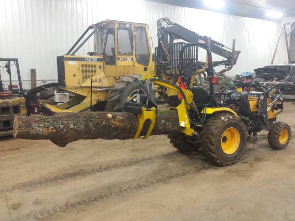

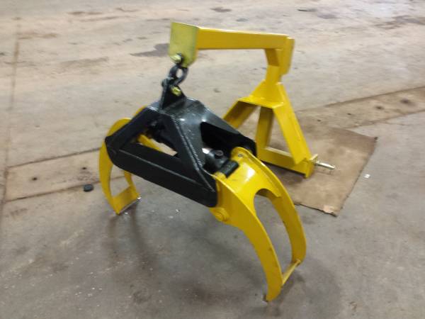

Maybe not useful to your post, but they are selling these for $2,100 on Craigslist in WI.
