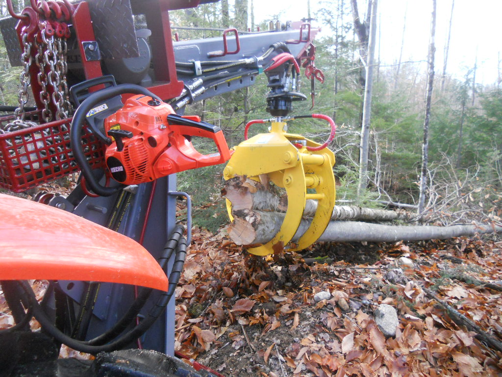

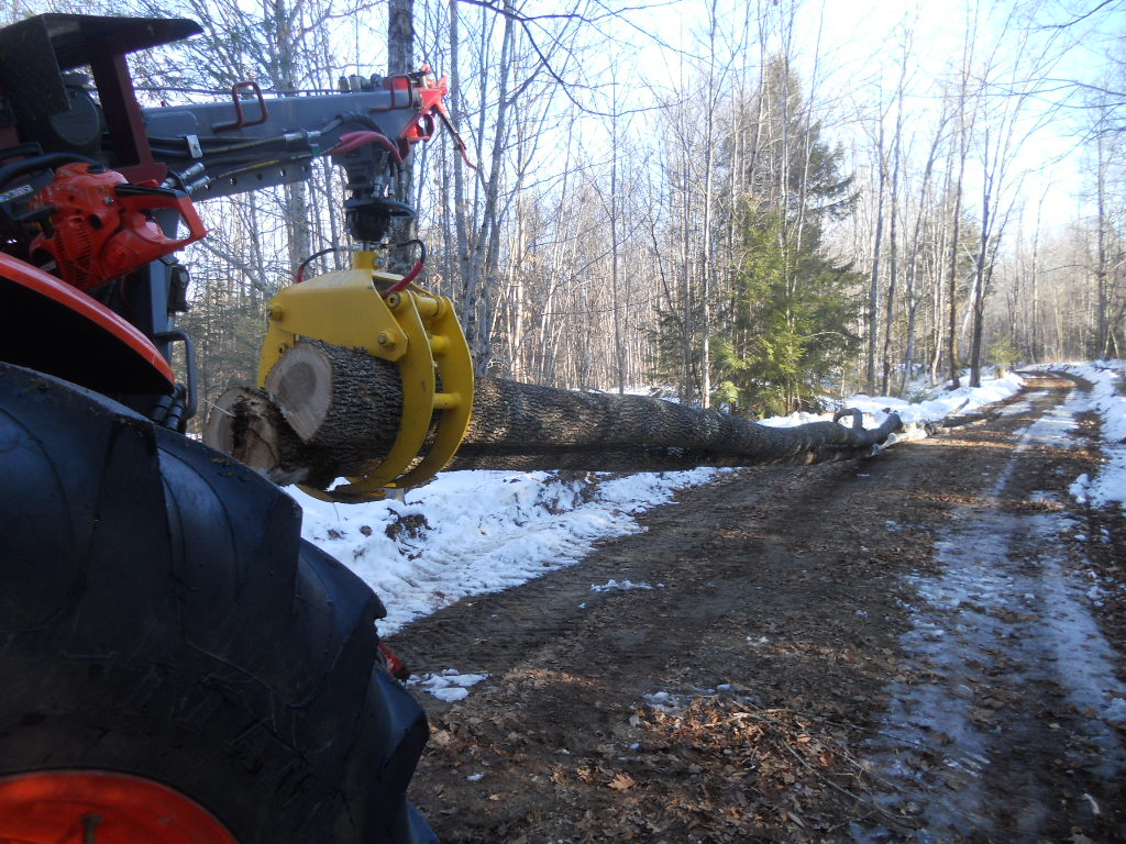

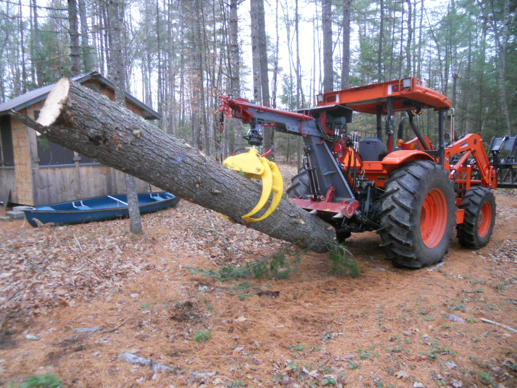

I don't have any videos but a winch is a winch, the grapple is the fun part. I have 711 ac. of woods with a couple of miles of various degree (condition) of roads. I don't like to drag on the better roads unless it's frozen. The grapple and the way the winch is built allow me to have the butt end in the air 'bout 4-6' depending on if it's in grapple or on the chokers, saving my roads. Depending on the log, I can haul it off the ground completely. Big one's need to be shorter, but smaller one's can be 30' long. That big pine log needed to come down, it was hit by lightning and I didn't want the wood to go to waste, but all of my regular cutting is just thinning for firewood. No big "sticks" like Rob hauls. DSCN7667.JPGDSCN7795.JPG

I've seen those pics. This is 2016 and we want action videos! :D
What kind of line speed are you getting out of your winch?

CNDfarm looked the winch up at just under a foot per second at rated flow on the first wrap. I'm happy at an idle or a little above on my tractor. It seems like half the time I'm yanking out hang-ups, or dodging stumps, rocks because I'm thinning. I just like making things that work, I sure as heck don't save any or much money:laughing: I never really added things up, but I can think of close to $5k in components and hoses real quick! Nothing for my time, welding wire, grinding wheels, etc.:confused2: The grapple & rotator and related diverter valves & hoses was well over half of that, but it's pretty cool to grab it, drag it, & drop it from the tractor seat.
