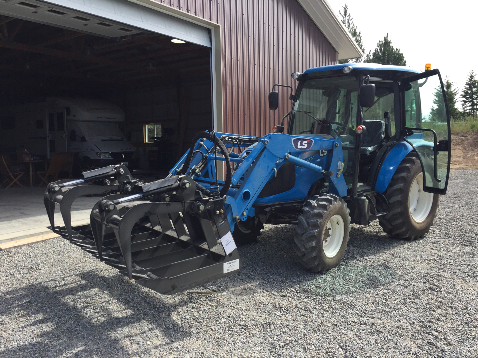

As I mentioned in an earlier post I have a 2017 LS XR4155HC and am very happy with it. I shopped every brand in the 40-60hp range for over a year. I thought I had settled on a Yanmar YT359 but couldn’t get the price down below my pain point-LS had been running a close second (and actually won the ‘bang for the buck’ category running away).
Standard features-wise the XR is hard to beat-3 rear remotes standard, remote 3 point control, adjustable lower links, telescopic stabilizer links,Cat II 3 pt. Mine was optioned with everything but the mid PTO and I added top&tilt, 3rd function and filled tires. Image1544709286.744022.jpg.
I have equipped it with a Titan grapple, pallet forks, rake, rear blade, 7’ Ford 917 flail, and a 3pt hydraulic auger in the last year or so.
Very useful and easy to drive machine-wife loves it. At about 50 hours now-expecting 1st Regen cycle soon and will do 50 hour service after the winter ends.
