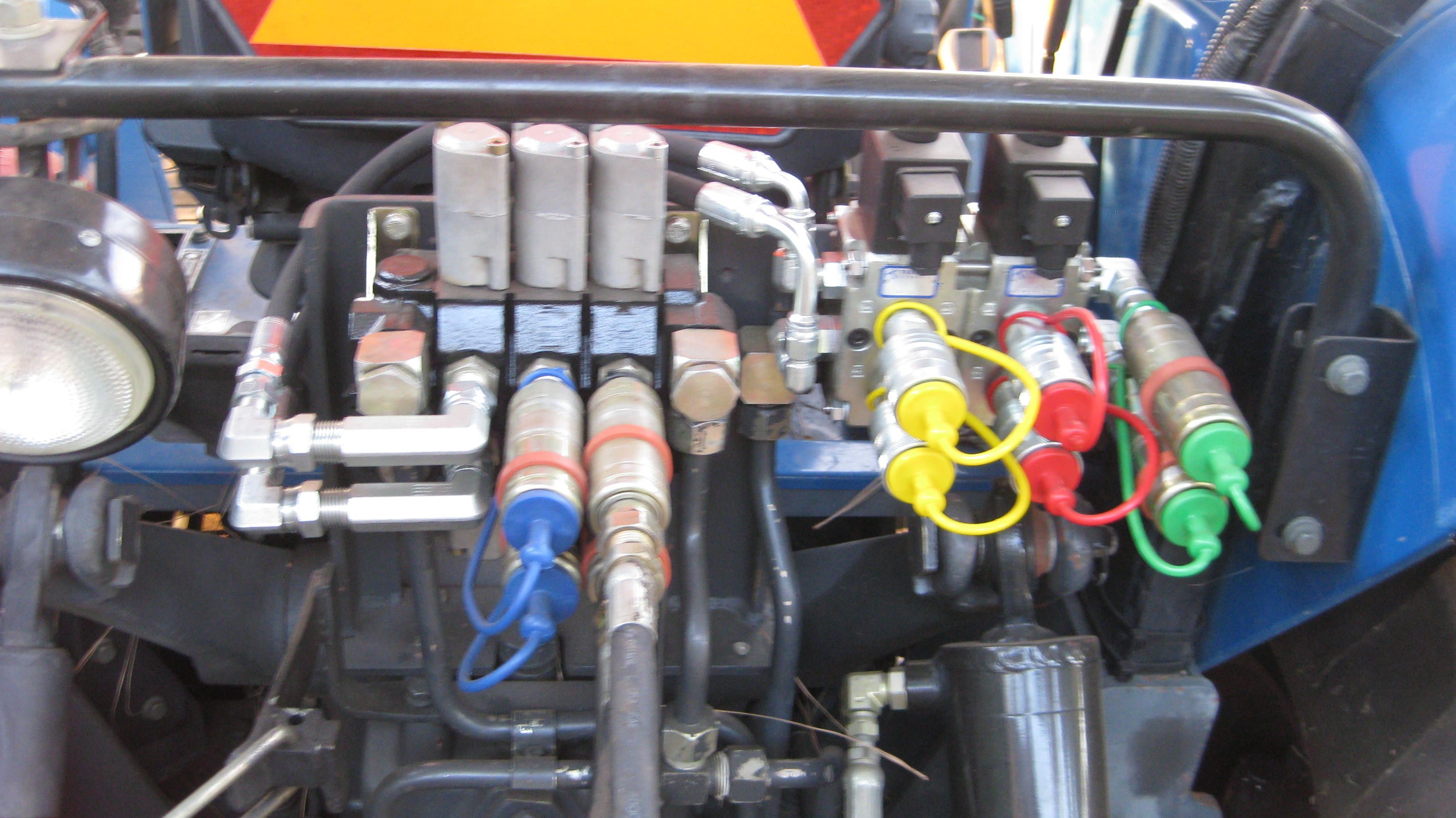

Depending on what tractor you end up going with, but if they have a choice on types of rear remote valves, get valves that have the float feature, at least 2 of them for the top & tilt set and again get every rear remote that they offer. Remember that the rear blade is going to need 2 just for it and then the 2 for the top & tilt units. When they don't offer the 4 that will be required, there are ways around that, so it's not that big of a deal to get the additional rear remotes that will be needed.

Here is my 75hp tractor with 3 factory valves and a double diverter valve set so that I have 5 total.
The Kubota picture has the 3 factory rear remotes with a single diverter added. He has my T&T set and my cylinders on his RBT3596 as well as my diverter to get him the 4 sets of rear remotes that he needed. There are several ways to mount the valves, really just depends on each tractor and how they are laid out.
As far as having us check your order before actually ordering, it's really just to see if you forgot anything that should be ordered with the original order. ;)
