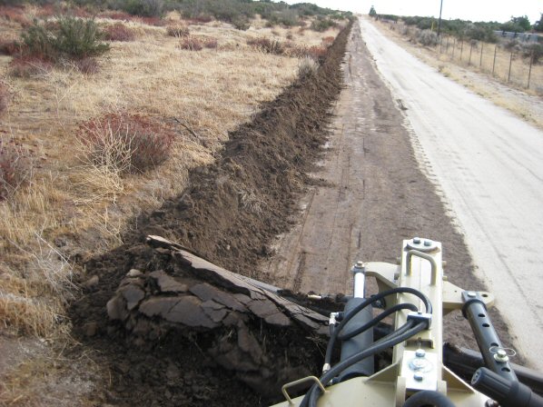

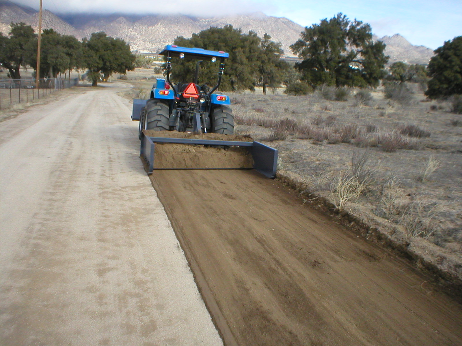

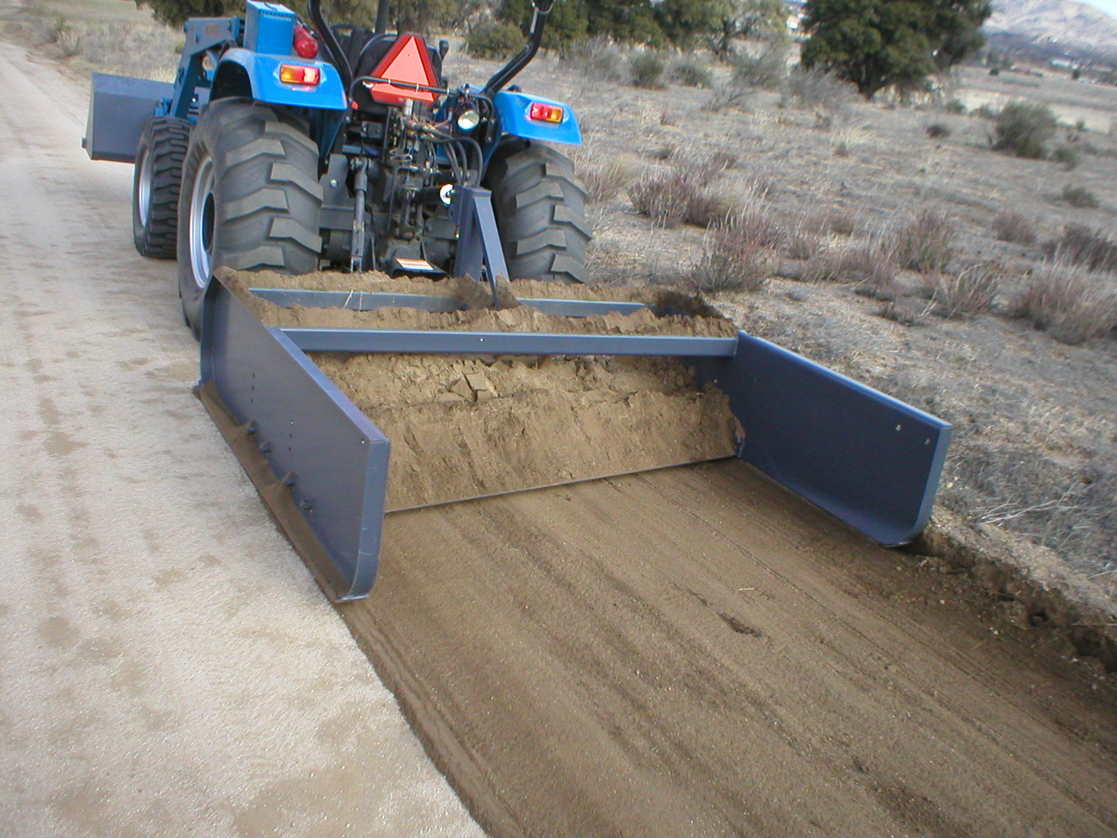

Pugemasta - Look at the pics that MtViewRanch has posted showing his driveway and how the LPGS works. When you have a driveway that is topped with all gravel - the LPGS will do a GREAT job. When you have a driveway such as mine - exposed bedrock and house sized boulders - the LPGS doesn't really do so really well.
I use my LPGS mostly out and about on the property to create new trails and upkeep on existing ones.
I have found the my hydraulic top link from Brian @ MtViewRanch works wonders on all my land engagement implements - even when hooking up my Wally chipper.
So - I use my big 'ol Rhino 950 rear blade almost exclusively to maintain my mile long gravel driveway. After going thru the process of getting the top link set just right - this means - stop, twist, go 50', stop, twist, go 50 feet etc, etc, etc. Finally you end up saying - "Well, that's good enough".
With the hydraulic top link - motor along - a slight touch of the hydraulic control - how does it look - another touch of the hydraulic control - check again. All this while you are still sitting on the tractor and the tractor is still motoring along. Its so darn easy to make adjustments and you continue until it is set perfectly. Once I got the unit - it really upset me that I didn't get it a whole lot sooner.
A note of caution - the Rhino 950 - 8 foot - 1100 pounds is bigger than Kubota recommends for my M6040. They recommend a max of 7 foot width and 1200 pounds. You can't win for loosing in this case. And strangely this mis-match is prevalent thru all the implement size/weight matches that Kubota recommends. There isn't a 7 foot rear blade that can be offset sufficiently for me to safely maintain the ditches on my driveway. A 7 foot blade will simply put the tractor too close to the edge in many areas and I don't relish getting that close - especially when the driveway is icy and I'm plowing snow.
So - bottom line. Take a long look at what the manufacturer recommends for implements in the Owners Manual for any tractor you are considering. You CAN get too big an implement and cause damage to the 3-point.

Thanks Brian! Appreciate the photos, very helpful for me. Sounds like I should consider a grading scraper as well when I buy the tractor, the road is (mostly) gravel. May skip the landscape rake for now and see how it goes. I'll need to read the gravel road manual Egon shared as well. Wish I was shopping for a fleet like yours :D I know where to go for an aftermarket T&T kit.
Thanks Oosik, I will need to give some more thought to blade length after selecting a tractor. You make a good argument for getting a blade on the larger end. I don't like the idea of getting any closer to the edge of my road than needed, particularly in winter. I will probably stay within the recommended range of the manufacturer, just to be conservative.
   / 40 Acres, Steep!, 1 Mile Road; Need Advice #104
Forgot to mention, most of my roads are all DG, same material that you have to deal with. If the road it built properly, even with only DG, no imported material, (rocks and 3/4" gravel, it will stay in pretty good shape. Mine does, but then I have no where the amount of foul weather that you have.
oosik, remember when you had your smaller rear blade, it was simply to light to work for your road other than for snow. Do you think that the same thing would apply for your LPGS? Your LPGS is 8' wide and weighs less than 1000lbs, what if you had one that was 1400-1500lbs? Would that make a difference, or still just not enough weight? :confused3: Not that you need it since you have the heavy rear blade now.
Just curious what your thoughts are on that. ;)
