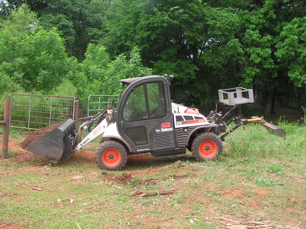

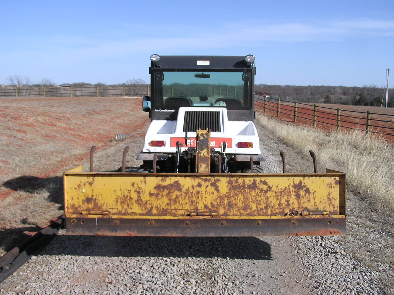

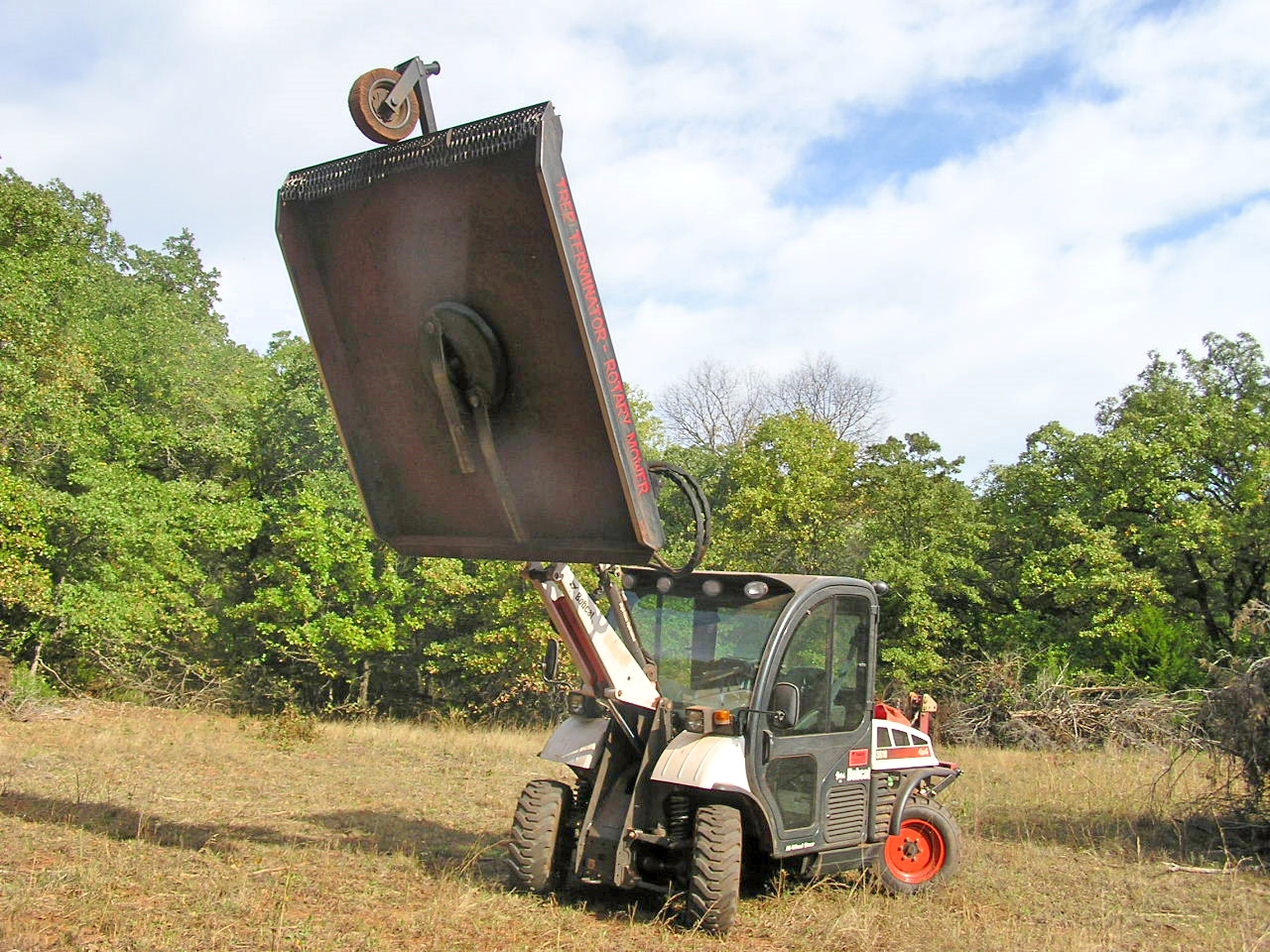

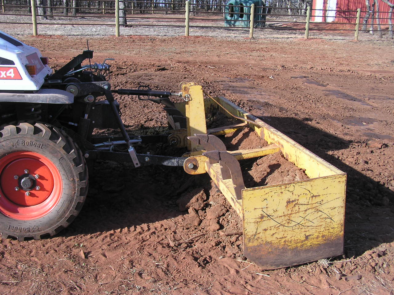

Since you are looking at other options, check out a Toolcat. It is very popular with commercial snow removal operators:
Low center of gravity, here is our 5610 on a 27 degree side hill, the hanging chain shows true vertical:
Digging and hauling dirt with a 6', 1 cubic yard bucket:
The 8' box blade:
The 6' box blade on the front:
The 8' brush hog:

Toolcat looks awesome, but low PTO hp is deterring me. Agreed, very cool photos.
What do you need more PTO hp for?
I only used ours on one project, borrowed the neighbors post hole digger.
I would rent a skid steer post hole digger if I needed to do a lot of posts.

Faxman, I suppose you are right as the limited PTO hp wouldn't matter as the toolcat snowblower would be hydraulic. It is out of budget though at 50k or so by my account. How would a toolcat do at road maintenance?
