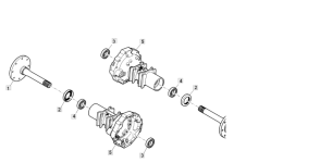

Tractor is still at dealership. Now there telling me its not covered under warranty!!!! The dealer said it was covered under powertrain warranty!! The NIGHTMARE Continues!!!
/ 4044m NIGHTMARE! #67
I would have thought, any such cavity has vents to allow for pressure changes. That makes not a lick of sense.
Makes perfect sense. Axle seals are sensitive to fluid level. Very sensitive.
/ 4044m NIGHTMARE! #68
I don't think any color would warranty a leaking seal at 3yrs/400hrs.
I'll ask the unanswered question. Was the fluid level properly checked?
No logical reason for both seals to start leaking at the same time unless caused by a sudden change.
If the delay was costing me income I would have ran it and daily checked fluid and add as necessary. The fluid level should be right at the bottom of the axle bearing.
/ 4044m NIGHTMARE!
#69
Tractor has been religiously maintained! It was always pressure washed, foam cannoned, and waxed every time it was used. Always did fluid checks and oil changes before scheduled maintenance before manual stated times. Always greased all fittings regularly. Never really did any kind of strenuous work with it.
/ 4044m NIGHTMARE! #70
Pressure washed to get all the dirt off the axles????
One of the worst things for seals can be a pressure washer.
/ 4044m NIGHTMARE!
#71
What makes me mad is my dealership said the axle seal was under powertrain warranty before they picked it up. Now that they have the tractor in the shop its a different story.
/ 4044m NIGHTMARE! #72
Hope it works out for ya.
/ 4044m NIGHTMARE!
#73
Well dealer just called and said both rear axle shafts needs to be replaced because there is grooving in the axle shaft
/ 4044m NIGHTMARE!
#74
Do you think this could be an over torqueing issue when it was at the factory?
/ 4044m NIGHTMARE! #75
No.
Seems to be a compatibility issue between axle material and seal material. No way the proper seal could wear a groove in a steel axle in 400 hours.
/ 4044m NIGHTMARE! #76
Those axles would have been butter soft and not able to support the weight of the tractor. If it had constant contact with some very abrasive material, maybe. But that probaably would have destroyed the seal long before the shaft.
Is it possible for the plastic of the seal to desintegrate and only the sping (in some oil seals) to be contacting the shaft? That might create a very slight grove. As it was leaking, that would even lessen any possible damage though.
/ 4044m NIGHTMARE!
#77
I think next tractor will be a yanmar yt359c. They have a 10yr 3000hr powertrain warranty, that's saying something about there product!
/ 4044m NIGHTMARE! #78
YANMAR is number one in my books. But you can have all the warranty in the world and it's worthless unless it's honoured and applied effectively.
/ 4044m NIGHTMARE!
#79
Like this tool they been looking for they are blaming it on the pandemic. Its not like the 4 series is a brand new model tractor, its been around since 2014. No reason not to have all the tools and parts to make a repair!
/ 4044m NIGHTMARE! #80
Most soaps are very alkaline and when used with a pressure washer, they can be forced into the seals. That can lead to corrosion in the seal/bearing area. If this repair is not warranty, the old parts are yours. I'm sure we all would be interested to see pictures of the "worn" parts.
