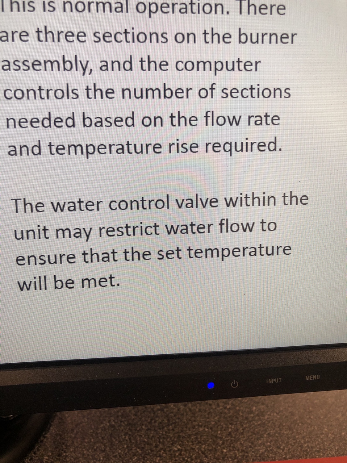

Builder called in some heating and cooling guys today to address the problem. Propane checked out ok, as well as the pump. Called the heater manufacturer and they think it is a faulty control panel and/or the water restriction valve. Overnighting both parts, but heating and cooling guys can’t get installed until Thursday. Luckily it’s maintaining 60° in the building right now. Neither the heater or pump have kicked off since Sat afternoon, but at least it’s maintaining.

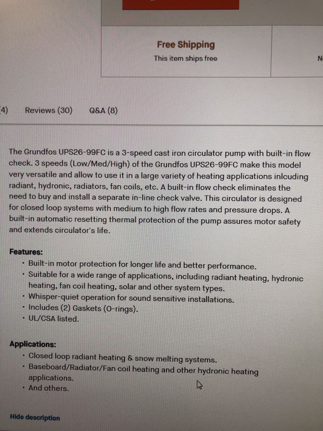

Hmmm, that logic doesn't work on me. You have low flows. How would the control board in the heater affect that? Possibly the restriction valve (though I am not sure what that does other than the obvious name...). Low flow comes from one of 2 things: pump not pumping well enough or restriction (like debris,clogged filter or that mixing valve acting up). I still suspect the mixing valve and think it should be removed, but they don't seem to agree with that. I guess we will find out... Keep us posted!

So I did some reading on both the heater and the pump today. I at least understand why he thought it was a propane issue after reading it. I had no idea the heater was “smart” enough to restrict the flow to maintain the temp. So I’m assuming they believe the control panel is commanding the valve shut, or the valve is defective and restricting the flow. And after reading on the pump, I understand why I think it’s not running as hard as it was. It’s not, because it doesn’t need to because of the restriction.
I agree that the mixing valve isn’t needed. I’m going to add a shut off valve to it as soon as we get it going again. My builder is trying to make it right with me, so I’m trying not to step on his toes as he does. He’s concerned, and has thanked me for my opinions, and I really appreciate that. Hopefully, the 1-800 line is correct and we will be up and going again Thurs.

Thanks to everyone that helped troubleshoot the issue. It's finally up and running again. Builder just called and said it was flowing 3.4 gpm currently. 2.8 was the highest I had ever seen when he started it. dstig1 you were all over it! Came down to a screen in the mixing valve being plugged with debris. He went ahead and removed the mixing valve from the system and all is good so far.
