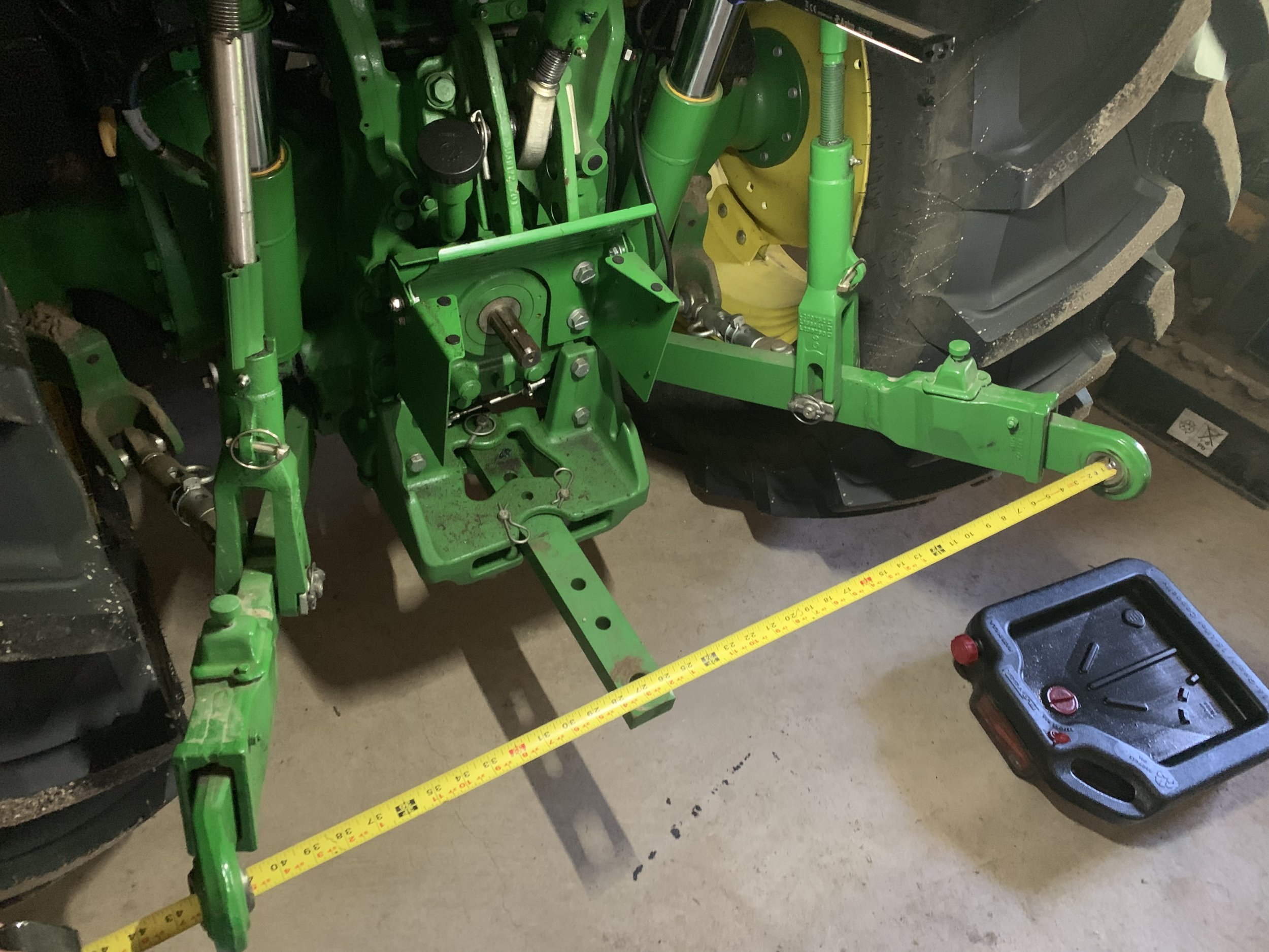

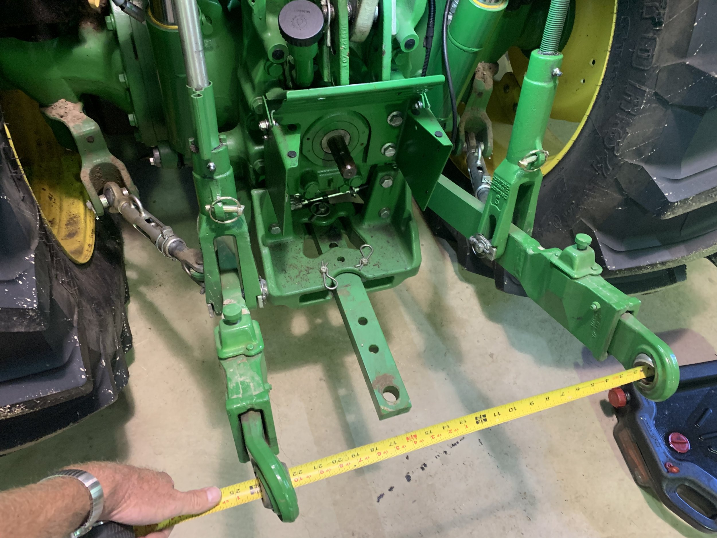

The stabilizers should just slide in and out
These ones don't, some stabilizers have multiple holes you can put the pin in, the purpose is to prevent sway, if you have it without the pin you might as well just disconnect it.
aRuHlDwQRnCLLvbv5zKtOCqKPG8VrvZ4HFVlpcR58S0IYL447rLJvF7cgTd9_iV061uFoMy_kYXvZmR47zUK9gIvt1cK1-OjAWMDtaGzEKqLNtYrAwxwxzih7Gs7WZMG7yKhMhUnHpiUpRPtulJq8HWEinFefsM0gVoqUuvNcEkDxriQ4WGjwl--0Lidre3cMrDuNXnY2wqp7VfevTEVprRSgDrkQsv8xd2cSdj85bd04516irm_M1asjYICyI79mrkuxR5fRg3FhzGBKnzvjEVq4Y5_-pc959b1gD5cc6y4PxWD6lkMzhrAbFxyG4QKGMMcoijmruZwNW2BxhbjrP8AeiH-ggBWf-PFpZDI-OOvjv1y8dGTC-BrRAVQJ4GiQLiFHj5gP7c13tDC3THIf0ObDVJYUc0023ENOWN4UjHVGdaMEaBq3N2n5msbDTptM6AmEcAR5lAuwxvFlc4X460uufzy6Rt3J8EQqDJVMZHPaU1qutBSOXKSrlj6wT5HdRH-cz21AoVEyWsZcWT2tZDuANhYs_4_IA0uHN3f_1B06j8C7r22YYNs3iG885M2xIk82cZwi1SDul28TXEB6iZX4nOhP0rAwYVoSd9iDVq5dAvOjnlqA7PGHZmNU0bagj6z0ENTOHoYFlVKqNCAxf_enI9qSzrVkxtAPYxLAG8BCEhGgtndwEPQ_Qby-Fen_zGiQj-k2DKtVs-PRChZoyXMeo1hrgDFgV-hdYcmkx858HlkHvPxbhphLS99O90=w753-h1337-no
MTRirSfHqCWogdDwPLW1_dwnxNqo6iMg1mralpjBn7QAprxcWOZC6K-M3D91fSArcQkG1amCMey12Yhn0IoBw1Rhl2gR8tfYvl_wWCymCL19ttAwQOPh_JpjR8lVb0qh0oJZzOxdEPDV3TNMYk04c73ACug3gdl4_qC0T26hm76PZXO-Zvzfyfm-_qFqvXZde7SYURj8i5b0wg2GDpraJsxmUs6vH18SLFZ3PfHgTiw_cMhLz4SNjgjgYOFc6VF88xk0tFuqpnqMP1gPGm-E6gDEgGXTCVMemcAICLBr8GC0qBxB2hZNIKqeTT7-Q9I5UIIO6ikEg9HhtfkylkmTK3v_9mk2exUQ1oVm-zNdPgMq5xkNZELEbleuwWb_Ll9GR2DNNdGTpUQz2l05lOz57HDIkM6tSj9xJN8CmkeKpV4puzIX7W6eOgGCt2cNkgddbR0s3ZvHWDhXHkzmLiWObU6xJimHF0R0u4hQUWK0UTl-Kn6PrhdaetWqthAC6-7P7g2xtM0xXlJghtsj1WG4mu9wv9Rbomba0X_u211fAub1Hj1xNyAalcooeP46UN_RF6NTb-JvzZmBIzER8JV_DyCiUoMPCzx_JoUbWil9_YK_Xka7uMpnoxPqXUSZ_UIZ0_1cpkOBXlz-3rmag5JGjAhzQcWxTHdzcygO1Q4ek0LiriOspZGaf0enxcOQjhLulo9G16y5f1gZY1A0YkujpxEX6uaruS6Ur9Q-Bsm4mihcIJYW69fPikyYLjUOhRk=w753-h1337-no
You can see when I put it up against the lower hitch arm (the cutter is currently attached with the sway bar disconnected) there is no way I would be able to reconnect that sway bar. The ball in the sway bar that connects to the tractor prevents it from getting the correct angle to attach back to the hitch arm.
cutter that says it fits a cat 2 system is where the problem is.
Exactly. It does not. I am contacting the manufacturer to see what recourse I have. I have been getting treated like absolute **** by companies recently and I'm sick of it. If nothing else Ill just return it.
That did clear things up. Thanks for the pictures.

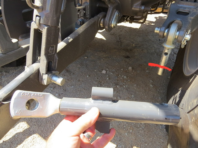

Those stabilizer bars that Massey-Ferguson uses on the 4707 have a useful range of motion that places the arms in Cat 3 widths. Any of my Cat2 3 pt tractors the stabilizer bar is at midstroke of its range when the arms are placed at Cat2 spec 32” between. If Massey-Ferguson does offer stabilizer bars that have a more useful Cat 2 range (narrower) that would be high on my list of installing. I would definitely want 2 stabilizer bars when operating that Bauma.
