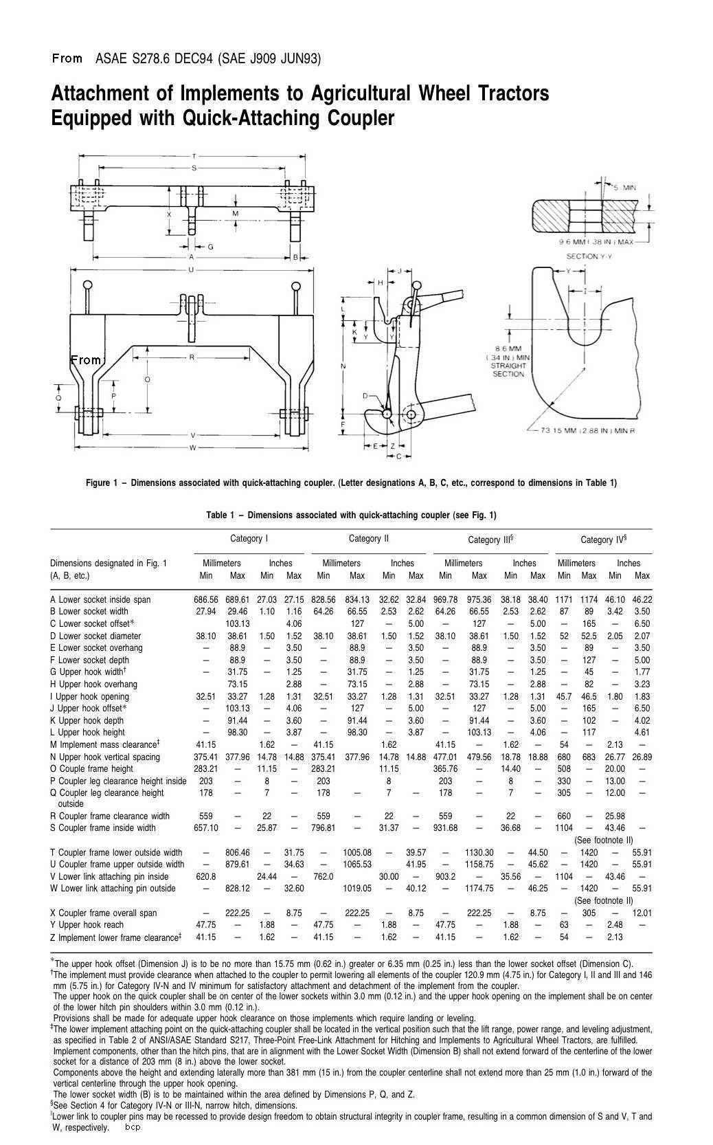

Hmm str8 6 go to 20” and the op’s only to about 30” . Something doesn’t add up. I would pull the pins in the top of the lift links where they attach to the rockshaft arms, check and make sure the pivot balls in the top of lift links are free to move. Lubricate them well and free them up if there corroded or painted stuck. I would also check the pivot balls in the arms where they attach to axle, all 4 of these pivot balls need to be completely free to swivel. If any of them are corroded or painted stuck it will cause your issue.
   / 4707 3 Point adjustment issues #25
So I guess next step is for OP to pull the pins on anti sway bars and see if lift arms will actually come in closer to fitting implement

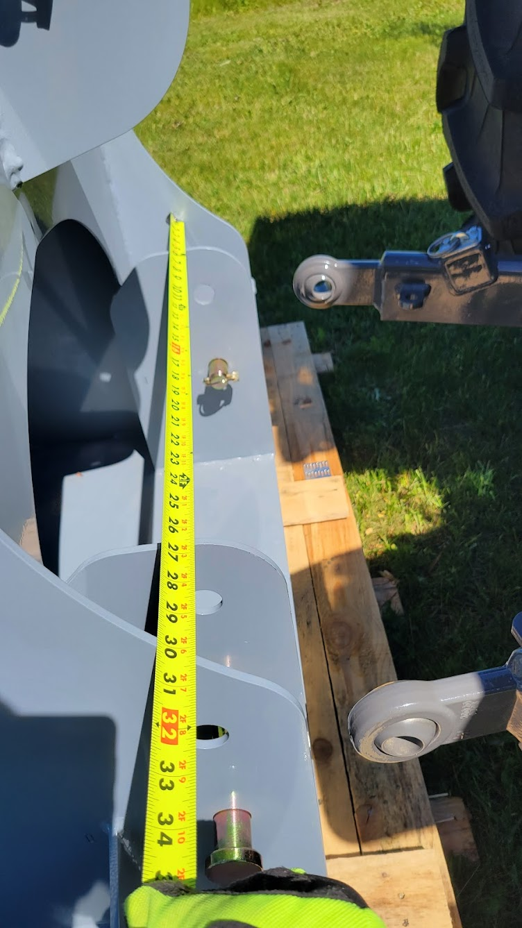

I'm contacting another owner of this same unit because I want to make sure its made correctly. Either way, this is simply NOT made to CAT 2 standards. Everything I've read online says 32 inches between the arms.
it's not the draw bar bracket stopping it, it's the sway bars limiting them.
Correct, the photos I uploaded don't really show it well unfortunately.
His narrow to 20" when he disconnects the sway bar, I can do this as well but it's not really an ideal solution. Isn't the point of making implements to a certain standard so that they will fit properly?
I did do this. I am able to attach it if I disconnect one of the sway bars. Honestly I don't really view this as a great solution..
   / 4707 3 Point adjustment issues #29
The stabilizers should just slide in and out. It's a telescopic design. The thread portion allows for fine tuning.
   / 4707 3 Point adjustment issues #30
The telescopic sway bars do slide in and out with the pins removed but they won't allow enough movement to get below 32" at the ball ends. It's a true cat 2 system and by those standards the tractor is exact. This isn't one of those 50hp or 60hp three points that's marketed as cat 1/2. Those would have no problem hooking up to that cutter. The cutter that says it fits a cat 2 system is where the problem is. I should have taken one of the sway bars apart to make sure it wasn't binding but it looks like it's just at the end of its travel and that's all it's got which is more than enough for a cat 2 system. You know, I have a 6' woods bush hog that's built just like the cutter mentioned in this post. I bet it won't fit this tractor.

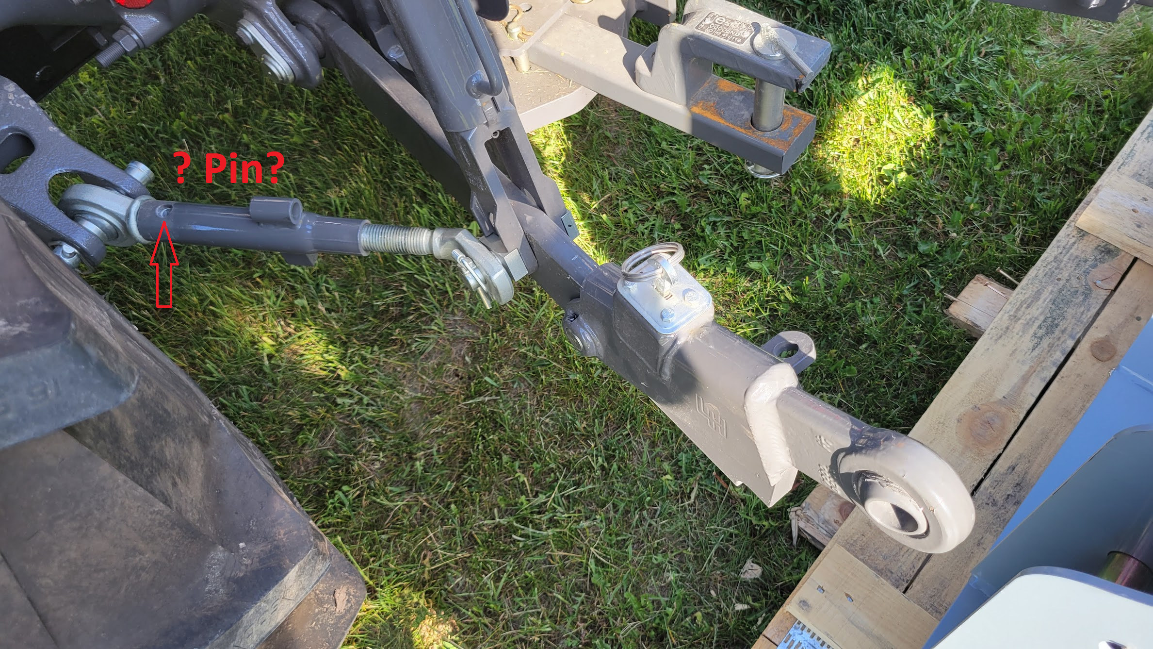

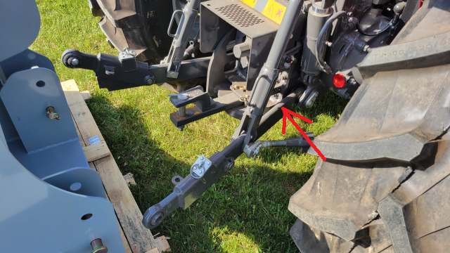

These ones don't, some stabilizers have multiple holes you can put the pin in, the purpose is to prevent sway, if you have it without the pin you might as well just disconnect it.
aRuHlDwQRnCLLvbv5zKtOCqKPG8VrvZ4HFVlpcR58S0IYL447rLJvF7cgTd9_iV061uFoMy_kYXvZmR47zUK9gIvt1cK1-OjAWMDtaGzEKqLNtYrAwxwxzih7Gs7WZMG7yKhMhUnHpiUpRPtulJq8HWEinFefsM0gVoqUuvNcEkDxriQ4WGjwl--0Lidre3cMrDuNXnY2wqp7VfevTEVprRSgDrkQsv8xd2cSdj85bd04516irm_M1asjYICyI79mrkuxR5fRg3FhzGBKnzvjEVq4Y5_-pc959b1gD5cc6y4PxWD6lkMzhrAbFxyG4QKGMMcoijmruZwNW2BxhbjrP8AeiH-ggBWf-PFpZDI-OOvjv1y8dGTC-BrRAVQJ4GiQLiFHj5gP7c13tDC3THIf0ObDVJYUc0023ENOWN4UjHVGdaMEaBq3N2n5msbDTptM6AmEcAR5lAuwxvFlc4X460uufzy6Rt3J8EQqDJVMZHPaU1qutBSOXKSrlj6wT5HdRH-cz21AoVEyWsZcWT2tZDuANhYs_4_IA0uHN3f_1B06j8C7r22YYNs3iG885M2xIk82cZwi1SDul28TXEB6iZX4nOhP0rAwYVoSd9iDVq5dAvOjnlqA7PGHZmNU0bagj6z0ENTOHoYFlVKqNCAxf_enI9qSzrVkxtAPYxLAG8BCEhGgtndwEPQ_Qby-Fen_zGiQj-k2DKtVs-PRChZoyXMeo1hrgDFgV-hdYcmkx858HlkHvPxbhphLS99O90=w753-h1337-no
MTRirSfHqCWogdDwPLW1_dwnxNqo6iMg1mralpjBn7QAprxcWOZC6K-M3D91fSArcQkG1amCMey12Yhn0IoBw1Rhl2gR8tfYvl_wWCymCL19ttAwQOPh_JpjR8lVb0qh0oJZzOxdEPDV3TNMYk04c73ACug3gdl4_qC0T26hm76PZXO-Zvzfyfm-_qFqvXZde7SYURj8i5b0wg2GDpraJsxmUs6vH18SLFZ3PfHgTiw_cMhLz4SNjgjgYOFc6VF88xk0tFuqpnqMP1gPGm-E6gDEgGXTCVMemcAICLBr8GC0qBxB2hZNIKqeTT7-Q9I5UIIO6ikEg9HhtfkylkmTK3v_9mk2exUQ1oVm-zNdPgMq5xkNZELEbleuwWb_Ll9GR2DNNdGTpUQz2l05lOz57HDIkM6tSj9xJN8CmkeKpV4puzIX7W6eOgGCt2cNkgddbR0s3ZvHWDhXHkzmLiWObU6xJimHF0R0u4hQUWK0UTl-Kn6PrhdaetWqthAC6-7P7g2xtM0xXlJghtsj1WG4mu9wv9Rbomba0X_u211fAub1Hj1xNyAalcooeP46UN_RF6NTb-JvzZmBIzER8JV_DyCiUoMPCzx_JoUbWil9_YK_Xka7uMpnoxPqXUSZ_UIZ0_1cpkOBXlz-3rmag5JGjAhzQcWxTHdzcygO1Q4ek0LiriOspZGaf0enxcOQjhLulo9G16y5f1gZY1A0YkujpxEX6uaruS6Ur9Q-Bsm4mihcIJYW69fPikyYLjUOhRk=w753-h1337-no
You can see when I put it up against the lower hitch arm (the cutter is currently attached with the sway bar disconnected) there is no way I would be able to reconnect that sway bar. The ball in the sway bar that connects to the tractor prevents it from getting the correct angle to attach back to the hitch arm.
Exactly. It does not. I am contacting the manufacturer to see what recourse I have. I have been getting treated like absolute **** by companies recently and I'm sick of it. If nothing else Ill just return it.

That did clear things up. Thanks for the pictures.

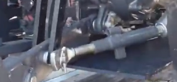

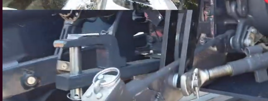

I have a 2022 4707 and I have the same issue. Unfortunately, I am also inexperienced in a tractor of this size. I've used a 1999 90hp cat 2 Deere before and had absolutely no issues hooking up the same implements. I called my Massey dealer and they said I could just by different stabilizer arms to make it come in more narrow. That seems stupid to have to buy new stabilizer arms, but these things don't come in very much.
I've tried to watch DLH's youtube videos because his 4710 is basically the same, just a couple years older. His stabilizer arms seem to have several holes for the pin to slide into. That seems like it would solve the problem. So I've looked around for new stabilizer arms, but I haven't found much promising and therefore haven't bought anything.
The only other option I see is remove one of the arms and just letting the other do the stabilizing job I guess. But I'm with you that it sounds like a bad solution.
