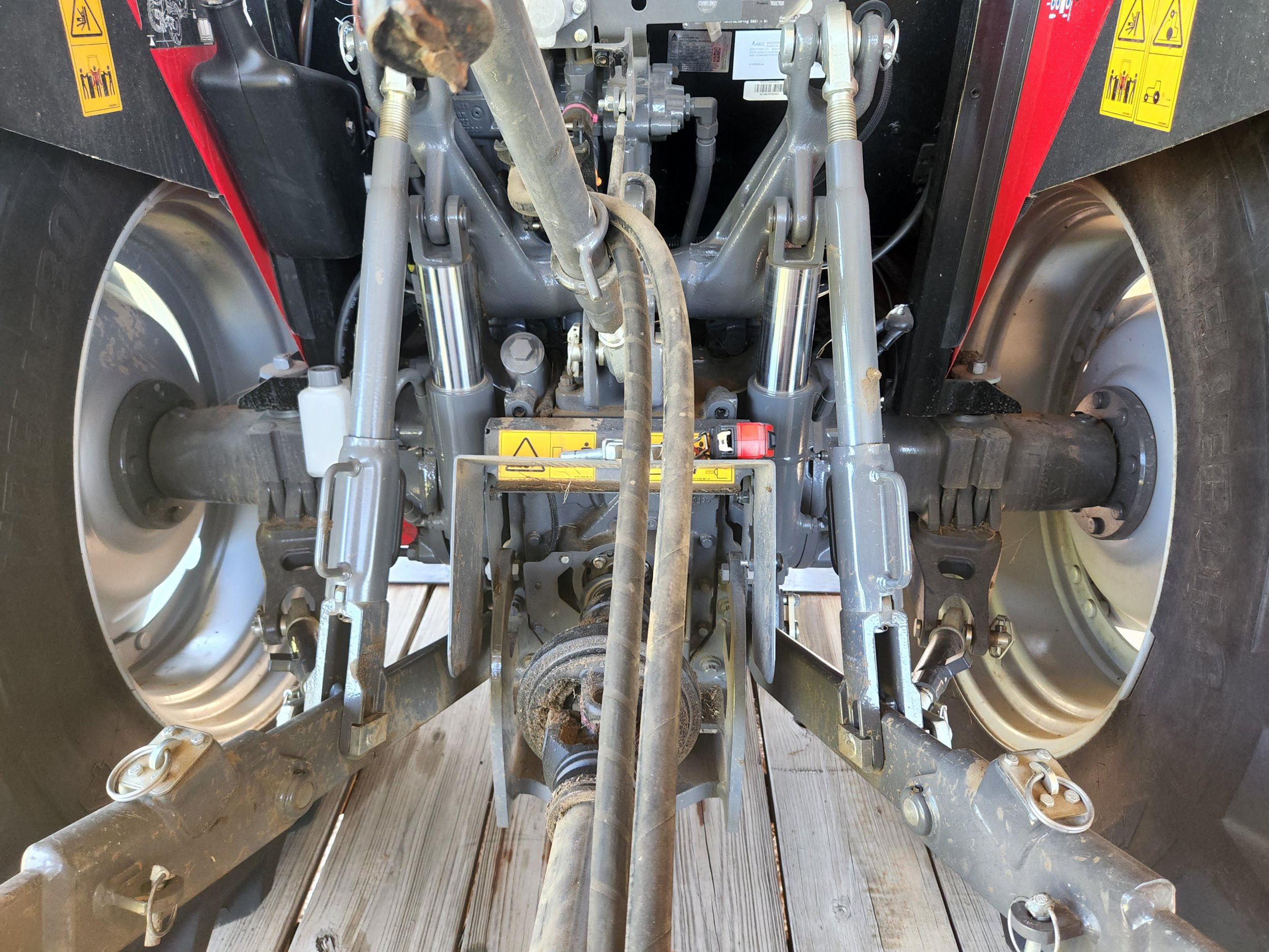

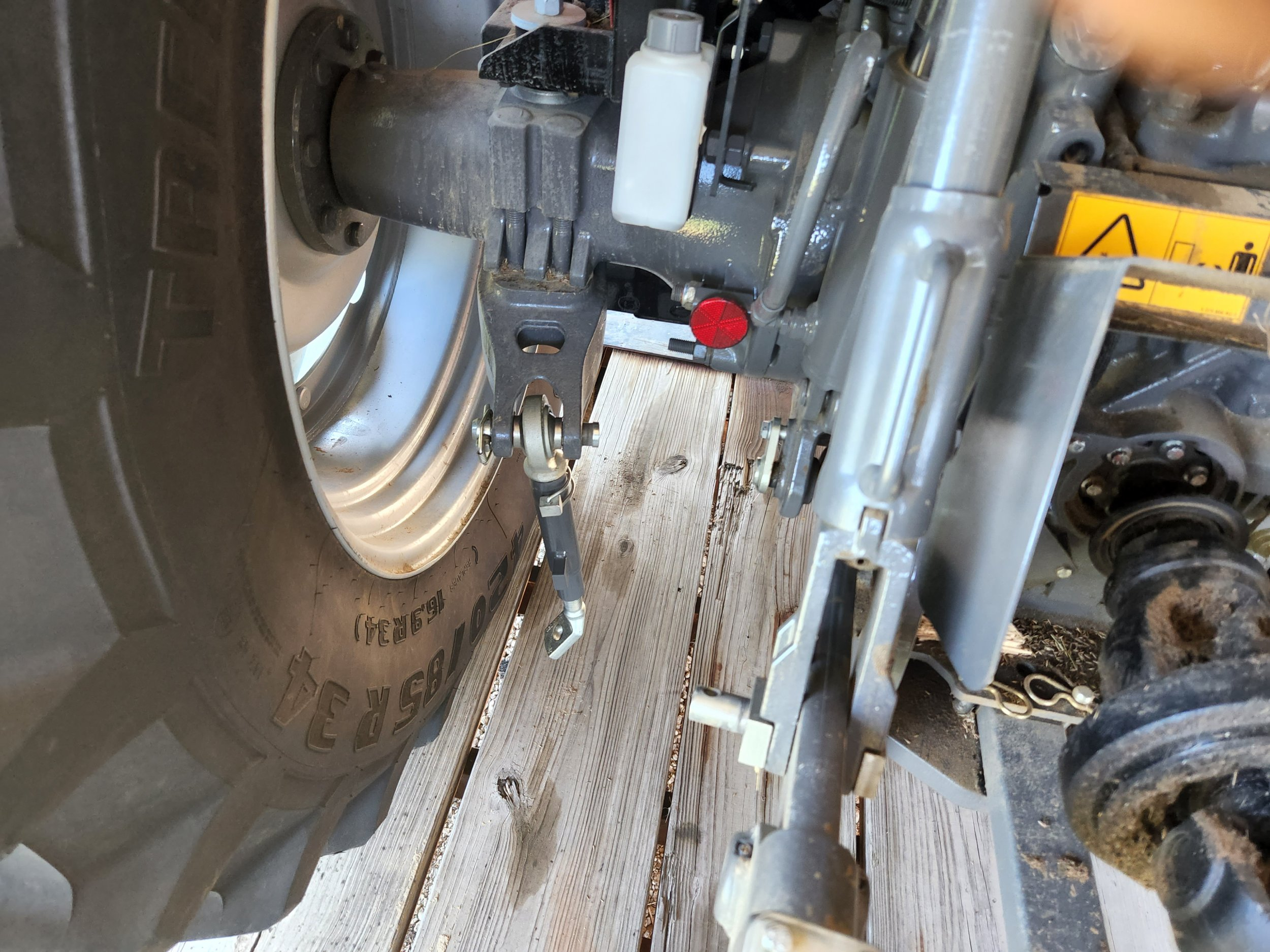

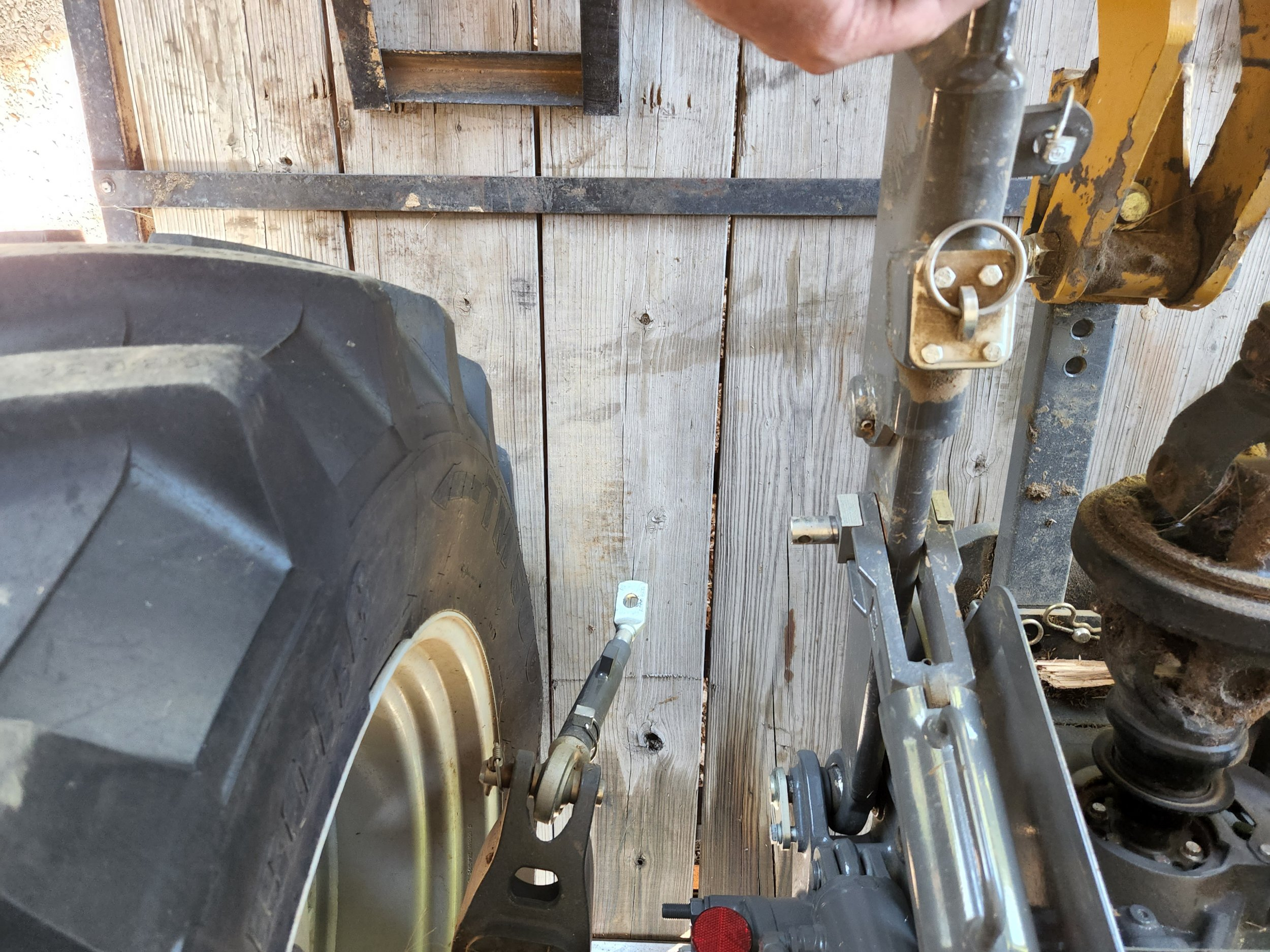

I am having issues hooking up a brush cutter I purchased, I can't seem to get the lower arms narrow enough to fit into the slots on the attachment. This is my first time hooking anything up so I figure I must be missing something. I extended the sway bar threads as far as they will go, is there another adjustment point I'm ignoring?
Thanks
I just looked my 4707 and I found that when the threads are visible, it does not slide out very much. When the threads are not visible, there is a lot more movement. Try turning the turnbuckle all the way in the other direction so you cannot see any of the threads.

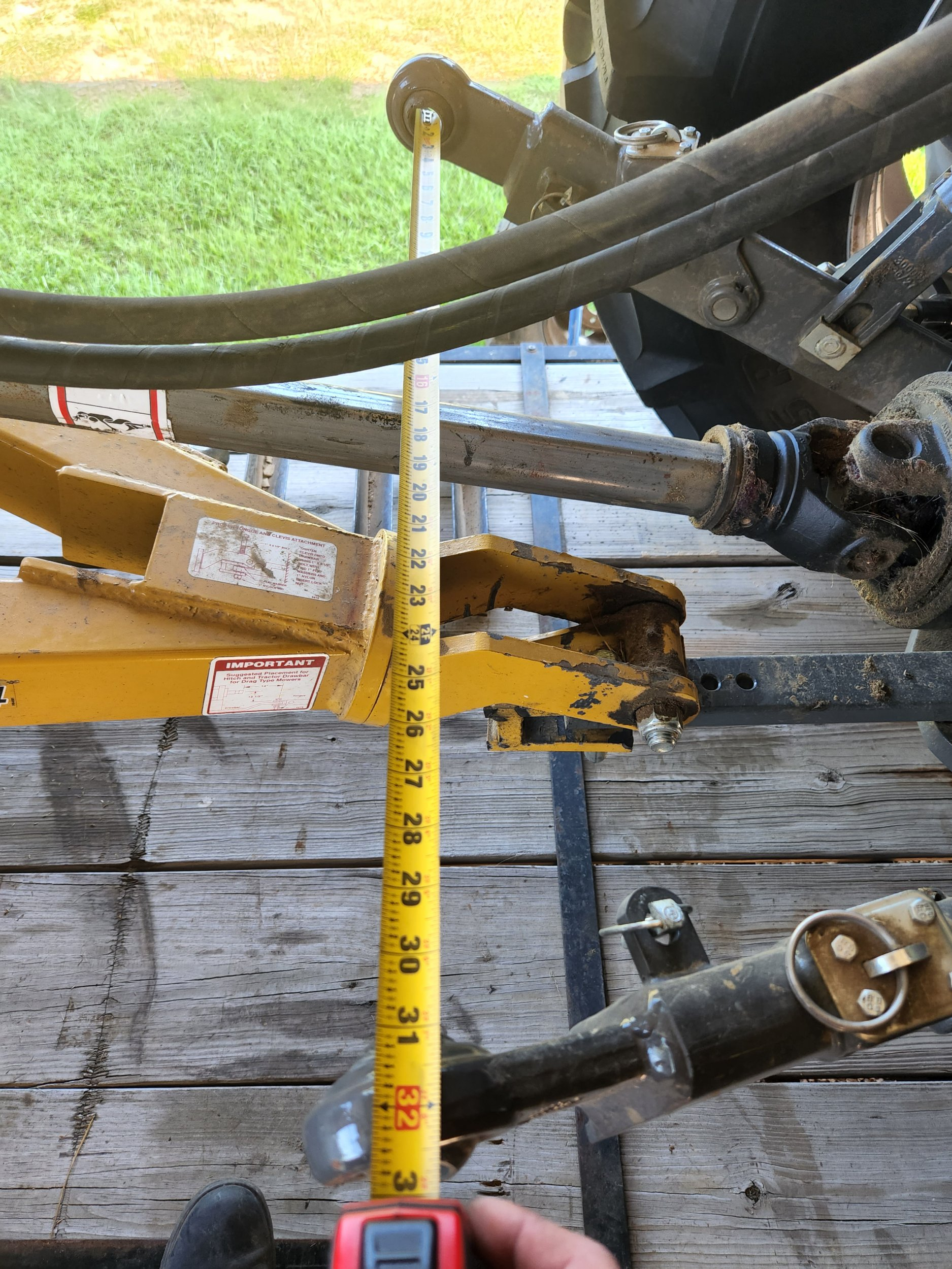

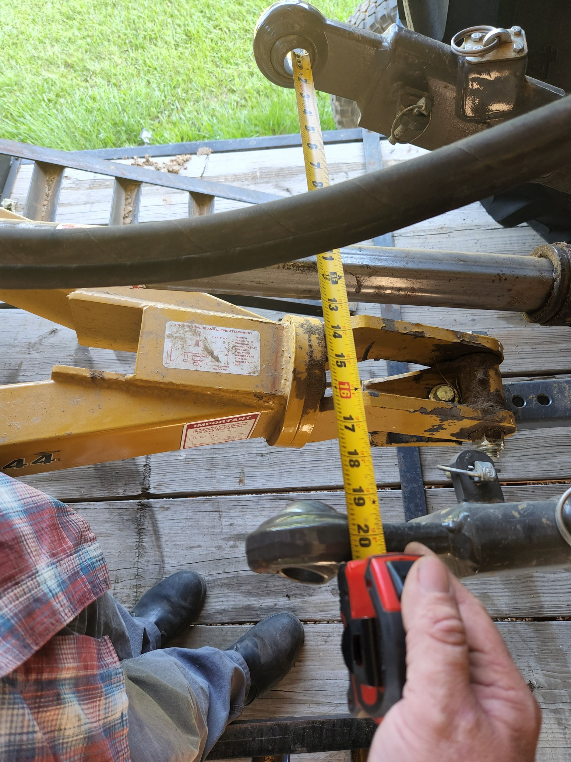

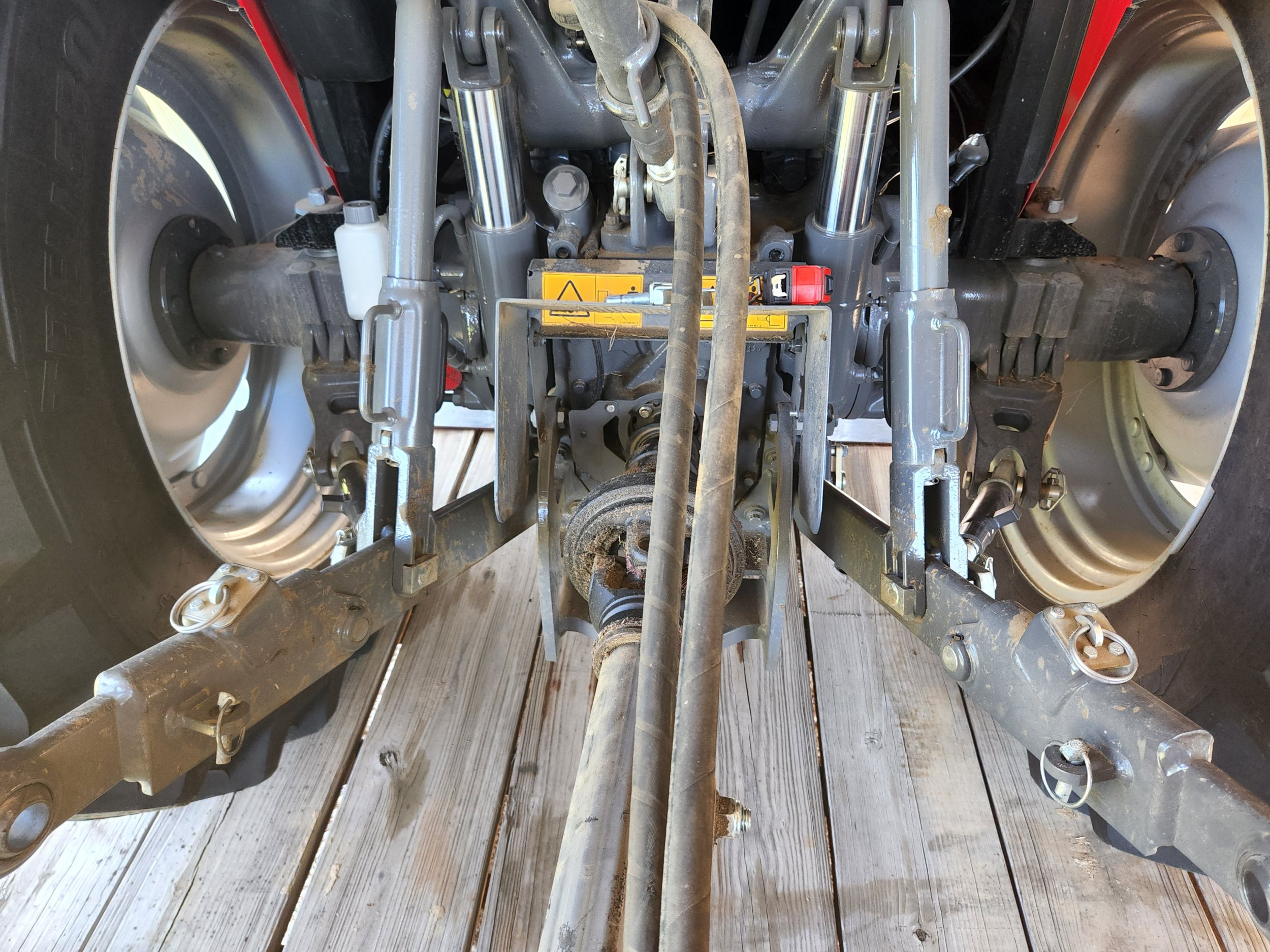

Congrats Eddie I know you’ve been waiting patiently. They look to be a very stout built utility tractor. So I’m curious what the minimum and maximum arm end widths are when using both stabilizer bars?
   / 4707 3 Point adjustment issues #48

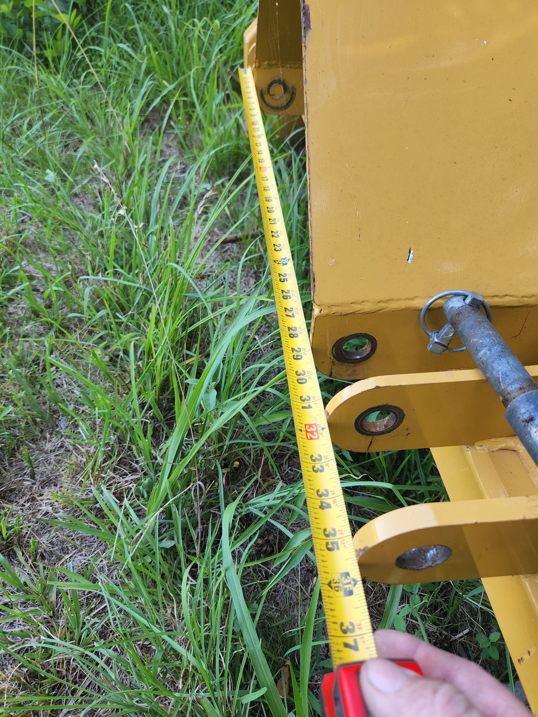

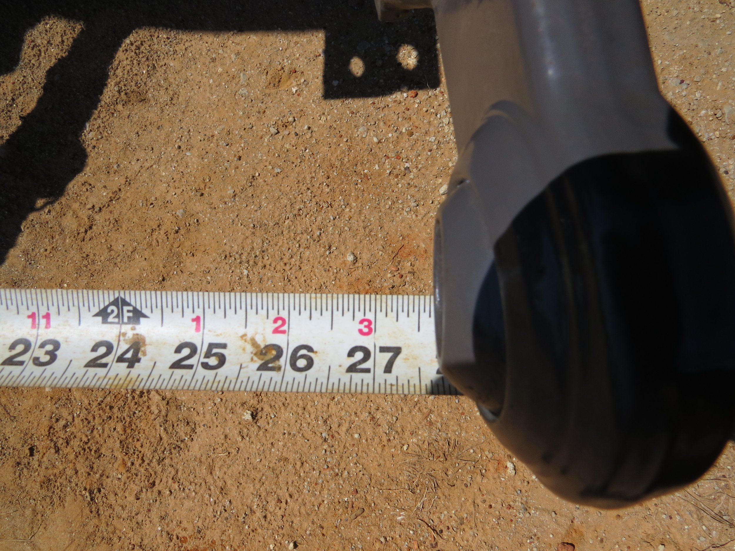

I just put a tape on the lift arms with the threads turned all the way in and it says 27 5/8's inches between them on the inside.
Then I pulled the pin that holds the adjusting link to the lift are and it all fell apart. I have no idea if this makes it easier to hook something up, or what? Once it's off, the lift arms go ALOT closer together!!!

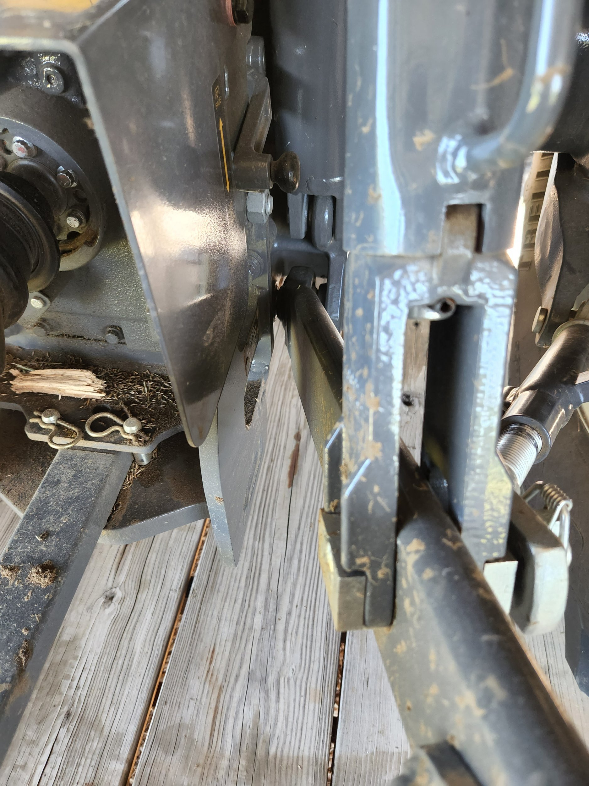

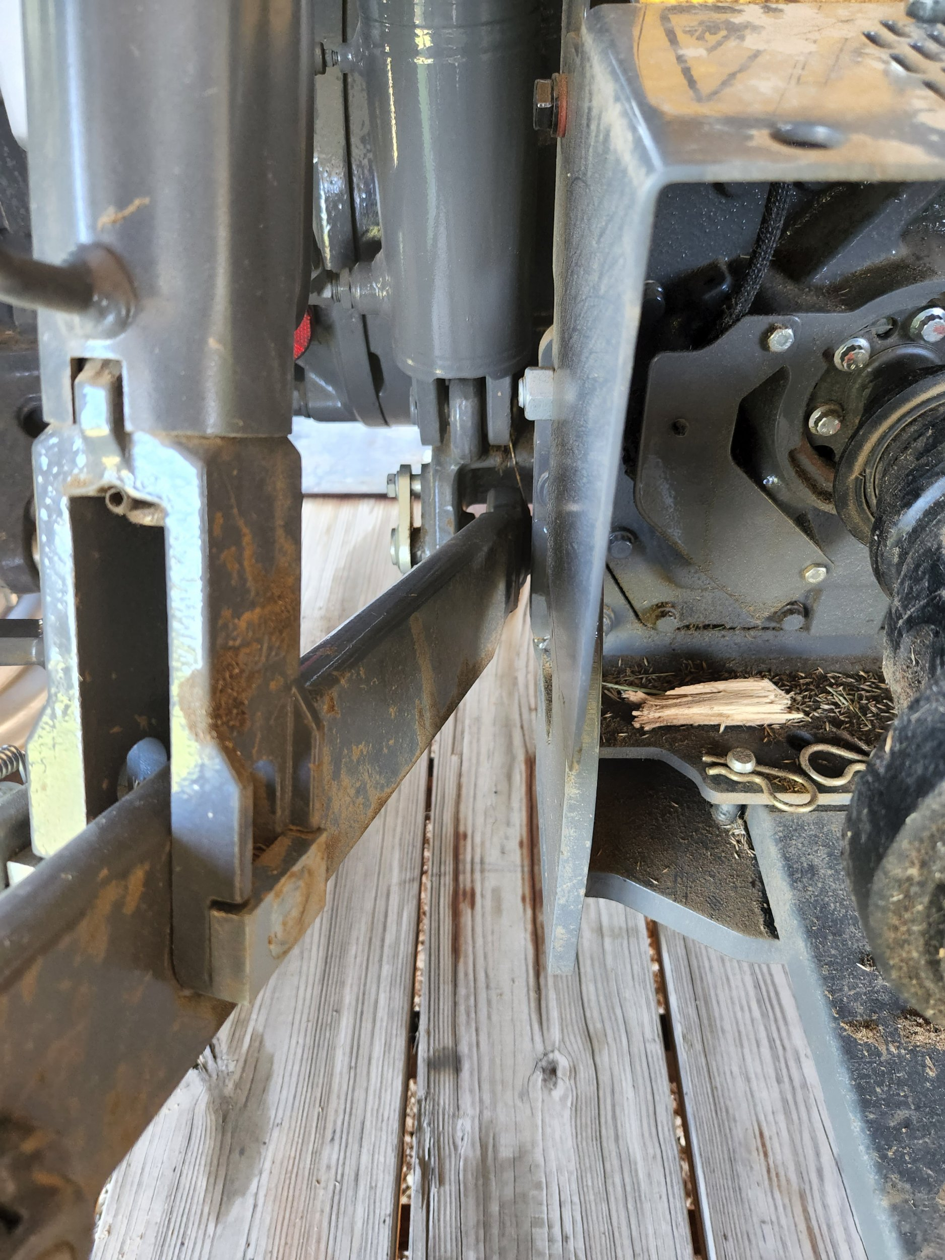

   / 4707 3 Point adjustment issues #50
I think I would drill a new hole in the part that attaches to the tractor 90 degrees from the other hole. Maybe split the difference from the end. That would give more flexibility.

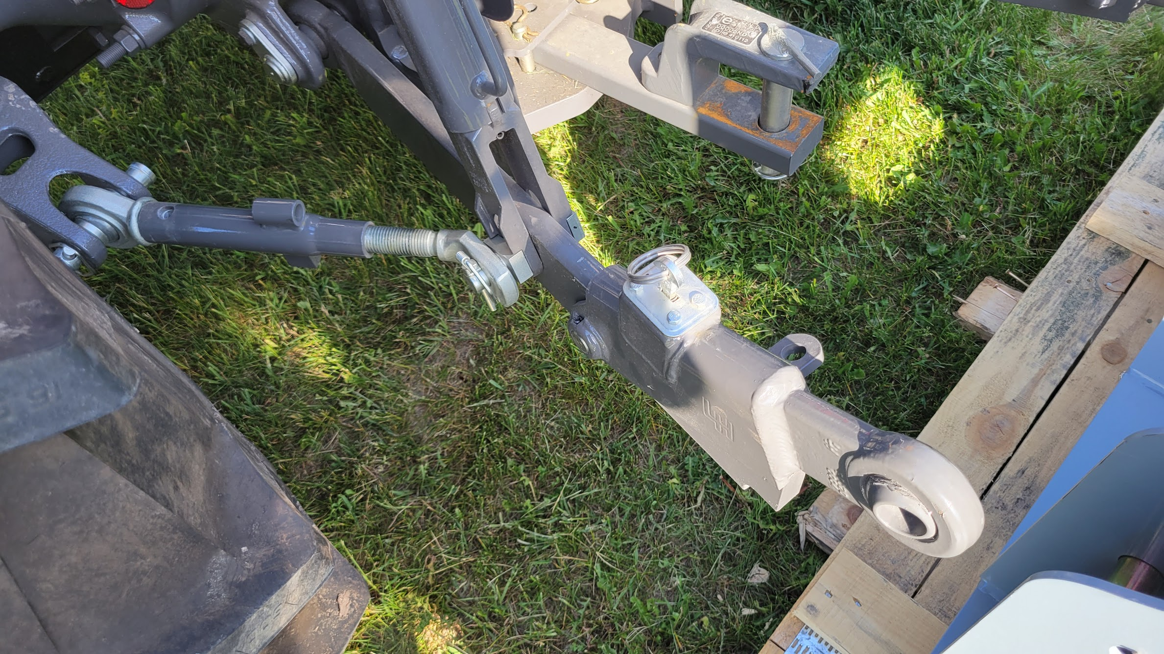

It looks to me that your stabilizer bars are not adjusted correctly , did you take one end off to adjust it ? If it was set up correctly from the dealer then you shouldn't have to take the end off to adjust it. Both ends of the stabilizer should have the same amount of threads showing, then just turn the centre section of the stabilizer to either lengthen it or the other way to shorten it. In picture 4 of the first post it looks like one end is all the way in and the other is out showing lots of threads. The stabilizer bar should work just like a turnbuckle.
   / 4707 3 Point adjustment issues #52
These stabilizers are different. not made that way.
They only have threads on one end.
Look at Eddie's picture:

I understand that it doesnt make sense. I havent figured it out in a way that makes sense. I'm 100 persent positive that with the threads in, there is more travel in the arms to go closer together. I just cant explain why.
   / 4707 3 Point adjustment issues #54
Ya I see that now , what about where the bracket that holds that end of the sway bar, is it attached to the axel by bolts and could in be moved inboard more to allow the sway bar to move the lower link arm further in. ? Something isn't right with the set up of this tractor, it should easily be capable of using cat 1 and cat 2 implements.

Pins are out. It will only slide out farther with the pin out. You cannot turn it with the pin in.
   / 4707 3 Point adjustment issues #58
I understand now Eddie. I did not even notice you could not adjust it without pulling the pin. I don’t think I would like that setup. I would be looking for another option.
   / 4707 3 Point adjustment issues #60
We all understand the relevance of that, BUT it does not solve the issue presented....
I think this would work:
