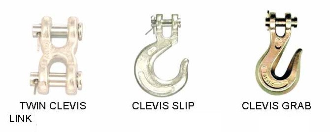

Also, IF I happen to need longer then 10ft, again, can I link them together, safely? If so, what's the best method to hook two chains together?
Hook them together for short time use. Use the twin clevis for longer term temporary.

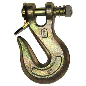

I have been switching to locking grab hooks for safety reasons

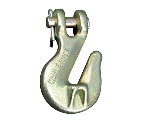

Hooking them together with a grab hook is hard on the link so avoid the very hard pulls. Chain with the short link configuration is more resistant to damage from a grab hook. The chain does weigh more tho than std link.

Hooks are available that have better link support.
