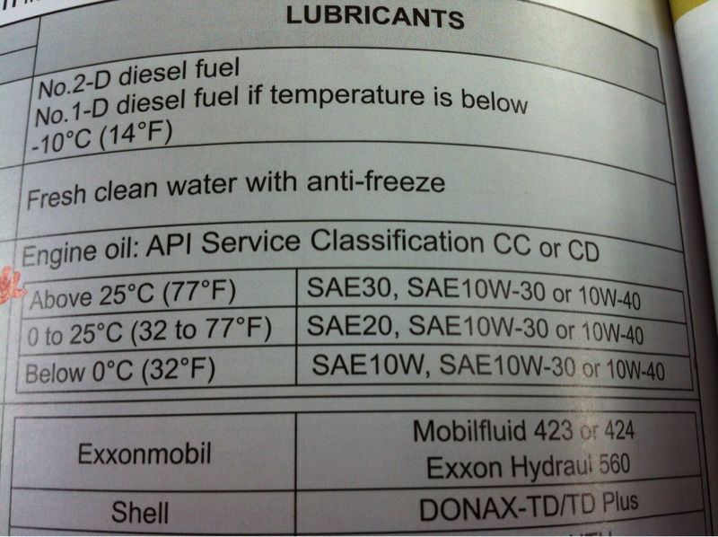

I can't find synthetic rotella 10w40 anywhere. Only 15w40. My manual says 10w40 only.

Negative. I must have a different manual.
Chris,
My dealer says 15-40 shell rotella is all they use (I just checked my email from him again to be sure). I picked up a large pail full at Canadian Tire when it was on sale 25% off a few months back.
   / 50 hrs is coming up fast. Flush??? #30
Unless you live in the north pole I wouldn't sweat that one. 15w40 works fine and is what all the autoparts stores sell for diesel trucks.
