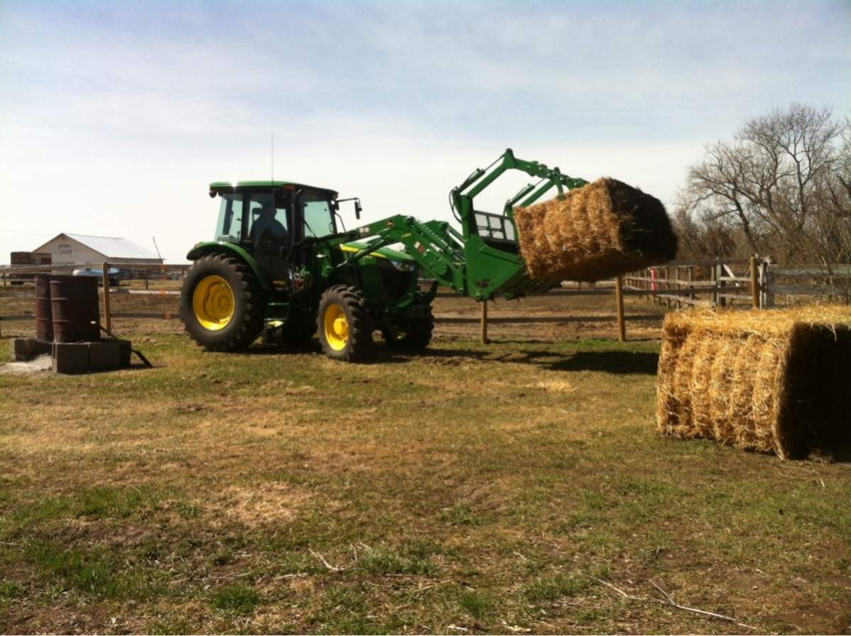

I have a ranch and a hay farm. I use a 3032E for most of the work I do. It has been a great little tractor but I'm asking it to do a lot of things beyond its capabilities and I'm tired of baking in the sun while inhaling all the dust and crap in the air. So I ordered a new tractor.
My new 5093E is being set up at my dealer as we speak. I tried to review the available options and pick out what I thought would be good to add. Would those of you with E or M tractors take a look at what I picked and let me know if I'm missing something that you would suggest I get?
  • H260 loader
  • Air ride seat
  • Right hand door kit
  • Heavy duty bucket with tabs
  • Horn kit
  • Buddy seat
  • Rear fender flares
  • Rear wheels set wider to position 6
  • All 4 tires filled
  • An extra pair of 4" LED work lights for both the front and rear
  • Hydraulic top link
  • Armstrong AG 72" grapple w/11 tines
  • WR Long 3rd valve kit with 3rd function joystick
  • Hydraulic lines for grapple run inside H260 with quick disconnects
  • Kenwood high end radio
  • Cabcam system with 3 cameras
I have decided on wheel weights, outside mirrors, and the side discharge exhaust kit yet.
Thanks in advance for your help.

Telescopic mirrors come in handy when pulling things
Front fenders (stationary cause you have the loader) help keep the mud off the cab.
If you can I would get at least the 540/530e PTO
540/540e/1000 I find comes in handy (I use the 1000 more than I thought I would.)
If you use the 3 point a lot I would get the fender 3 point control and telescopic lift arms (both makes hooking up a breeze for one person.)

i am not a fan of filled tires.much prefer weights. air seats are expensive to fix.telescopic arms are nice. i would get the cast rear centers if they are still offered.18.4 x30 tires are preferred.

(1.) PowerReverser modulator kit. (2.) Corner post exhaust - I wish I had it! (3.) 1000 rpm pto - you'll want it down the road - especially with 93hp. (4.) Get ALL the SCV's you can - front and rear. (5.) The Class II quick hitch. If you don't have a lot of attachments for your tractor - as you add them to the stable - get the QA adaptable ones. My MoCo, rototiller, and rear blade are QA.
(6.) Front weight mounting block. That thing has saved my radiator screen a dozen times already! (7.) Radial tires. Skip the wheel weights and spend the money on good tires! Especially if you're gonna have the tires filled.
I'm not that big of a fan of my front fenders. They're Ok, I guess. But, I don't roll out onto the highway or gravel roads very often; so, they don't really do that much for me. But, my front tires rub on 'em whenever I turn fully in either direction... :mad:
Maybe that happens (tire rubs) because of the front wheel extensions (4"-5"). But, my front wheels are pretty well centered with the rear wheels (fully extended) so, the tractor is very stable! I'd rather have the front wheel extensions and get rid of the fenders!
(8.) Optional grill guard. That wire mesh works. Big open hole up there is just waitin' for something to bust the lights out!
I'm sure I forgot something... but, this is a real good start!! :laughing:

I was hoping you'd reply to my post since you have practical experience with these machines. Thanks!
I was sure about the power reverser modulator. My plan was to go without it and see how I liked the tractor without it. Bad plan huh?
I'm not sure I know what a "corner post exhaust" is, can you explain it for me or perhaps post a picture? There is a side exhaust kit which gets rid of the "stack" coming straight up and I'm leaning twords getting it so it isn't blocking my view.
Can you show me what the front weight block looks like on yours?
I'm only going to add the REAR fender extensions. No front fenders for exactly the reasons you described.
The front wire mesh grill guard isn't an option if you get the bigger H260 loader. You can only get it with the 553 loader. Stupid, because I think you are right that big hole is an accident looking for a place to happen.
Amazing how my initial budget of $45k has been blown away and I'm quickly approaching 20% more.

You can always add the modulator switch later on. The wiring is present - you have to punch out the dash location and connect it. The "corner post" exhaust pipe routes vertically along the right front corner post of the cab. So, it's not in your line of sight and it's not readily vulnerable to damage, either.
You'll need some additional weight on the rear axle. Wheel weights, filled tires, ballast box. Or, some combination. I have wheel weights and they're not adequate; ~400lbs with hardware, etc. Filled tires will triple that number... or more - likely ~8-900lbs per tire. I don't have a strong opinion about one versus the other - just get something. The 5000 series has a light @ss!
I wish that I'd bought radial tires for the added handling and ride comfort as well as the improved traction and wear capabilities. Tires are on the 10-year plan or more. Once you have 'em... you're gonna be using them for a long time! Best to get some good ones - IMO.
Here's a shot of the front weight bracket.
The newer grill guard is a good, solid one. Don't know why the dropped the wire mesh, though. I'm always in the brush - plowing snow, hauling hay, baling hay along the edge/end of the fields. Pushing my luck... and that mesh helps!

Filling the rear tires added a lot of weight on the rear end, it was enough for me to move these 1200lb bales and it wasn't even light on the rear at all.
