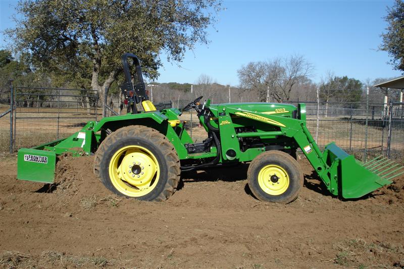

Okay, this is starting to get annoying and really make me regret not waiting 'til I could afford a 4520 4x4.
This is a pic of my 2nd time getting stuck using the BB. The first time I did this it was my fault b/c I had the teeth extended all the way down and wasn't using the draft control. This time, I had the blade just above the ground knocking down some high spots of loose soil. Am I doing something wrong? I was in B-2 at about 2000 RPM. Maybe it's just too soft to be working the soil right now. What do you guys think?

Soil looks workable to me. It's not clumping excessively and looks friable.
I'm not familiar with the 5103, but when I had my shuttle shift, I often had better luck in low range and a higher transmission gear.
But, your situation is the reason AWD works so well with CUTS and utility tractors.
/ 5103 Stuck...Again #3
Was that mound there before you got stuck?
If so I would have tried knocking it down with the FEL first and then use the box blade to do the "fine work".

Had the same thing happen a couple of times with my 650 JD without 4 wheel drive with a BB. If I wasn’t watching how much dirt was piling up in front of the BB, it would mound like your photo and the tractor would get stuck. Not sure if that’s the case with you?
/ 5103 Stuck...Again #7
So why can't you just use the FEL and push your self right out of the hole backwards? Looks like its barely even stuck at all. I've had my 2210 buried front and rear to the axles and used to FEL to push myself out backwards 20 feet or more. It was only 6 inches at a time, but in 15 minutes I was out and on my way again.
If nothing else, when you pick up the 3 pt it should give you extra traction and that sucker should walk right out (before you are stopped). :cool:
/ 5103 Stuck...Again #8
Your not stuck till the frame is sitting on the ground, especially with a FEL on the tractor...
David from jax
/ 5103 Stuck...Again #9
Maybe you need fluid in your rear tires. Looks like all the weight is on front end, causing rear to get light, thereby spinning and getting you stuck. If you don't want fluid in tires, hang some weight on BB.
/ 5103 Stuck...Again #10
Chip, take smaller bites. You are trying to move too much material at one time. You would have no trouble doing the task with a 4 wheel drive,but with 2 wheel drive you are just going to have to make more passes and take less material. As far as getting unstuck using the FEL.......... You can't or you will ruin your manure forks. Just work a little less material at a time. Dont' let so much build up in the box an halt your forward momentum. Once you get too much in the box your 2 wheel drive tractor is not able to maintain enough traction to pull the weight of the material.

I have a 5203, which I really like, and will have to add the third vote for the smaller bites.

Smaller bites and use diff lock when it starts to spin.
/ 5103 Stuck...Again #14
Smaller bites for sure. I would also load the rear tires for FEL safety and traction. FEL makes the rear too light.
/ 5103 Stuck...Again #15
Are those R4's on the back?. If so that is your biggest problem. A 2wd with R1's is as good as a 4wd with R4's on loose or muddy ground. If they are R4's, your dealer will probably be willing to swap you for R1's and maybe put a little cash in your pocket as R4's are about $400 more a set for that tractor. Also, you would be better off with a simple and much cheaper rear blade instead of the box blade you are using. These don't hold enough dirt to get you into the trouble you are in now. Again, the dealer would probably trade you and give you the cash difference.

This says it all....Unless you load the tires you need to take the FEL off. You'll be amazed at how much better it handles. Your dirt looks great....mine is all mud right now.
/ 5103 Stuck...Again #18
The FEL really does take all the weight off the rear end, so a 2 wheel drive tractor would benefit a lot from extra weight in the rear.

Thanks for all of the replies.
The rear tires are loaded and Ag tread, but does anyone know if you can get a wider tire?
I tried walking out with the FEL, to no avail. The soil was too loose to push against.
I think my mistake was allowing all of that dirt to pile up in my BB. I have a rear blade, but haven't used it yet. I was using the BB teeth to break up the dirt first. I'm planning on blading and raking this pasture when I get a chance.

bro,surely you have tried the diff. lock for true posi trac.if the pile of dirt behind you is keeping you from going forward you might have to get the old shovel out and dig some of the dirt out so the bb can pass through.i know that the 3 point doesn't raise high enough to clear that pile or at least my 5203 doesn't raise very high on the front.also,have you tried to let some air out of your tires to get a wider foot print.wait you said that your tires were loaded.i don't know how you would let air out w/o letting some fluid too.maybe someone will have the answer to that.
