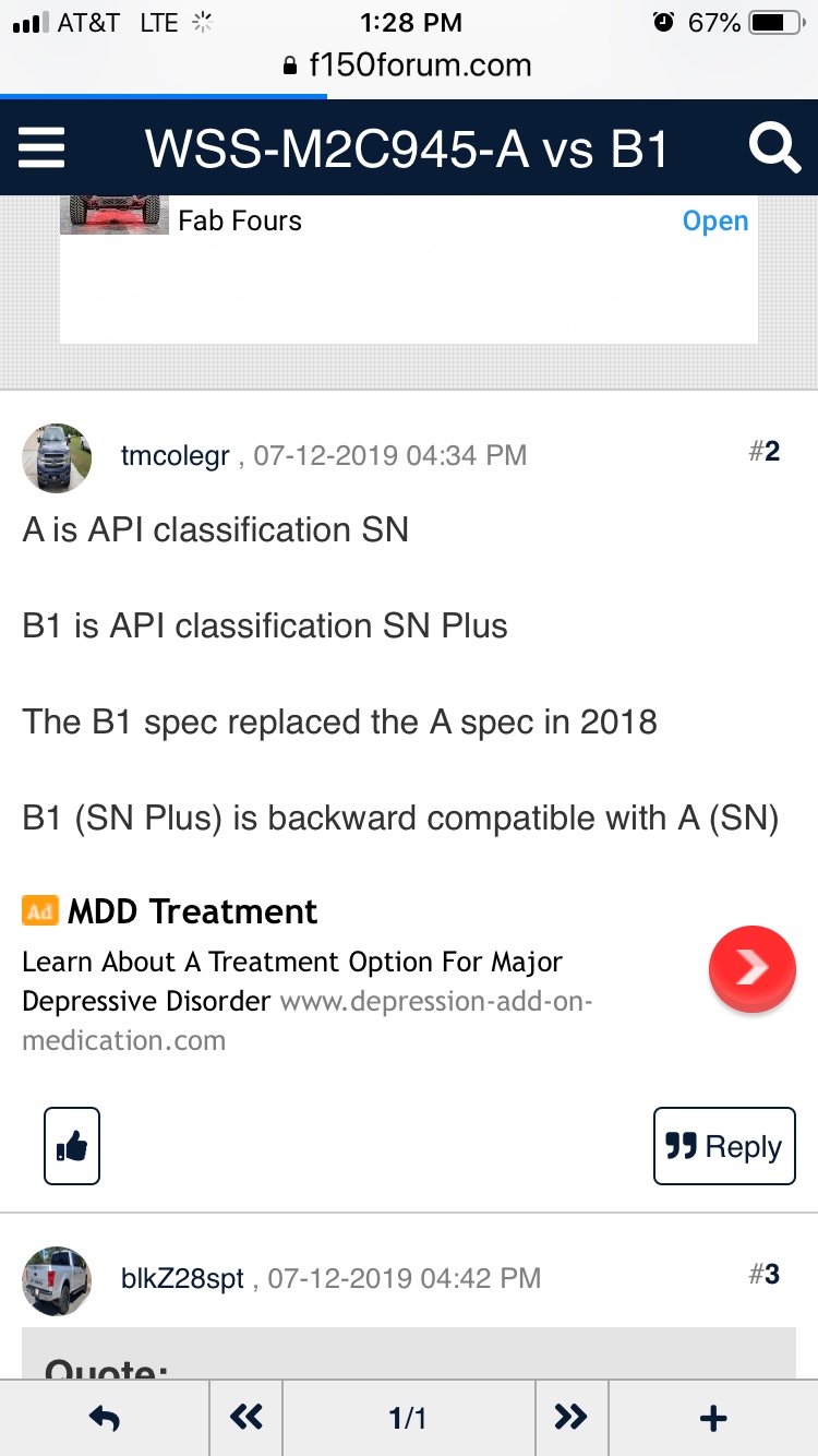

It meets A spec, which in my research supercedes B1, in other words covers the B1 requirement. This was from Ford I believe, but let me find a link to post.
Here is a better explanation

You have it backwards. WSS-M2C946-B1 replaces WSS-M2C946-A. A product meeting A might meet B1 but B1 was not defined yet. And if it subsequently has been tested to B1 they would certainly boast of it.
B1 includes Dexos 1 gen 2 and SN Plus. And probably other things.

You are correct, my bad. Shell oil meets the B1 spec. See pic of back of bottle. IMG_9509.JPG

Uh, thats WSS-M2C945-B1 not WSS-M2C946-B1. The '946 spec was for 2018+, don't know the difference, don't know what 2.7EB you have. I wouldn't rush to change the oil but would look closer before buying next time.
