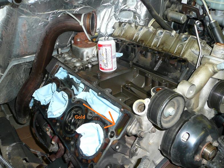

Not sure what that is, lol. But maybe that's what's in the Ford gold. All I know is that any motors that I've worked on and used gold, and only gold, no problems. Don't get me wrong, I definitely agree to taking out the cooler, and adding the filter for added protection

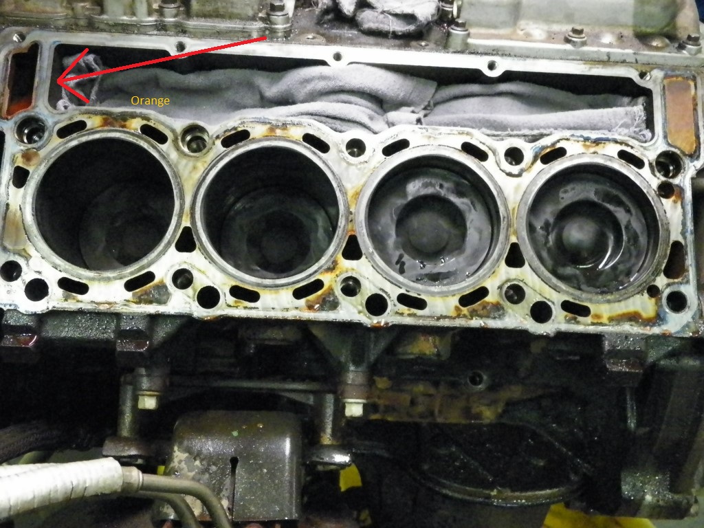

The 2nd pic shows the CAT EC-1 ELC I've been discussing. It's red in color. Ultra ELC is yellow in color.
I replaced the green antifreeze at 40k miles; I had the EGR delete/head stud work done at 90K. When I bought the truck, I went to the parts dept. to get a couple gallons of antifreeze since I planned on adding a coolant filter (I knew about the EGR cooler problems well before I bought the truck). I asked for two gallons of antifreeze for the Ford 6.0, then when they brought it out, I asked again if it was for the Ford 6.0 diesel; both of them said "yep". It was the Ford Green antifreeze, same that was in the truck - hence I didn't think anything of it until almost two years later - bad on me.
CAT EC-1 spec'd coolant will not damage the Ford 6.0 engine. CAT EC-1 ELC is what International (the engine maker) specifies for their engine (called the VT-365) in industrial vehicles (tow trucks, deliver trucks etc.). Besides the difference in factory-filled coolant (Ford installs Ford Gold; International installs ELC), VT-365-engined trucks come with a coolant filter installed. Ford 6.0 vs. VT-365 engine failures are like night and day. FWIW.

I see. I skimmed through the posts the first time. After having more time last night and going back through and reading some more of the details, I realized thats probably what you had done. When I first noticed the orange though, my initial instinct was "uh oh, he put dexcool". Its a shame that so much heat is introduced into these motors causing these problems. Otherwise, they are really good power plants. When a compressor goes out, there is a single fin on the fan shroud than can be cut out of the way to remove the compressor, cutting the labor time in half. But rumor has it that in my region (west texas, 100+ degree summers), the engine will start overheating. They will get so hot they will melt the oil filter stand pipe (this can occur from other reasons as well). People tend to do it this way though because they dread pulling the shroud out. IDK, maybe theres a trick to it or something. I know it looks daunting, but I can have it out, front and back portion, in less than 10 minutes.
