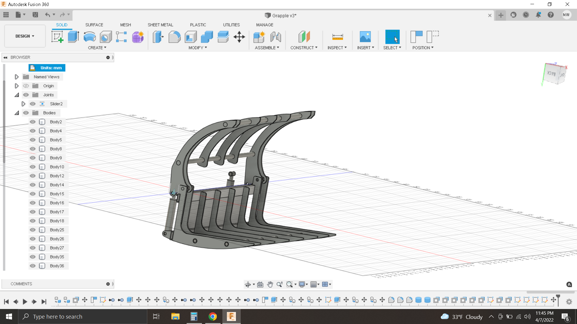

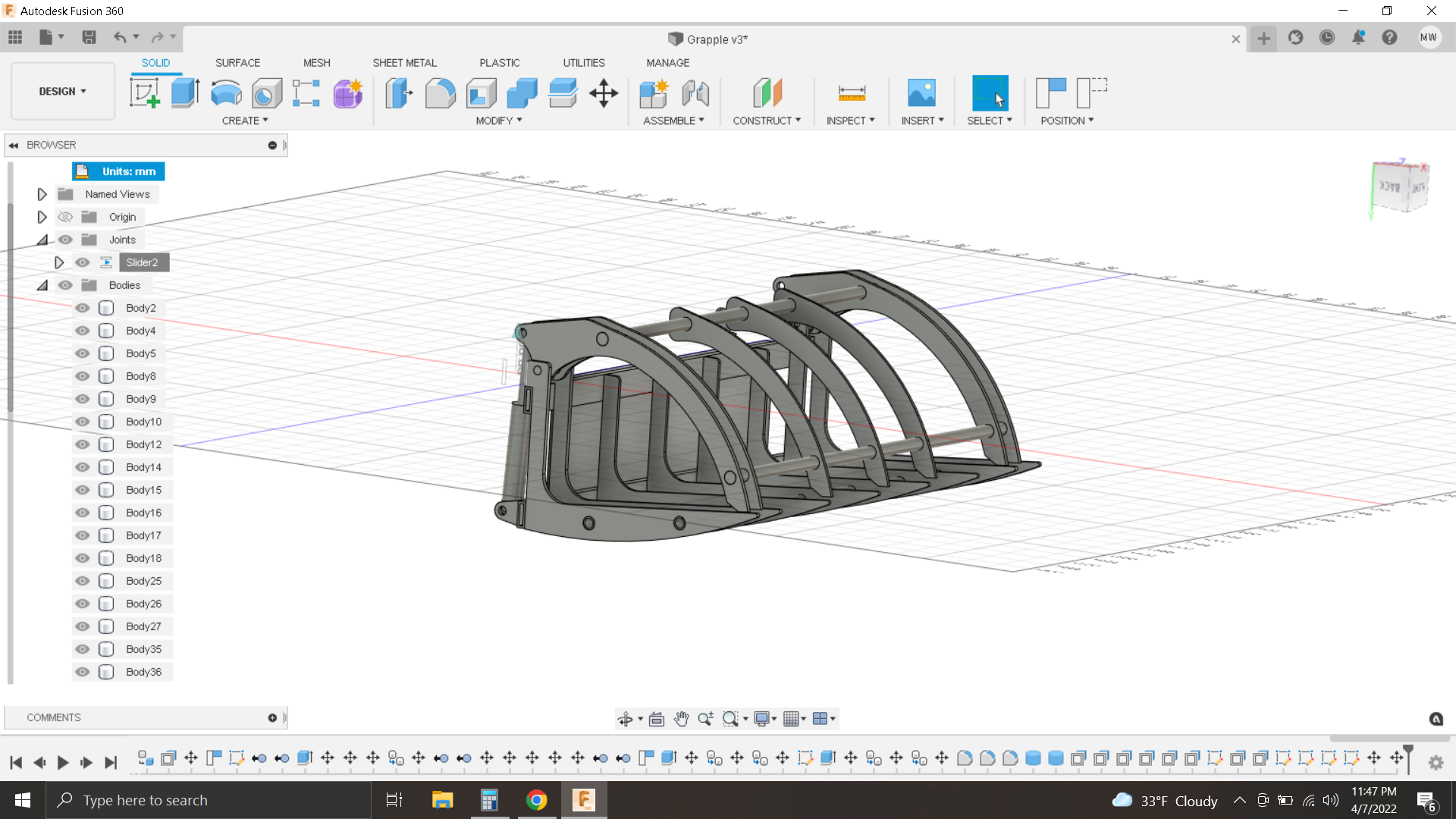

After dragging my feet too long, I've decided it's time for a grapple. I can't justify paying $2500+ for picking up logs and I own a fab shop, so let's build one!
I modeled it all up tonight and have the mechanics worked out. I'll use 1.5"x6" cylinders which will give more than enough clamp force for anything I should be working with. All the DXF files are sent off to be cnc plasma cut in town while I'm on family vacation for the next 2 weeks. Finished weight looks to be about 315lbs before the quick attach plate. No, it's not as "heavy duty" as some commercially available units out there, but it doesn't weigh 650lbs either. I have 1940lbs lift on the new to me Massey 1740M and I don't want to kill the lifting capacity. I'm confident it will be more than up to my needed tasks. Updates will come quickly when I get back!

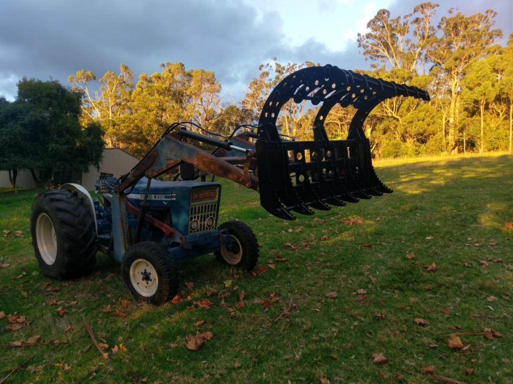

Great stuff. Just to keep you keen, here's mine that I built last year. Best thing I have ever made and gets more use than I thought it would. Steel and hydraulic components aren't cheap, but I saved myself about about 60% of the price of the very few commercial units available here.
Oh and the loader has had a respray since this photo.

Did you CNC cut your parts yourself?

Very nice work! I see you went for a much shorter lower tine size, have you ever wished they were longer? What is your primary use for it?
No, I'm having all the tines and cylinder brackets cnc plasma cut in town by a friendly business that does all my cnc plasma, laser, and waterjet work. They will come out much nicer than if I did it by hand with my plasma cutter!
   / 60" Grapple Build #5
I've never learned to use CAD, never had the time...a friend turned my pencil sketches into CAD files which I emailed to a laser cutter and picked up the components 3 days later. First time I have had laser cutting done. Amazing to see your pencil ideas transformed into real steel parts like magic.
I made mine mostly for picking up branches for the burn pile when cutting firewood or felling trees around my property and am very happy I went with this style. It is incredibly versatile, I unloaded a trailer full of 310UB joists last week- that's 12" RSJ if you prefer. Can pick up all the debris from a felled tree and then pick up the 24" logs and put them on a pile. Then I can wander across and pick up my wife's garden prunings off the lawn. No-one with a FEL should be without a grapple.

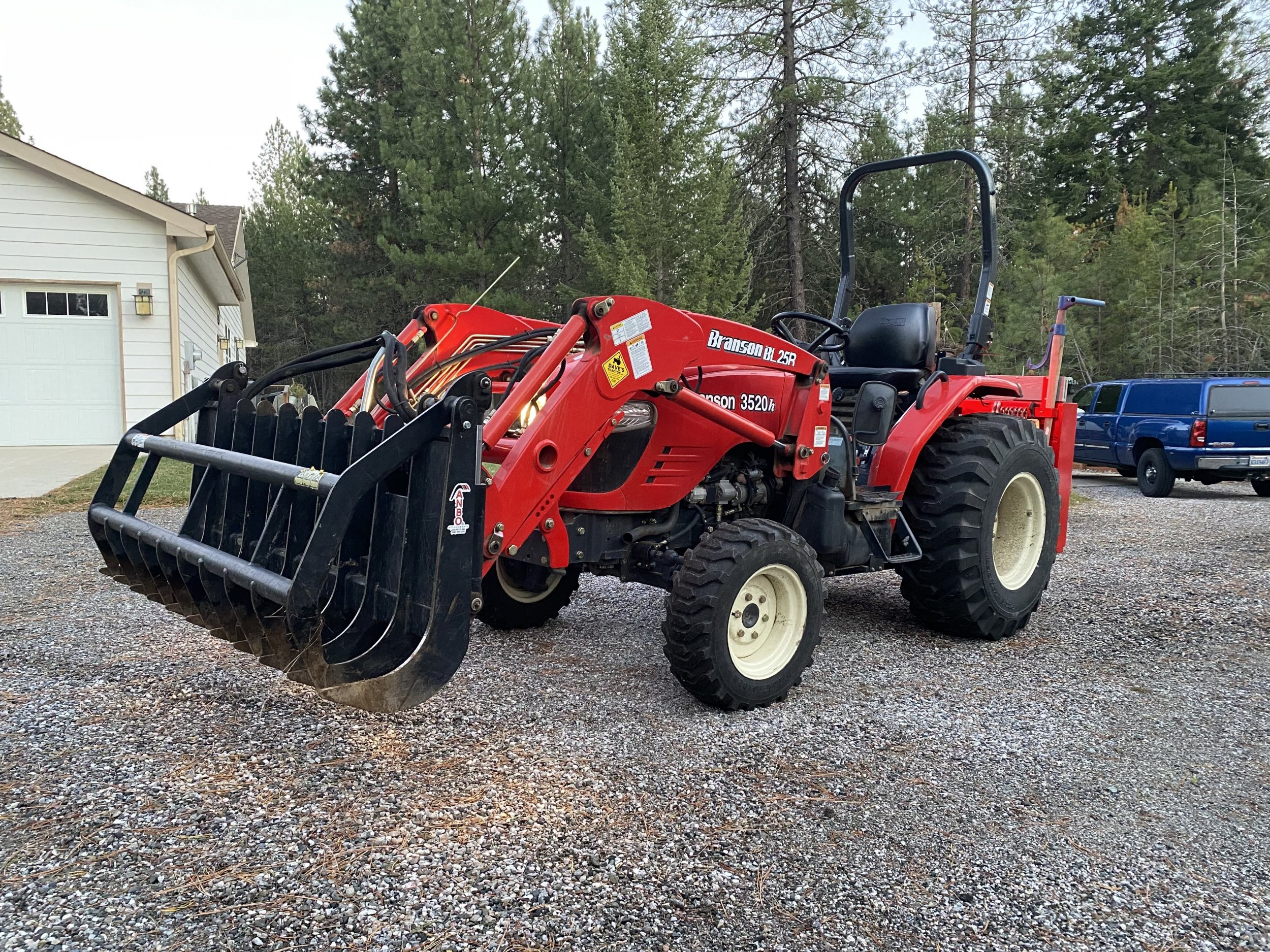

The long bottom tines can short one is really, in my opinion, the ability to “rake” debris going forward and backwards. Mine are very short and when angled properly, I can drop it on the ground and push a pile without it digging into the ground yet not ride over anything else. Alternatively, I can angle it downward to rip out roots and small trees. It can pick up a mouthful of debris as well. I rake it forward, reach over to the far end and use the upper jaw to grab the back end of the pile, move back a bit, then bite down. Sorta like eating a thick former burger that’s bigger than your mouth.
When unloading, long bottom tubes would force me to rotate the grapple practically all the way and it would be a problem when dumping at a height over the sides of my dump trailer. The short tine arrangement also allows me to “cherry pick” certain logs from a pile as an added benefit.
