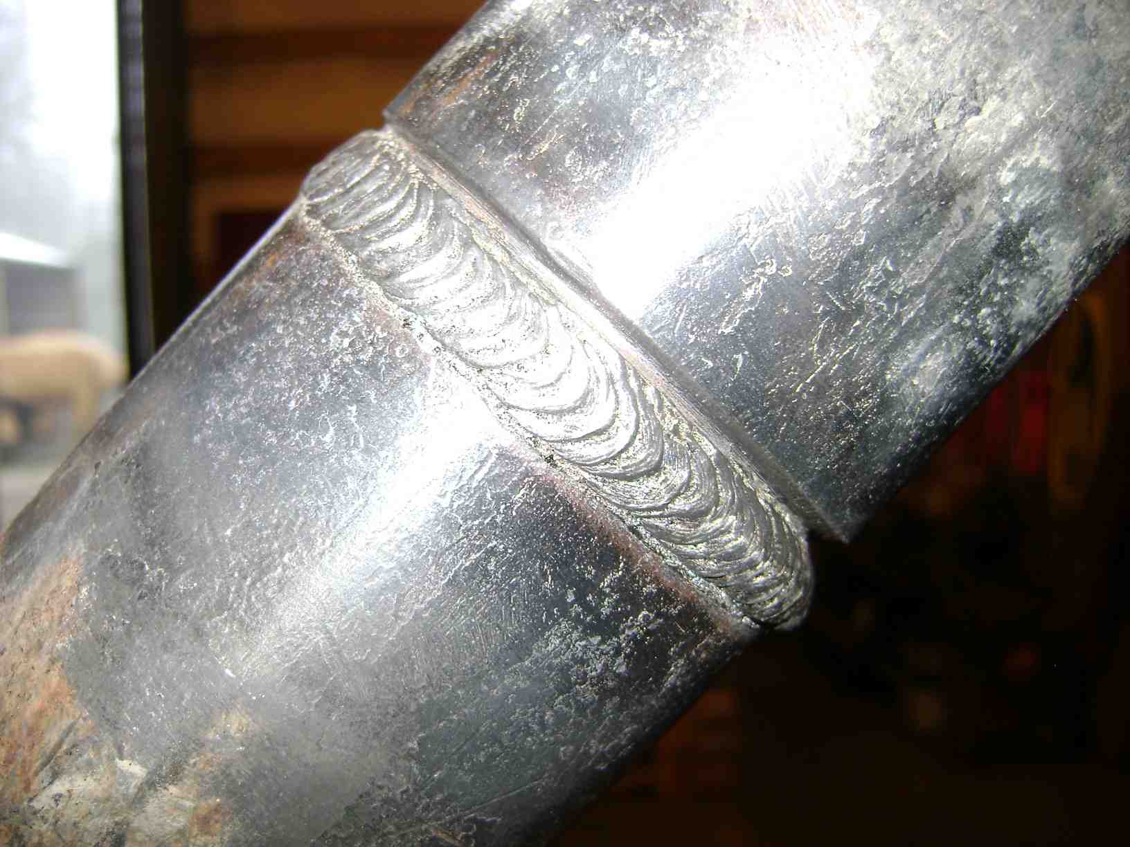

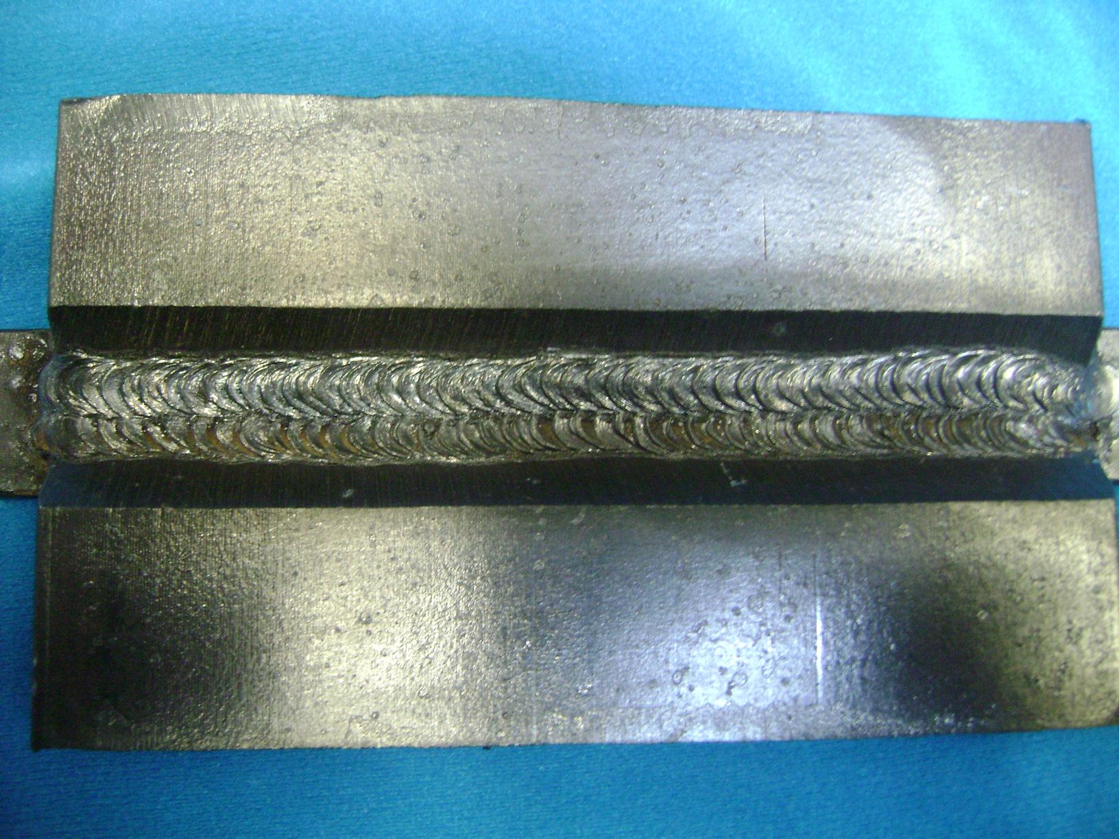

10P-Plus 10P-Plus 10P-Plus 10P-Plus, and never look back. :thumbsup::laughing:
