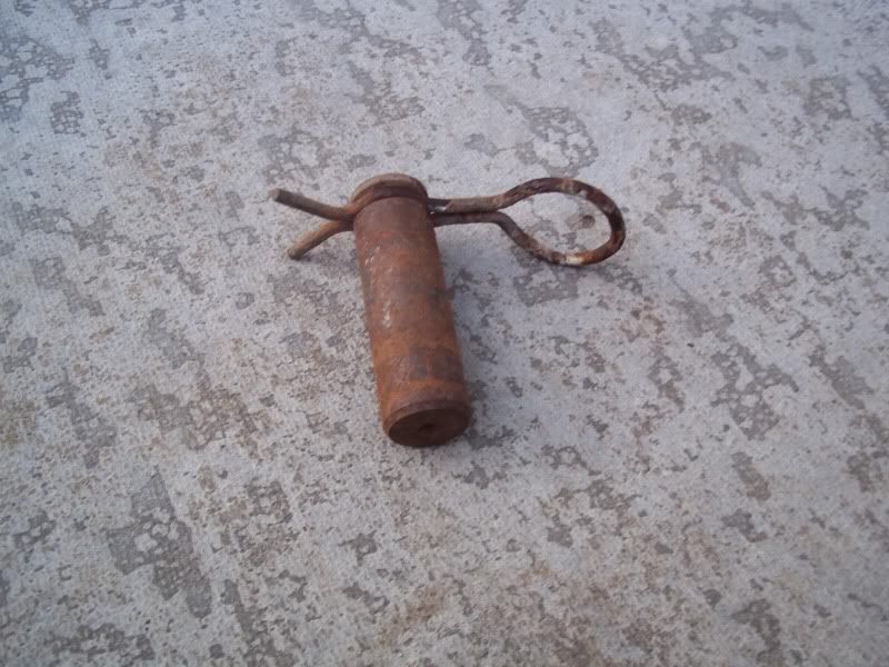

I got over to try the swinging drawbar today, it fits but in looking at Messicks parts page I can not determine what the fastener is that is used to secure the drawbar. Looks like it could be a 5/8-11 x 2-1/4" G5 HH Bolt, no nut or washer called out. There are no threads to engage a bolt so it would seem it does not take a nut.

My swinging drawbar had a smooth pin with a retainer clip. The cilp slides onto the pin on the top side of the drawbar bracket.

My swinging drawbar had a smooth pin with a retainer clip. The clip slides onto the pin on the top side of the drawbar bracket.
OK, that's what I was thinking after looking at it. It was the only logical way it could work. Is the pin anything special or can I find it at my local TSC? The hole looks to be about 7/8", so I'm thinking a 3/4" pin.
Why can I not find the pin and retainer clip on the parts page? I see the drawbar and bracket and mounting hardware, but not the pin. Is it supplied with the swinging drawbar?
   / 65 Ford 2000 3 Cylinder #60
I was looking in an old toolbox yesterday and happened to notice there was a drawbar pin and the hairpin clip that goes with it in there.
This is what you want to hold the lower drawbar in a 3 cyl tractor.
These are available from the dealer for not a lot of money.
