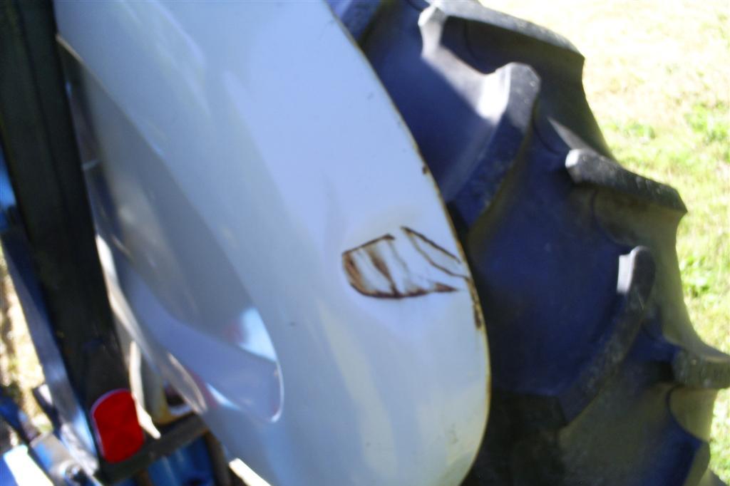

Today I found some time to clean the tractor up a bit. I washed it from stem to stern and it looks much better. I also got the new battery in and it starts much better. I wanted to warm everything up after the washing to dry up any water so I drive around for about 15 minutes to get it into operating temperature range. The temp gauge showed it was above mid-scale but not in the red.
I tried to watch for the stat opening up but couldn't see any indication on the gauge. Once the temp got to mid-scale I drove for another 5 to 8 minutes and it never went higher, but I was not working it at all just driving around. Still it did not overheat so I am reasonably sure the stat is working if there's one in there that is. The t-stat housing look like its been off recently so its been changed or removed. Easiest way to tell I can think of is to take the radiator cap off when cold and start it up. If there is circulation from the start then no stat because water is being pumped to the radiator. If there was a stat then initially it would be closed and the system would be in bypass and sending the coolant back to the block to warm it up faster not the radiator. Either that or I will take a reading with my IR temp gauge at the t-stat housing.
Sorry for the fuzzy pics. Must have left the focus setting in macro when I took a closeup of the data plate the other day. :(
The first pic is the only sheet metal damage I can find ither than a couple scrapes on the bottom of the front grill. I think if I take the fender off I can do a decent job of banging this out. Too bad the paint is gone.

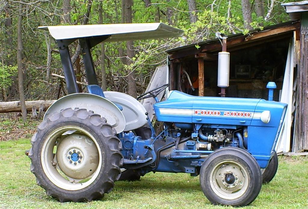

In contrast here is a photo from yesterday.
It may not look it but its a big improvement over yesterday. Getting all the dirt off the wheels, canopy and sheet metal took about 45 minutes of scrubbing by hand with a brush.
