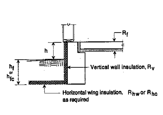

Rerod - the footer design you showed we call here in the NE a "floating slab" and I have done two of these on a barn and garage. The footer is 24" deep x 18" wide with rebar in the whole floor and in the trench tied together. It was all poured as one slab.
We chose these due to ledge - and they have worked out fine - just make sure you have a good level pad, compacted stone, and rebar all tied in.
Bottom line- it takes more concrete but less forming time. If you don't have any subsurface issues and easy digging - dig a trench down 4', pour a footer then a wall either block or concrete.
Lots of names, but if you look closer at the design I posted, the slab is separate from the "frost protected footing" I'll call it.. I'm not going to try any flatwork, but figured I could DIY the footings, build the garage, and then hire a good finisher to pour the slab. Ive been told a floating slab is considerably cheaper then digging below the frost-line, not to mention the need for wall forms when placing footers 4' down.
I'll take another look at the "frost protected footing" that you posted. Maybe I've missed something.
Did you get that design from someone with experience you trust?

No building inspections in my county.
Many footings are 12" and that is what I believe that beam is.. 12" x 24" about
I chose a FPSF because you don't have to dig below the frost line. Less work and materials, cheaper and more DIY friendly.
No I have not had a soil test done.
The stick wall is offset to keep the foundation insulation flush with the wall.
Stick with your FPSF! Not only are they less costly but living on a hunk of frozen concrete is horrible. The further into winter the colder it'll get.
The floating slab design we used was a monolith floating slab (code/engineering stamped) its all one slab with thick footings 18-24" wide by 18-24" deep perimeter with a 5" floor with rebar and are all one pour for a contiguous concrete foundation. Our barn and garage have been in 24 years no issues with cracking or settling - and we didn't use any rigid insulation under it or the perimeter.
Its a real easy forming job around the perimeter but if you are heating and doing plumbing in the slab plan it now or put in 3" pipe for future water/drain lines with insulation. I did prep the area with my BH and added 18 yards of crusher run stone then leveled and compacted that.
That's funny, because I thought my picture came from this Revised Builder’s Guide to Frost Protected Shallow Foundations.. But I cant seem to find it in there.. lol. I saved it because it was the first picture of a frost protected shallow foundation where the footing and slab were two separate pours.. Which I thought would be a big advantage in my build.
The picture you saved might have been a different edition. That link you posted is to a "Revised Guide" - but I don't think it matters. The designs in that link look similar enogh to the one you posted a few days ago.
At least they are similar enough that I can see what was bothering me. In a nutshell, the author of those designs is making assumptions about heat flow that I don't agree with. I'm not saying he is wrong; I just wouldn't build that way. I also believe that most builders and engineers wouldn't either - not given today's materials and energy costs.
One of the assumptions in those designs is that that the building is always heated in the winter. With enough heat in the building, the foundation designer is showing he can build above frost line. The requirement is that the building always has enough spare heat to keep the foundation and surrounding supporting soil above freezing. Then by using enough insulation within a normally frozen depth, the designer is showing that the extra heat can be trapped.
So the design will work as long as some special conditions are met. They are implicit in his heat flow math, and are also mentioned in the text.
First is the one of having enough building heat to be able to keep the building plus the foundation above freezing, also the insulation has to be some sort of super insulation that never changes R value, and finally there cannot be any change in moisture around or underneath the foundation.
Spend the money and energy to meet those conditions, and there are no problems. But by not meeting all of those conditions, there will come a cold snap that may cause the foundation to see frost-jacking and then heaving.. That doesn't mean the building falls down, but it is exactly what was bothering me about that type of foundation design.
It's just a difference in personal preference. I see buildings as being a lot of work to put up. I'm real big on stability and structures that resist forces. Call me old fashioned because it's true.
So I prefer to over-design some things - like foundations - to automatically stay stable for the life of a structure. I just don't care for designs that require on-going special attention to work properly - in spite of that being the direction that the world is going now.
YMMV, and that's fine.
Good luck with it however you decide to do it.
