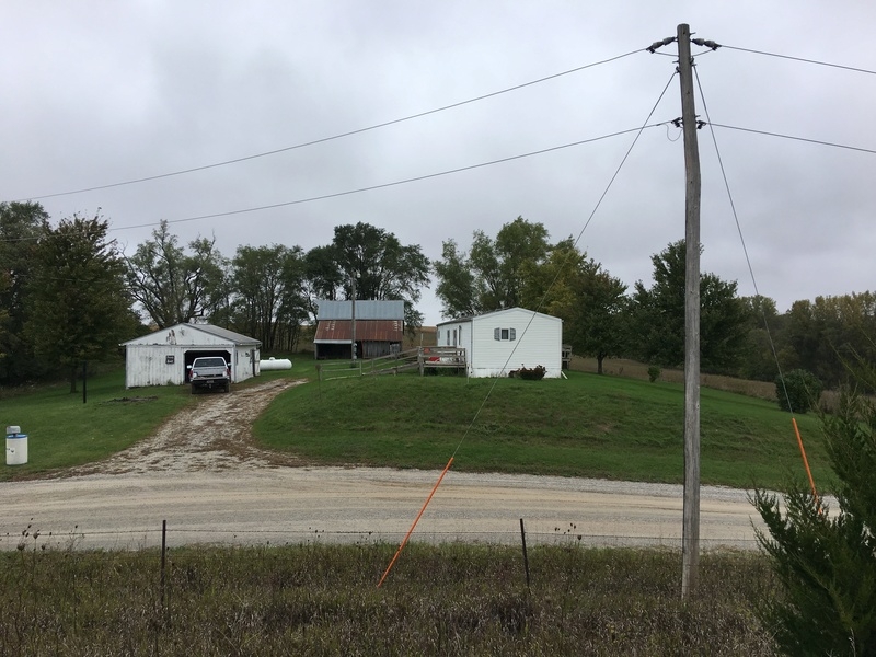

My hill top property has a functional mobile home on it my GF lives in, so yes a upgraded septic eventually needs installed, maybe, but isn't important considering the two existing bathrooms. Plumbing will be installed, but not hooked up until later. The barn has been torn down but the crumbling foundation remains. My tiny acreage feels big because there's no one in sight..
And CliffordK is correct.. I only need to build one garage, bury one septic.. But I work really slow, and its not a small garage. I should have built violins as much attention I give to details and if I hired a contractor to build this, he'd probably fire me like my financial advisor did lol..
So the trick is to buy and be able to sell without losing to much so I need to buy used, and hope I don't end up with big repairs.. But knowing me, I'll probably keep it around, but 25k is allot for something that doesn't make you money though. 25k might not buy much backhoe either.
As far as the 74 hp.. That's the hp rating of the 4b cummins engines I like and wouldn't be fair comparing a case 95XT skid, to any tractor or backhoe smaller than the case 580 with the same engine.. But I'm getting the feeling the cummins engines aren't as big a deal in the tractor and skid steer industry as they were in trucks.. Id like to find a 75 hp 4x4 tractor with a removable backhoe, but they are much smaller. Looks like they put allot of stress on the three point too.

I called my local equipment place who said they stopped renting skid steers but has a JCD 8040 mini ex for 300 a day, so that should take care of any deep digging..
I started to look closer at my foundation details and now think a skid steer might be the best?
The detail I was forgetting was the buried 4'x8' horizontal foam insulation "wings" or apron that surrounds the entire foundation outside, protecting the shallow footings from heaving..
To me, it looks like I need to level my area and then dig a 5' wide 2.5' deep flat bottom ditch to place the insulation and forms, actually pitched away a little. Then back fill to secure the insulation and forms, stake and pour.. Does this sound right? I believe this variation is called a frost protected shallow stem wall, which doesn't need a backhoe..
