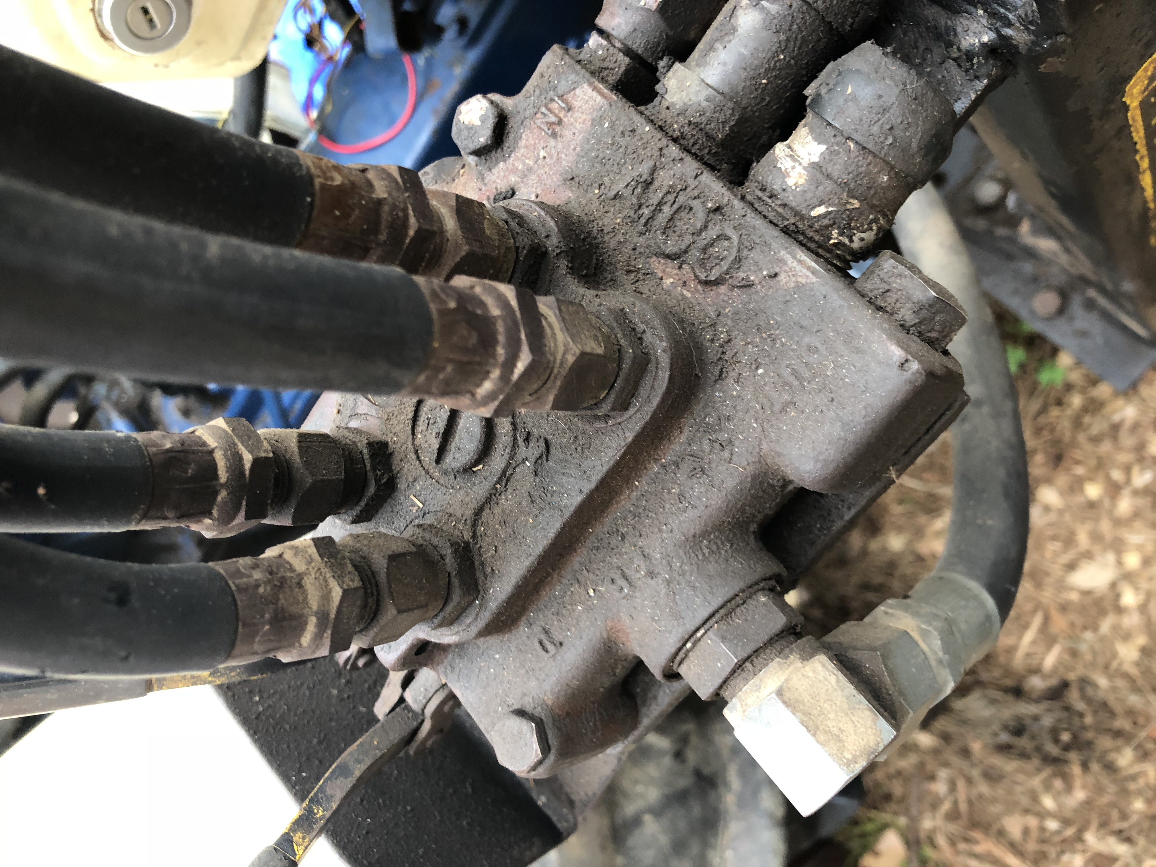

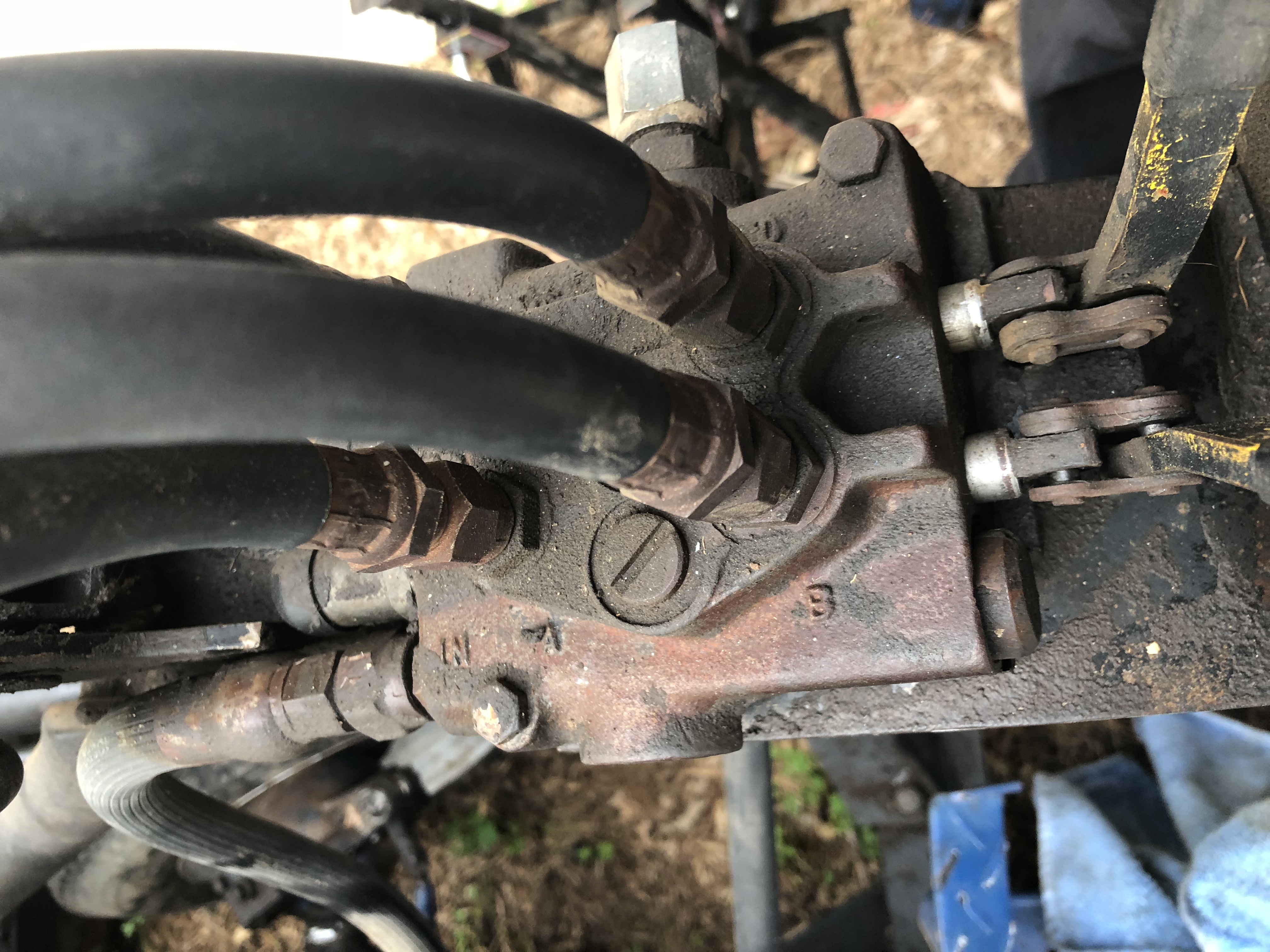

Does anyone know anything about the satoh beavers hydraulic system? My pump pulls fluid from the tank with a large hard pipe suction line, pumps it back to the same manifold it comes out of on the right side of the tractor through a smaller diameter hard line. Then on the left side of the tractor theres another manifold that sends pressurized fluid to my loader valve where it enters the port marked IN, from there it can operate the loader and then there are 2 ports where fluid could exit but my hose is plumbed from the PB port back to the manifold on the left of the tractor. The other option is labeled OUT, but is plugged. All these connections are not new and it seems that the tractor is meant to work this way with this loader. I want to add a filter and housing to the return to tank line but this filter and housing cant handle the pumps full 1920psi, it had a bypass at 25psi. My limited hydraulic knowledge tells me that the PB is power beyond and it is at full pressure. Im guessing out is a return to tank, but its not used so the PB has to be sending the fluid to the tank eventually.
My question is...Does that PB line have full pressure that it is sending to the 3PH lift and then the hydraulic valve internally is dumping that back to the tank internally? Or is the PB port used as a return to tank when there is nothing after it that would cause pressure to build past it?
Heres pictures of the valve.
The big hose on the left marked IN
Close up of the PB hose and the 90.
