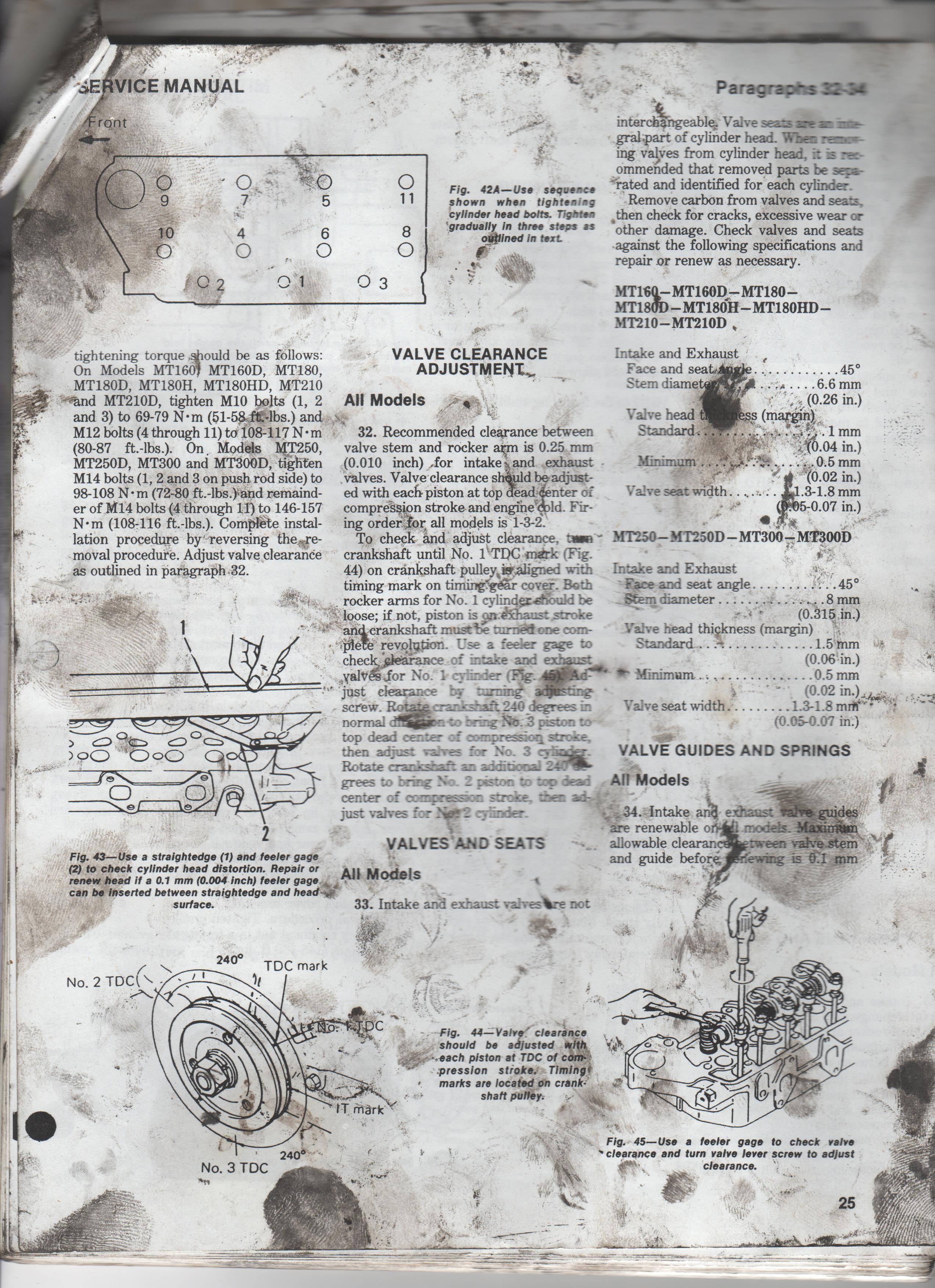

No leaks in the oil pan or the valve cover, but I got a few hydraulic leaks and the engine has a little knock to it. I think I did the valve adjustment wrong possibly. I adjusted cylinder #1 intake and exhaust valves at TDC for piston #1, and the same for piston #2. It starts easy off of 1 glowplug warming cycle when cold, but there seems to be more smoke that what I think there should. My friend was saying the valves might need to be adjusted differently than what I did, but Im not sure of the process and I still cant find my stupid manual. Could someone please, please, please post the valve adjustment procedure from their manual?
   / 77 Satoh Beaver S370D wont start, low compression #147
I wouldn't get too worried that something is wrong just yet. I have only owned two 2 cylinder tractors but both were loud and had that trademark 2 cylinder clanging, knocking sound. To me, the 3 and 4 cylinder engines are much quieter and smoother. As far as procedure, I attached a (well used) scan of my I&T manual, hopefully it is legible. The "procedure" will basically be the same for your 2 cylinder but the clearances may be different.

Thanks, that helps, but I have a KE70 motor so Im still not 100% sure. I adjusted the valves in this way so that makes me feel better. Im just a little worried about the knocking sound I hear and the excess smoke. Maybe thats just the way these engines sound?
I did notice that the K3s are adjusted to 0.01” clearance, maybe if I tighten mine up to that it will run quieter? Anyone ever try that?
